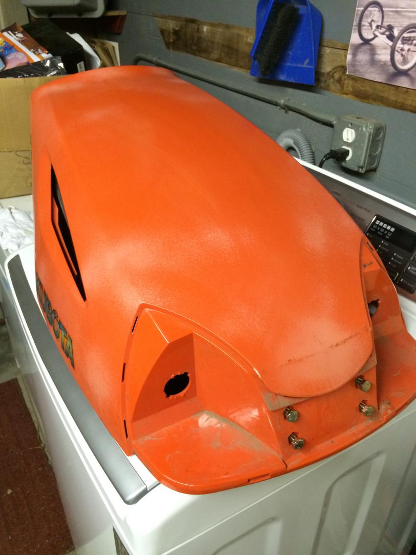

I guess everyone has their own measuring stick of what they want something to look like. From the picture it looks like a nice hood. When you put the headlights back in some of what shows in the picture won't be visible.
You will have a good sum in the repaint, or a result you wish you didn't have, you get to choose.
Might just clean it real good and cover it with Aerospace 303 protectant and be happy.
Good point! I kinda was even thinking about plasti-dip. Something that won't be permanent and if I don't like it I can just take it off.

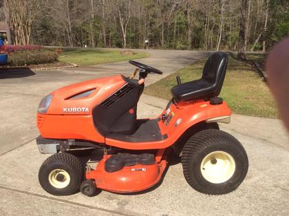

Here's a pic of the tractor...
The dealer is telling me its Kubota Bright Orange... I'm not sure what looks closer out of my 2 choices. I'm leaning towards just Kubota Orange. Does it look dark enough for the Kubota Orange II?
33,391
8,703
It's Kubota orange II , they quit using Kubota orange I somewhere in the late 80"s if I remember right. ;)

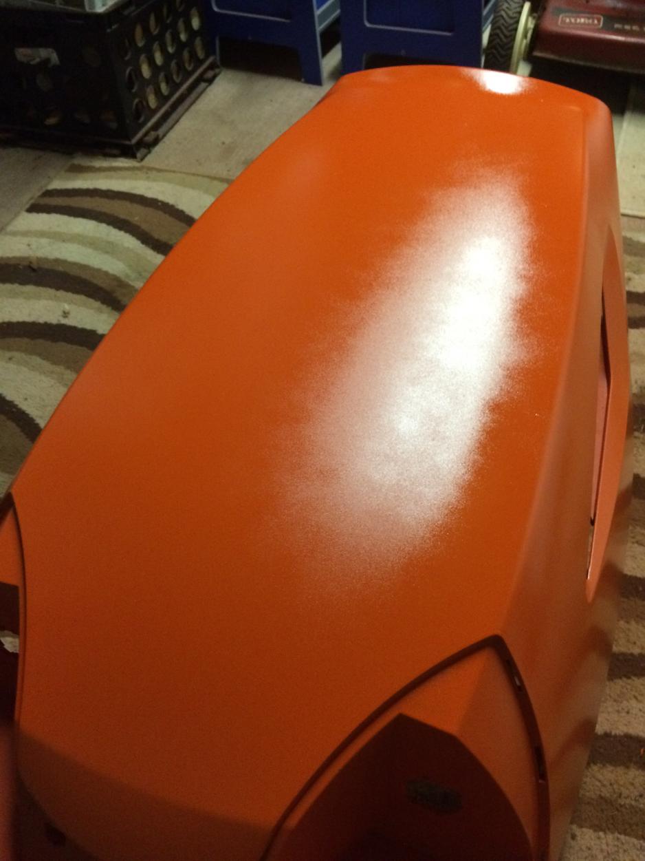

Well..... Picked up 2 cans of Kubota Orange II from the local dealer. Also found it recommended to prime with Plastic Adhesion Promoter. Seems to give some coverage and supposedly keep the paint from cracking. It allows it to flex without the paint being affected.
Have those 2 things with some 400 grit sanding blocks. We'll see how that goes. Pictures to follow tomorrow. I'm done at this point. Can't wait to see how it turns out! :)
AllThingsOrange
2008 Kubota T2080
Apr 25, 2016
46
Southeast, Texas
Take a look at this pic... Just after applying 3 coats of Plastic Adhesion Promoter following the directions.. And applying 3 coats of Kubota Orange II in the can by the directions... Now it looks like an orange peel. What could've gone wrong?
