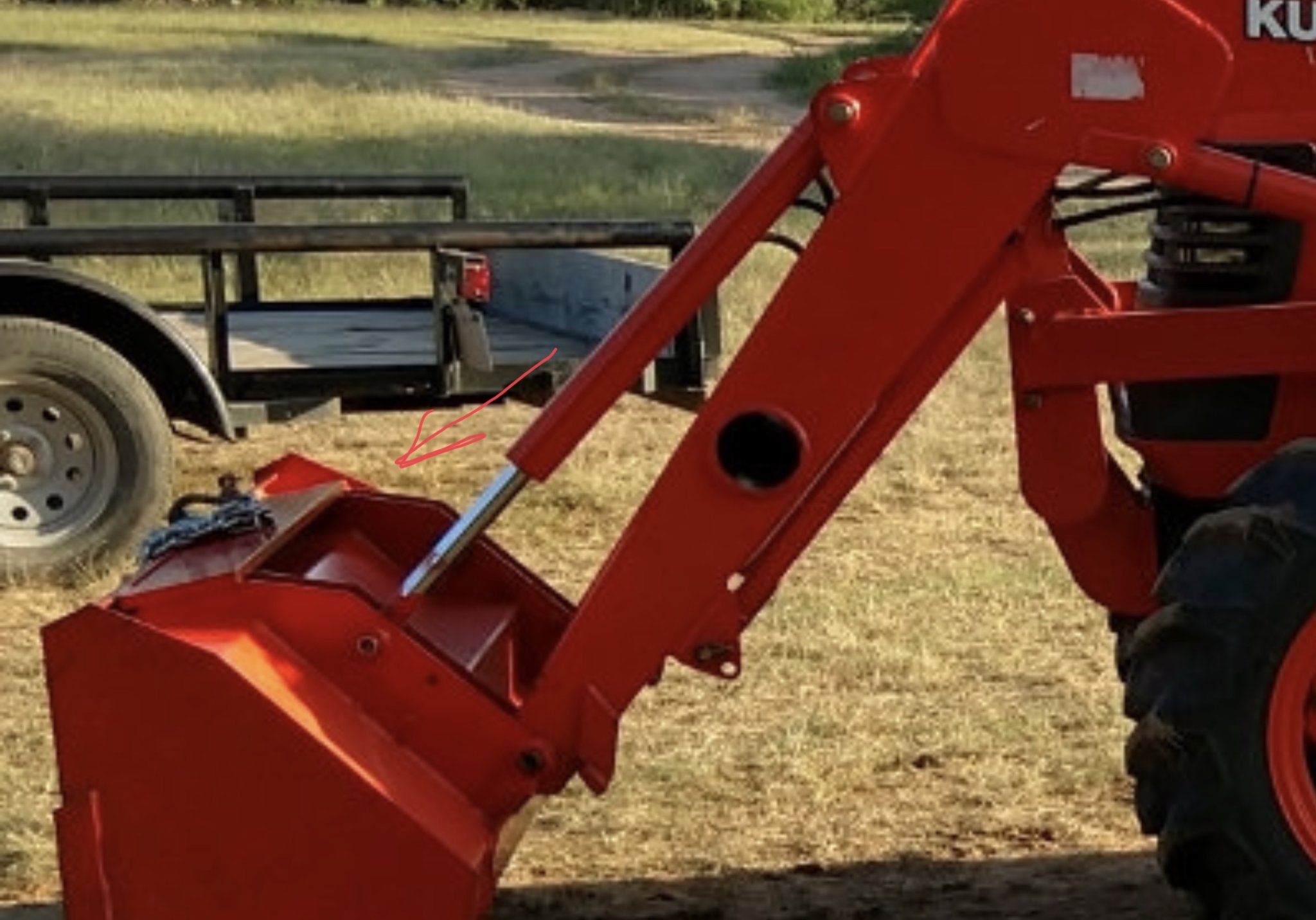

Add a hook, or better yet, a clevis to the Middle of your bucket. (In the pic below, this was existing when I bought my tractor…. I later added hooks in front of each cylinder. Pulling/lifting from the center clevis will not “tip” the tractor.
