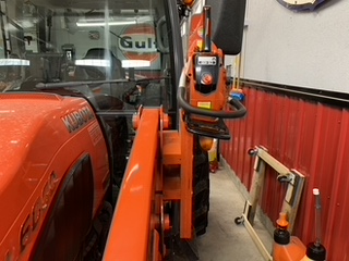

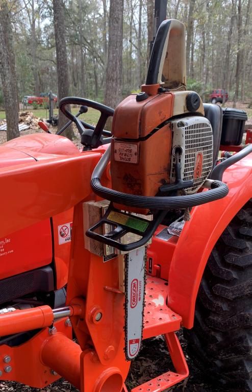

I too and wanting to build something for a chainsaw, thinking about a metal frame with 5 inch fire hose as a bar protector. But a improved bushguard and a canopy is first.

I have a suggestion.
Cover that chain. If one were to slip on the step and/or lose one's balance stepping off the tractor, the chain is right out there to catch any part of one's body on the way to the ground. With a design as shown, simply modify it to incorporate the manufacturer's bar cover in the design.
