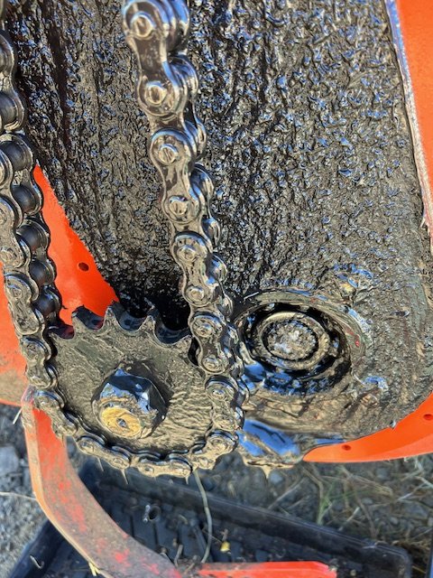

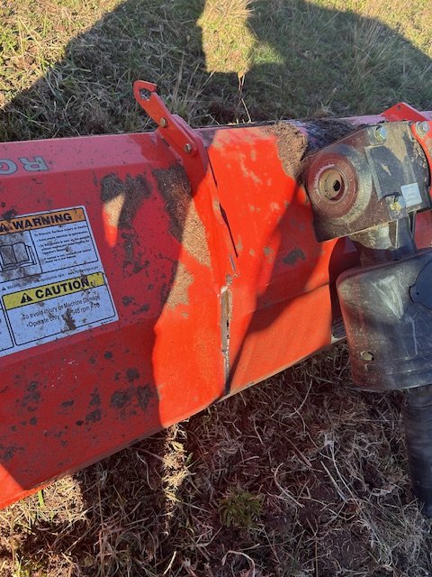

Thank you all for hte responses. I got the first tiller, the RGA1266 back Friday. I totally understsand the RGA1266 breaking the first time as it got caught up in the wire. I used it this weekend, nearly finished all my tilling when on the last fraction of an acre I heard a thud, turned around and saw half of the tiller on the ground. I put pictures of the piece left on the 3 pt hitch and the part on the ground below. Couple points on my use case: I used a stopwatch to time each of my passes this weekend, then used Google maps to estimate distance and MPH. I was averaging about 1.5MPH, which seems reasonable.

- The positioning for the RGA1266 is more around tilling Garden beds, so maybe can more understand the failure, but still does not seem that even with the vibration of tilling large clumps of dirt for 30 hours at 1.5miles/hour the joints should snap like that.
The positioning for the RTA2072 is that it can be used on small commercial farms, it failed after about 7 hours of what the RGA1266 was able to at least do for ~30 hours.

None of the farmers around here use rototiller on their acreage(8-50 acre bits ).Plows, culitvators and rolling baskets is what they use. Seriously you're destroying the tiller from abuse. 'Tiller's are 'finishing' implements NOT for turning pastures into veggie gardens.
The break of that shaft could be due to the PTO shear pin / clutch not adjusted correctly according to the manual.
