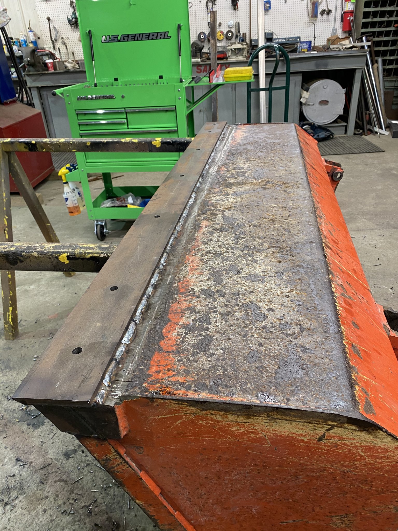

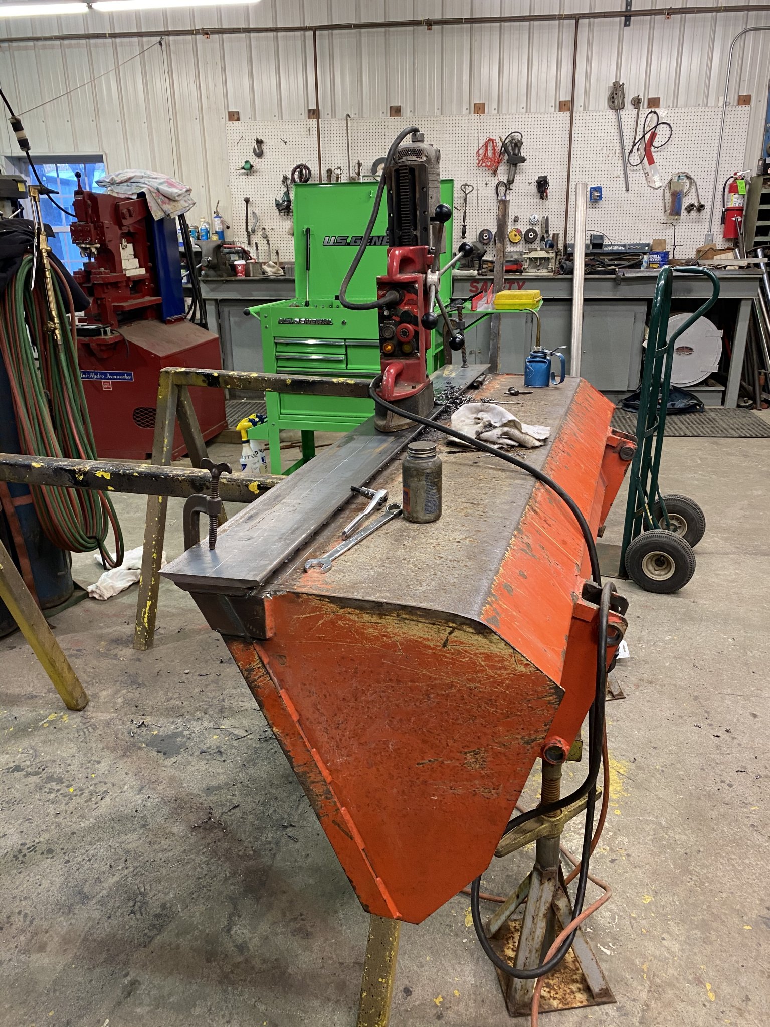

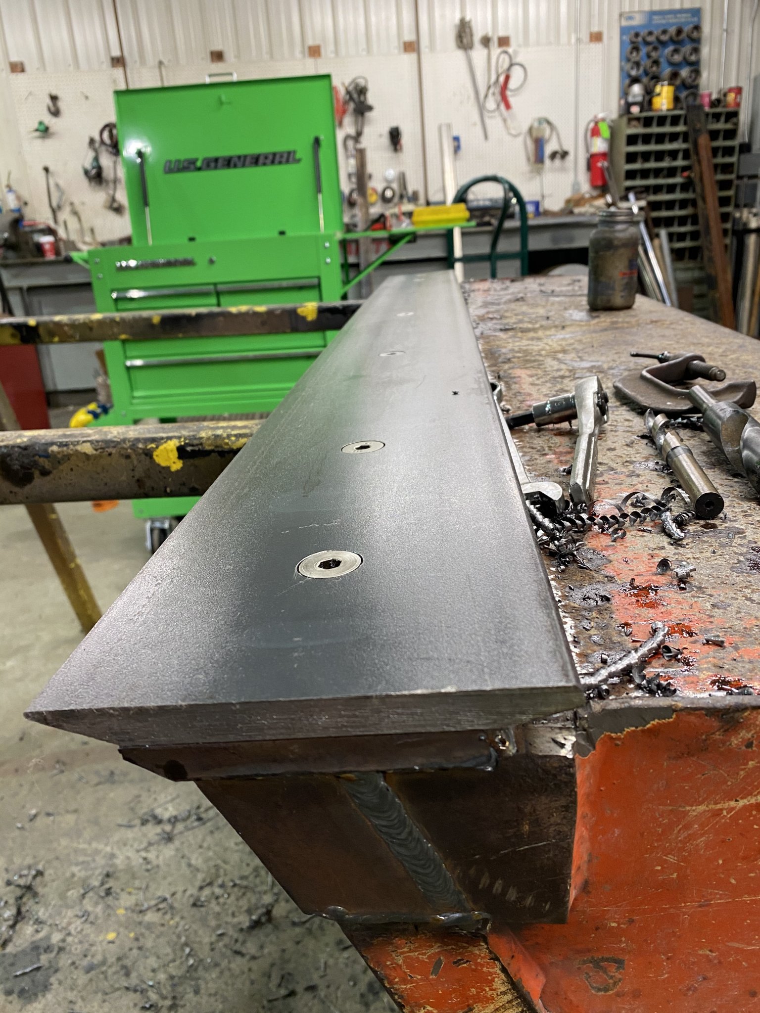

Boss brought in his badly worn Kubota bucket from plowing his whole neighborhood when it snows lol. I’m not sure why i didnt Take a before picture. But it was worn all the way back to the welds. And the sides were worn off too from rubbing down curbs. I hand Beveled a new cutting edge and welded it in there just as asked. Also built new cutting edges. And when it was done he asked me to drill and put on another cutting edge lol. He can plow highways now for a few years straight

How do you bevel the edges?

as for the bevel, the welded one is hand grinded. They do make a tool though, just don’t own one. The bottom bolt on edge came beveled.

I want that mag drill and I see you have discovered the value in US General boxes.!!!

That’s an old school Milwaukee mag. She still runs like a top! Just sucks when she’s hanging and the breaker trips 😂

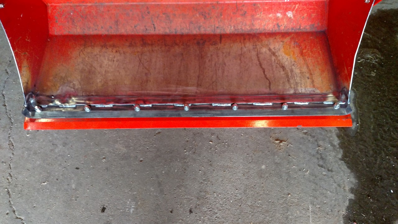

I had the welded cutting edge on my BX replaced a while back, but before I took it to the shop to be installed, I bought a 48" bolt-on edge for a later BX(?) and drilled the weld on edge so it could be bolted on like you did. Mine isn't reversable, though I suppose I could grind a new edge on it if I have to turn it around.
Very nice! That’s all ya need right there

Question on the bolt-on mounting. Looks like on the bottom you are using something with an hex in it, which is recessed, while on the top it looks like bolt heads.
What is that? Bolt going in from the top, and some kind of recessed, closed part on the bottom that mimics what nut does? Or just things ground off on top which look like bolt heads?

thanks man! Yeah they are just countersunk Allen heads, with a nut on them inside the bucket. I cut Them flush and ground them off. I made the countersink with a bit the size of the bolt head.
