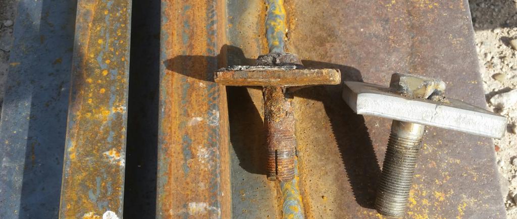

First thing I did was drop the wear blade held on with eight 5/8 inch plow bolts. Most of those snapped off or I had to cut them off.

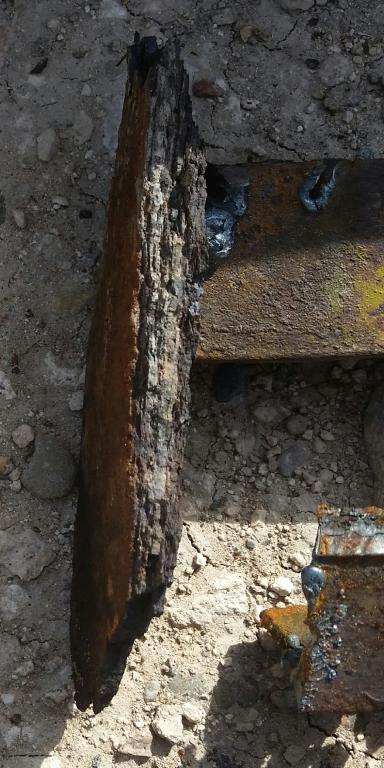

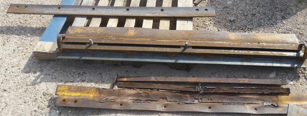

The backing for the wear blade was warped from rust exfoliation and had holes rusted in it where it contacted the backing. So I cut that off with my plasma cutter and replaced the rusted 1/4 inch stamped backing with 3/8 thick 8 inch wide hot rolled. Welded the old 1/4 inch top to the 3/8 new backing with 5/32 Excalibur rod at 160 amps on the front and old 3/16 inch 7024 "jet rod" at 300 amps for the back.
There were some horizontal 1.5x3/16 angle iron guides that allow the blade to stick out more to the left or right. These ran across about 3/4 the width of The blade. It was also rusty. Cut those off, replaced with 1.5x1/4 angle as wide as the blade.

I will get the old rusted blade bits and get some pictures up this weekend.
All the new metal only cost me about $74. New hardware was about $40, for 8 plow bolts and some 3/4 inch fine thread bolts for the adjustable elevation, had some of the nuts and washers in my junk collection.
