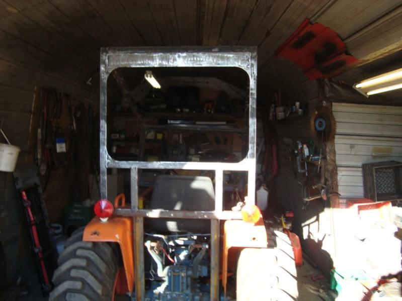

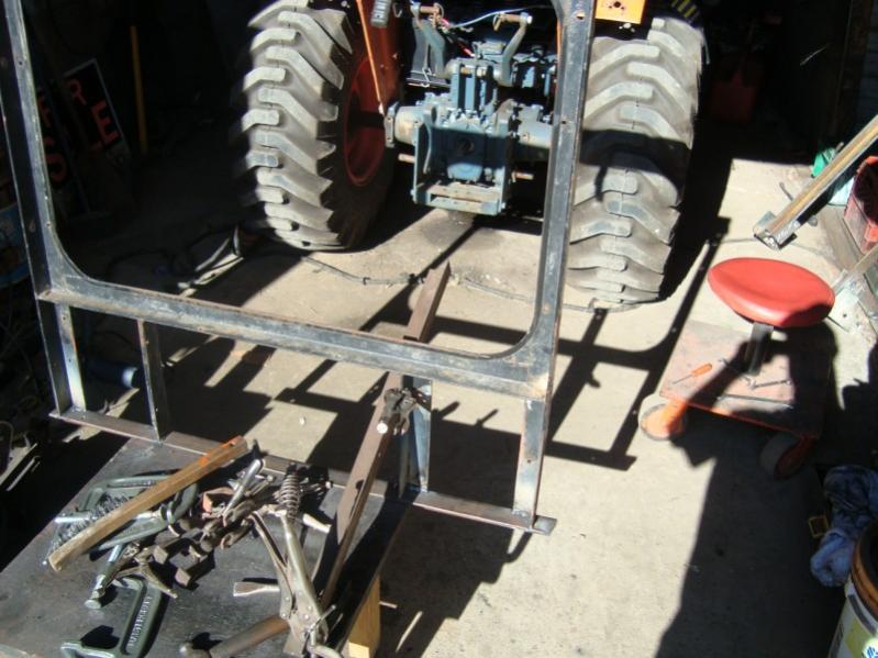

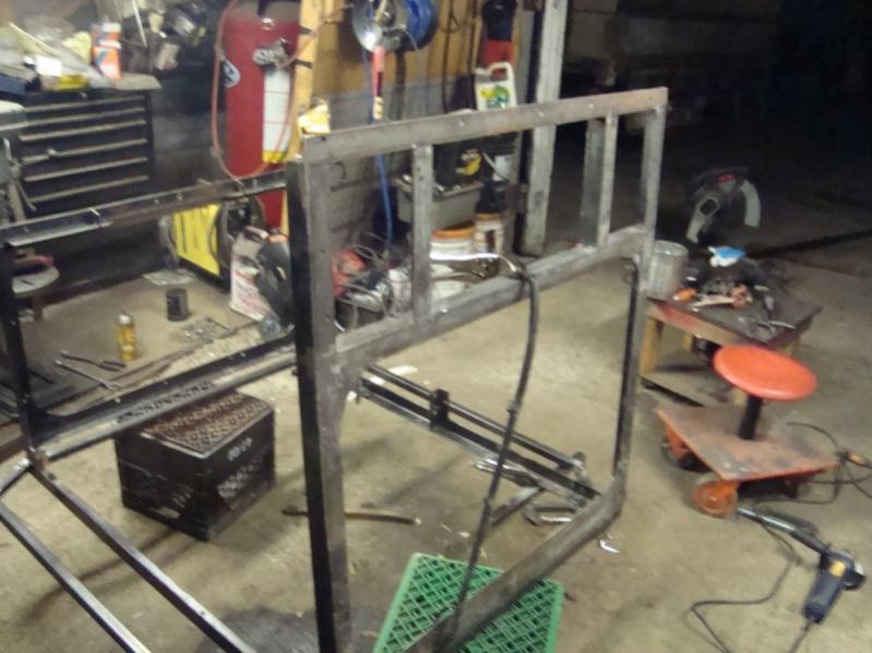

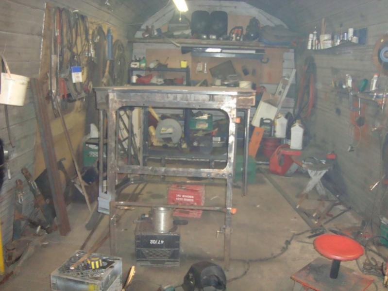

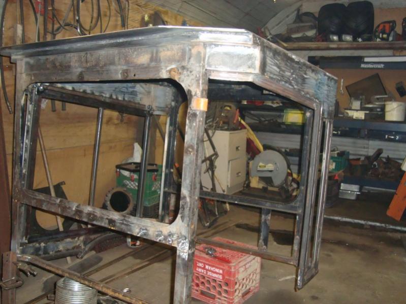

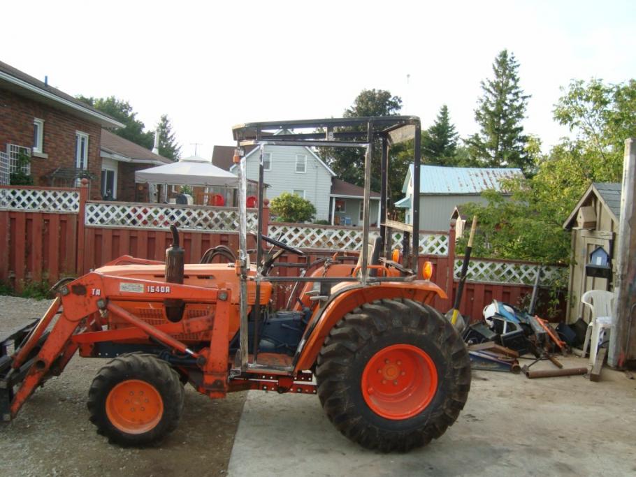

I am finally getting to work on my B8200. There is a lot more than the cab to be done on this tractor, like a hydro leak where the hydrostat unit was cracked and fixed ,, kindof fixed. I'm hoping jb weld will do the trick. It also needs all kinds of cosmetic work. But!!!! I know how long it takes me to do things and I am not going another winter with no cab, Any way here is a few pics of what I have done so far. I reduced the length by 3 inches and lowered the wind shield 3 inches and am making the cab 10 inches wider.

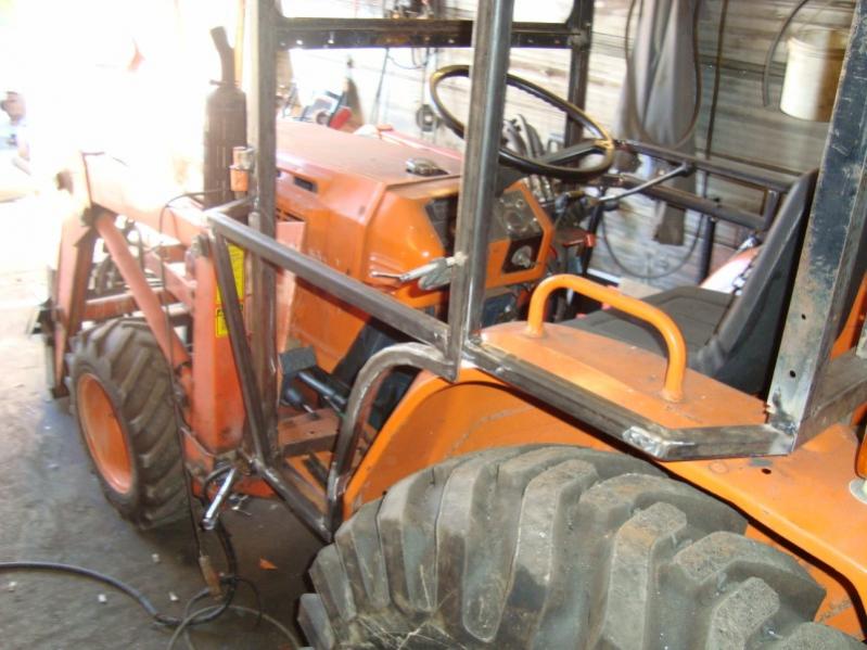

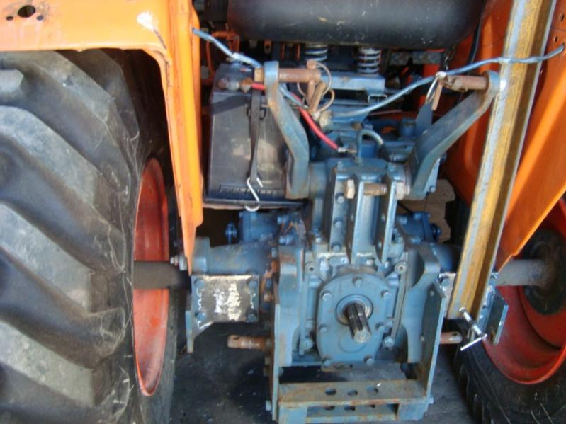

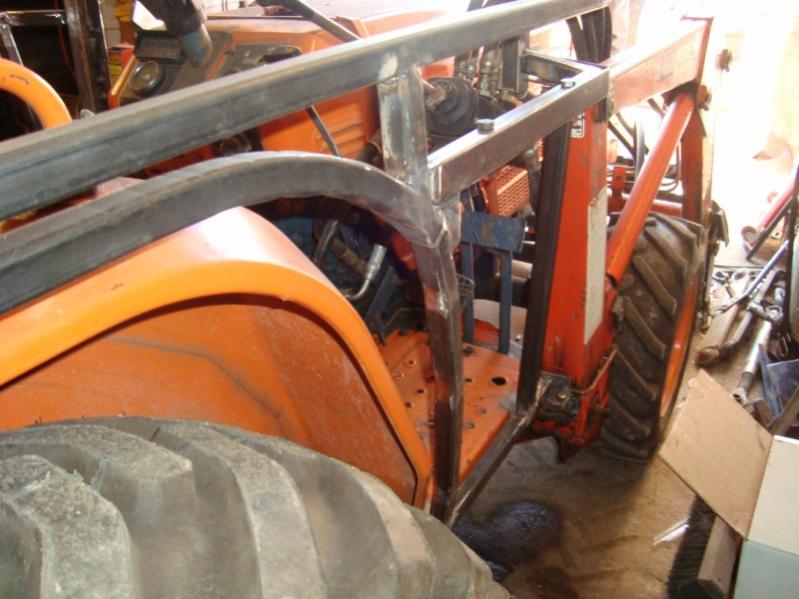

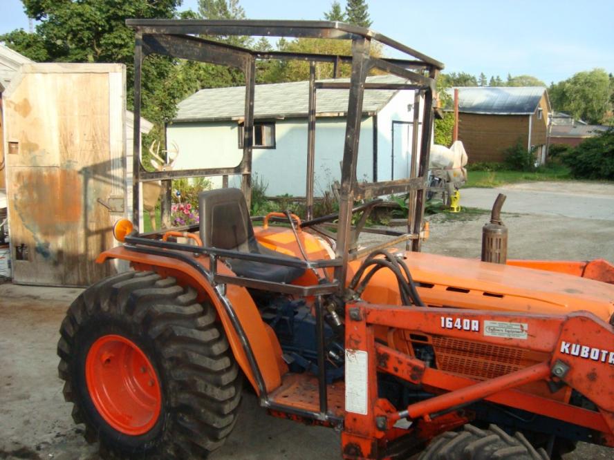

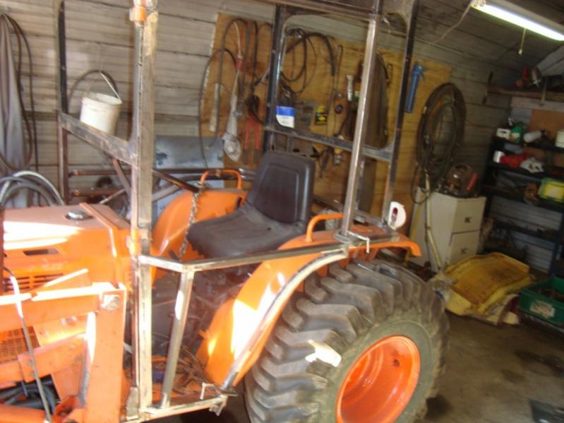

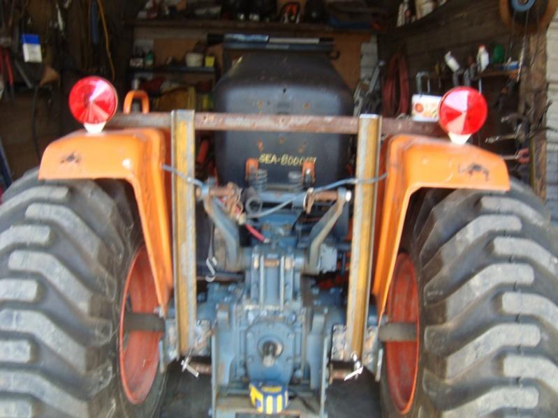

Couple more. Yes I now know it would have been easier to build it from scratch:eek:
Dusty my curiosity is killing me are you welding that mild steel angle to a cast steel axle housing? What electrode are you using.... this is killing me I have to know Mr "T". :)

Hey Ob1. I would like to say yes just to be a smartass. But no there is a bracket that bolts to the back and sides of the axle. It had the centering chains for the tph and a really poor example of a rops attached to it. You wouldn't catch me welding cast steel. bin there done that. WOW just the thoughts of welding to that axle gives me the willies. Boy would that be expensive.:D
:):):) me too thats why I had to ask because I've played around with Aufhauser as "Cast Iron Rod" and it ended cracking out even with drilling and preheat. and grinding off stress risers. I have trouble seeing without cheaters anymore and use auto darking hood to save the old neck joints. I hope you make a weldor out of that son-in-law of yours :D you sure take good care of him. ;)

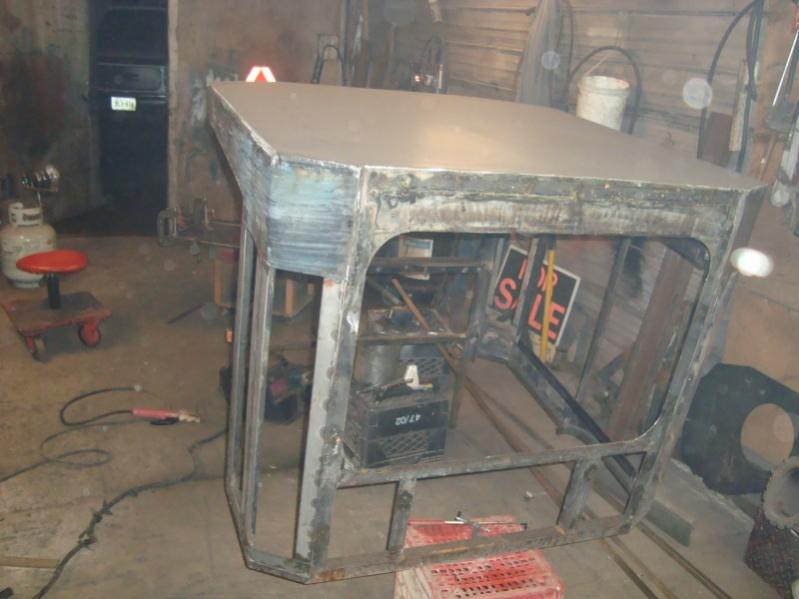

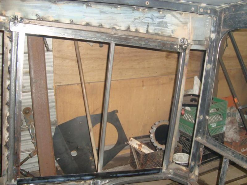

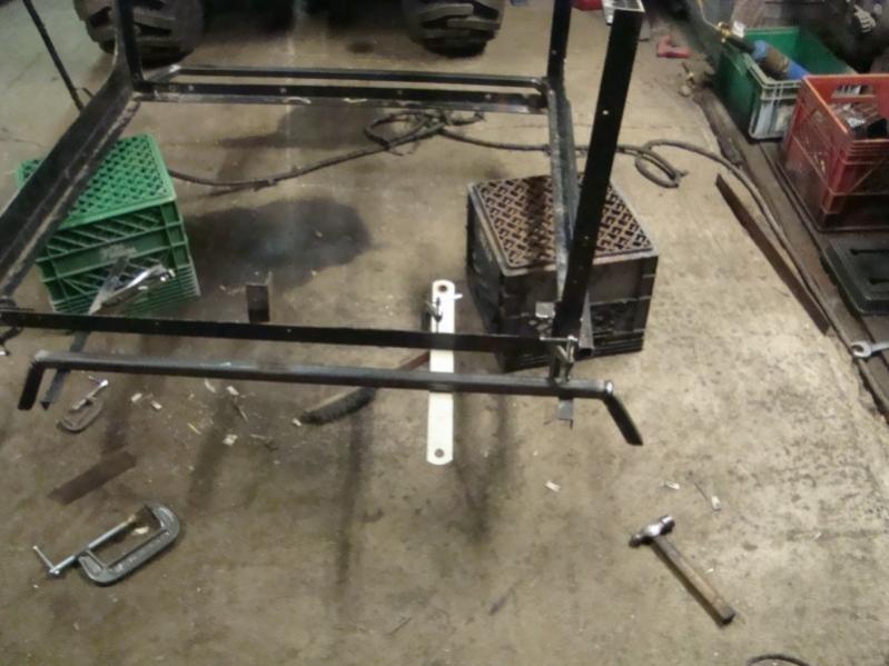

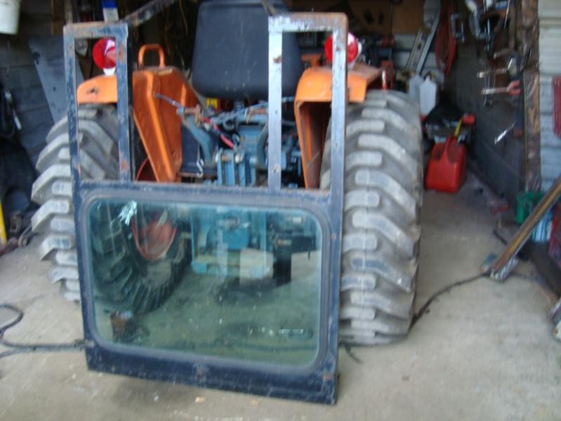

Took some pics, The door is hung and the door jam is done. The cab splits just about seat level and I will have to lift the top about 6 inches and drive out from under it. I am going to put hangers in the leanto at the back of the shop. Drive the tractor out from under it. Then I have to rig something so I can lift it easily with the loader and put it away for the summer. I will probably only get the cab done this year but I can alway's dream.:D

I hope not to see snow till december but we will take what comes. Had frost last week though. I'm just using a stick welder, I have a 220 mig , no gas , I don,t like it and it does't like me. The cab is 46 inches wide , about 6 in narrower than the tires. :)

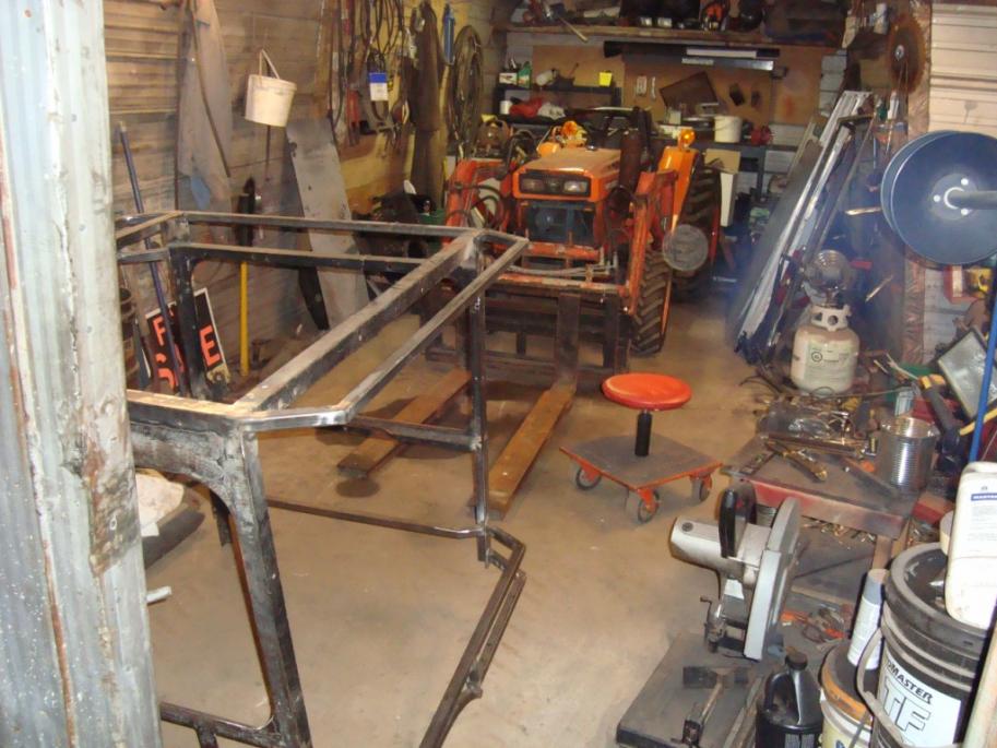

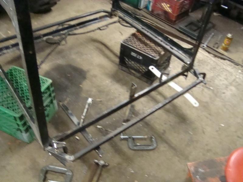

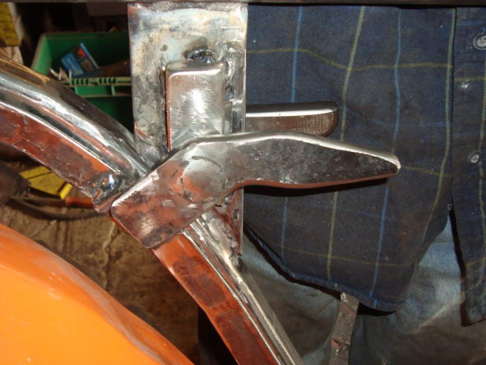

The cup holder is a must , may even put in a porta potti if I can find room. But if the cab is warm enough maybe I can blow snow in my tshirt. No having to peel off 14 layers to go to the can.A few more pics. home made door latch and a few more things done. The cab is off the tractor so I can finish welding every thing I have done so far. 4ft forks worked great for moving the cab. I used a 1 inch rope over a joist in the lean at the back of the shop and used the steiner to pull it up. turned the Kubota around put on the forks and backed the tractor and cab into the shop.:D

I was wondering how you were going to get in and out and now I see. WHAT a cool handle. You better start priming and painting before cold weather sets in up there. Its in the low 50s here tonight in Alabama :cool:

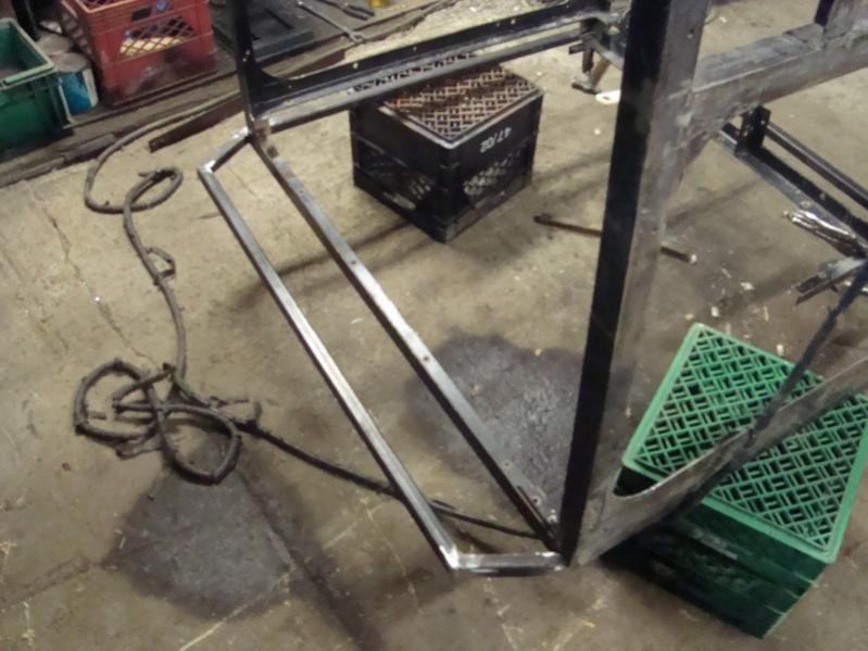

Ob1, low 40s here tonight I had better keep hammering on his thing. I am putting 10 guage sheet steel on the roof and what ever is going to be covered on the sides. Most of the sides will be windows. The front and back are glass but I think I am going to have to cheap out on the sides. At least untill the cash situation improves. But I am putting frames in that will take glass when I can afford it. Joekim I know the cab looks half decent in the pictures , but pictures lie. Yes it will be strong but chances are it won't be pretty. One thing is for sure, it will be kubota orange. To lift the cab off I just threw a rope over a beam in my storage shed , hooked the rope to all 4 corners of the cab and pulled it up with my steiner 4wheel drive. Once the cab was clear I drove the tractor out from under it. Then I could use the the loader on the kubota to move the cab where I wanted it.:D P.S thanks for the comments it helps keep a guy going.

Well Guys its bin a while since I posted any progress on the cab. And there is progress. Still lots to do, The roof is on and sheet metal is almost done . What little there is of it. I am making a sliding window for the right side of the cab. Two days on it so far. Anyway here are a few more pics.:D
