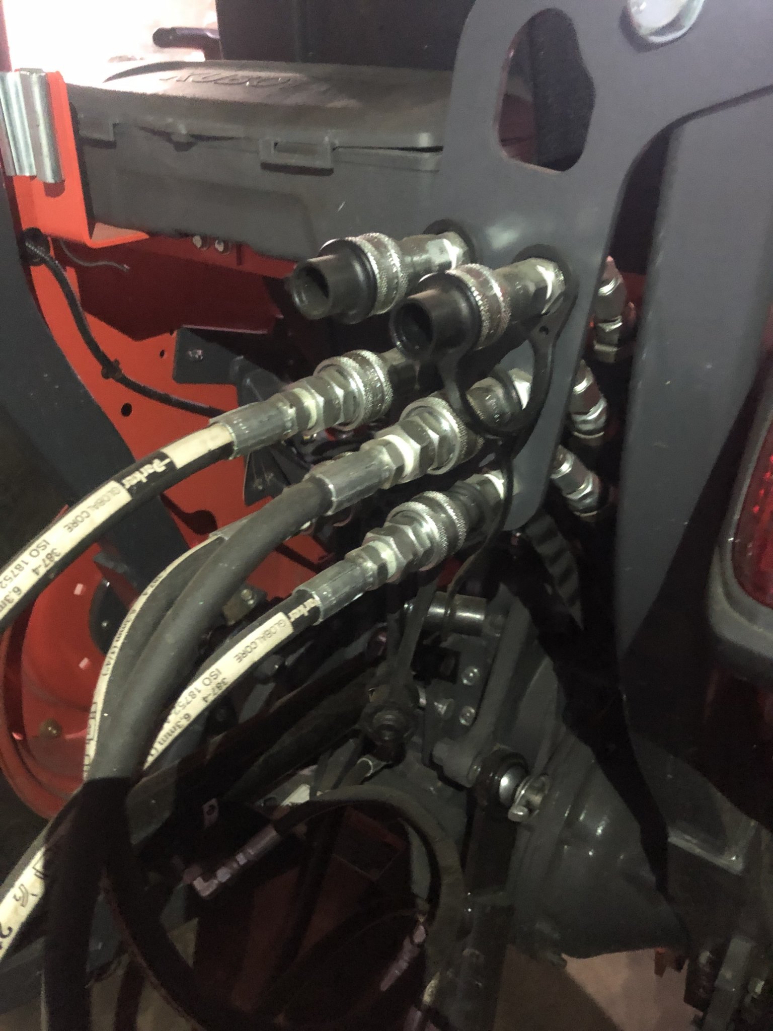

I prefer double acting female couplers on the tractor and male tips on the implement hoses.
Pretty! You add a trailer 7 pin, and you would be golden! I toyed with the idea of installing a to tank port. Don't have a use yet, but I could see the need in the future.

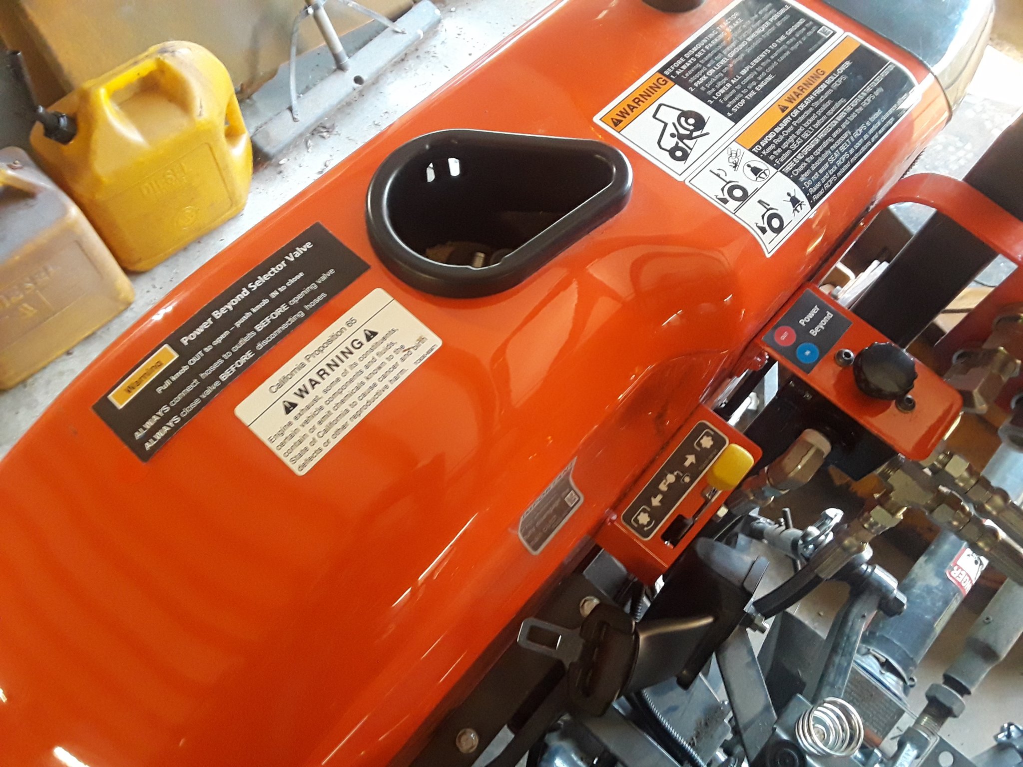

My B7200 has a tank return outlet on the rear. It was used with my 3pt log splitter which I powered with a constant flow outlet (OEM) on the 3pt cylinder cap.
The left most outlets that I installed on the L3901 are setup as constant flow OUT/IN similar to the way Kubota plumbs the BH77. However they are switched by a selector valve - behind the PTO lever in this picture. They are only hot when the splitter or some other implement is connected so there is no need to loop them when it is removed.
