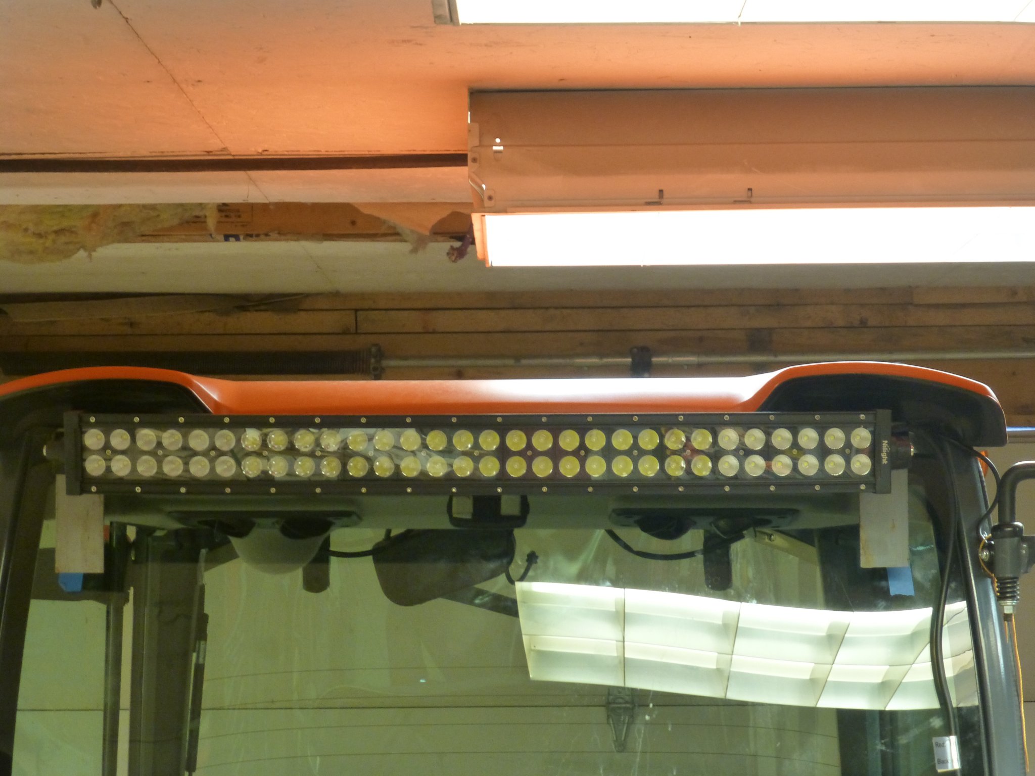

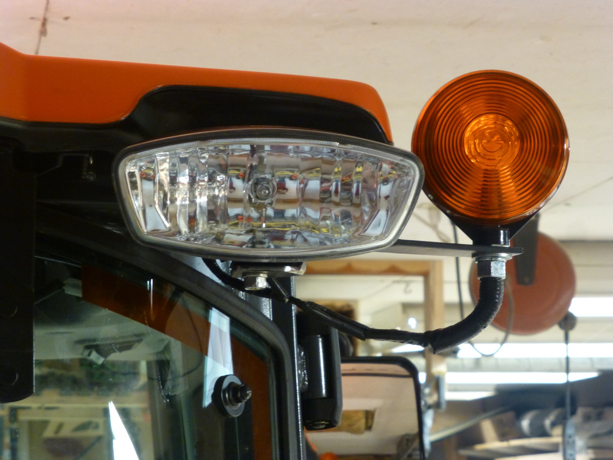

I took the OEM front lights and put them on the back, then added an LED light bar to the front. Installed the light bar with new harness. Rears just plugged in the the existing rear harness. Had to make front and rear mounts for the lights. But had everything done in a couple days. More than enough light in the front, and only use the rears when backing into the garage in the winter when I have the front snowblower on. Wiring harness for the front had a switch included, used the front switch on the rear circuit, already wired in, and it was done. All in for less than $100.00

@DeepWoods Great idea. I just ordered the rear light kit. Wanted to keep it close to factory because it's a new tractor.
But those LED light bars put out some serious light!
Used to be a Jeep Club guy and those guys would put on those light bars and turn the wilderness into daylight. I hated them because they blinded everyone else! Lol. Now that I'm living in the forest one of those would be perfect.
Thanks for the idea. It looks great too. Nice job.
Do you get any glare off of the hood?
