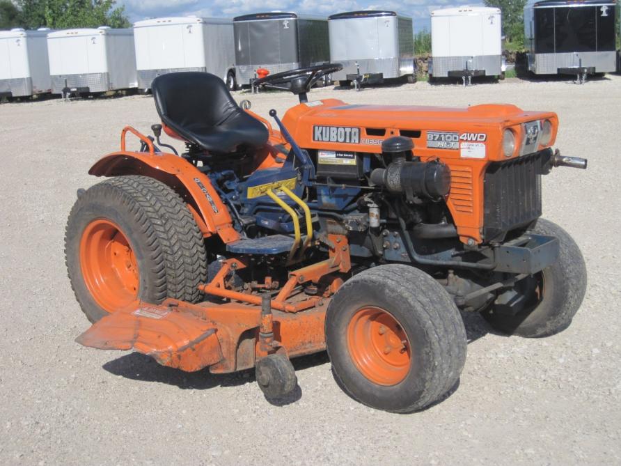

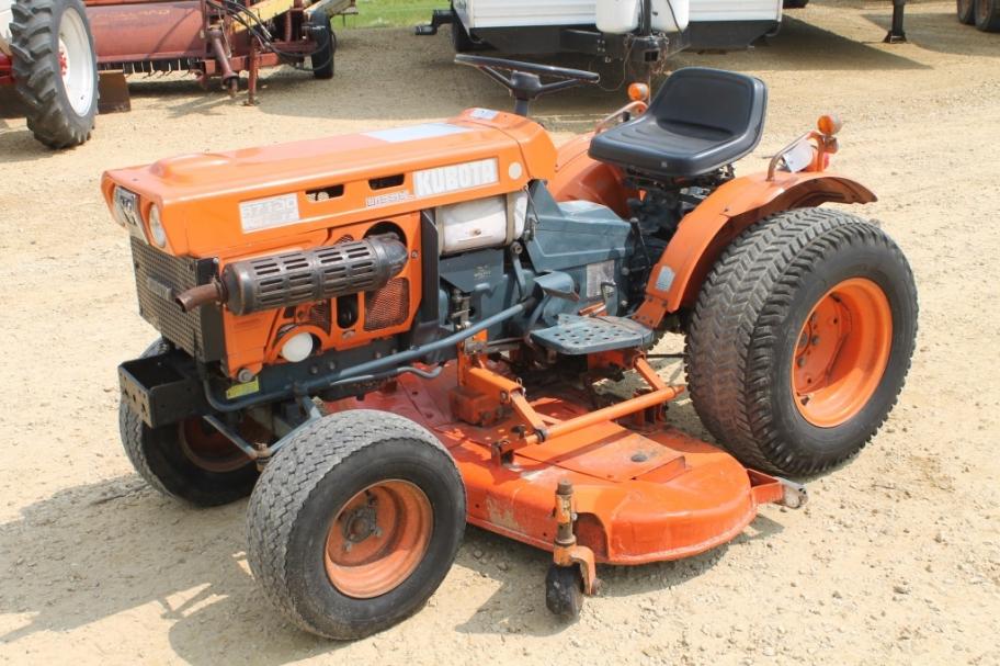

hey all..
got some good guys here helping me learn the new toy.. but im stumped on this RC60 deck. think there are some pieces missing.
grabbed some pix.. can you pro's tell me what is what here?
thanks!

I have an RC54-71B, with the manual that covers both the RC54-71B and the RC60-71B. They don't look like your mower. I think the -71B part is important when determining which mower fits which machine. Do you have any numbers after the "RC60"?

a friend on our gun board saw my pix & said im for sure missing some brackets & he gave me these 2 pix to work with....
so ok ... know for sure im missing stuff.. wonder what else is missing besides those 2 front brackets?

Well to start with, that's the wrong mower for that tractor, will it work???? :confused:
That should have had a RC60-72H, makes it a lot easier to mount it up if it's the right mower to start with. ;)
Now go to kubota.com and open Illustrated Parts List for both the RC60-72H and the RC60-92H and start comparing brakets, and note braket Part #'s.
Now just because it has the same brackets it still might not line up due to the deck being different, but maybe you'll get lucky and get it to work. :cool:
That was exactly my thought -- I d/l a chart dated 2003 showing which mowers go with which tractors. The -72H is supposedly the correct mower for the B7100. The -92H is not listed on that chart but Google revealed it's for a B9200.
However, the photos SDK1968 posted are clearly of a -92 mounted on a B7100. Maybe Kubota came up with a B7100 mounting kit because the -72H was discontinued?
The mounting is completely different. I'll take some photos of mine tomorrow when it's light out.

awesome pix & info!
i appr'd this very much.
YES this is WAY different than what ive got or got hanging there.
no front brackets or mounts at all, but i do have the rear rods & stuff...
was thinking it sure didnt look like it had much room to move under there & NO my place is not flat at all.
this pretty much convinces me to stick with my Hustler HD for mowing the yard & use this for snowblowing & hogging as originally planned.
oh: it also has become pretty clear on inspection that the person who had this tractor did quite a bit of welding on the case & mounting plate areas of this tractor.. might have been to get that deck to fit with the missing pieces..
so looks like im gonna just sell this deck or trade it on a hog.
wonder who would want a RC60-92H deck... lmao will post it in the classifieds.
