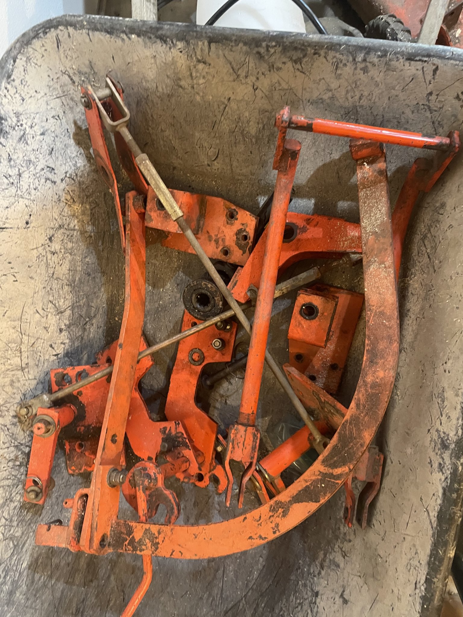

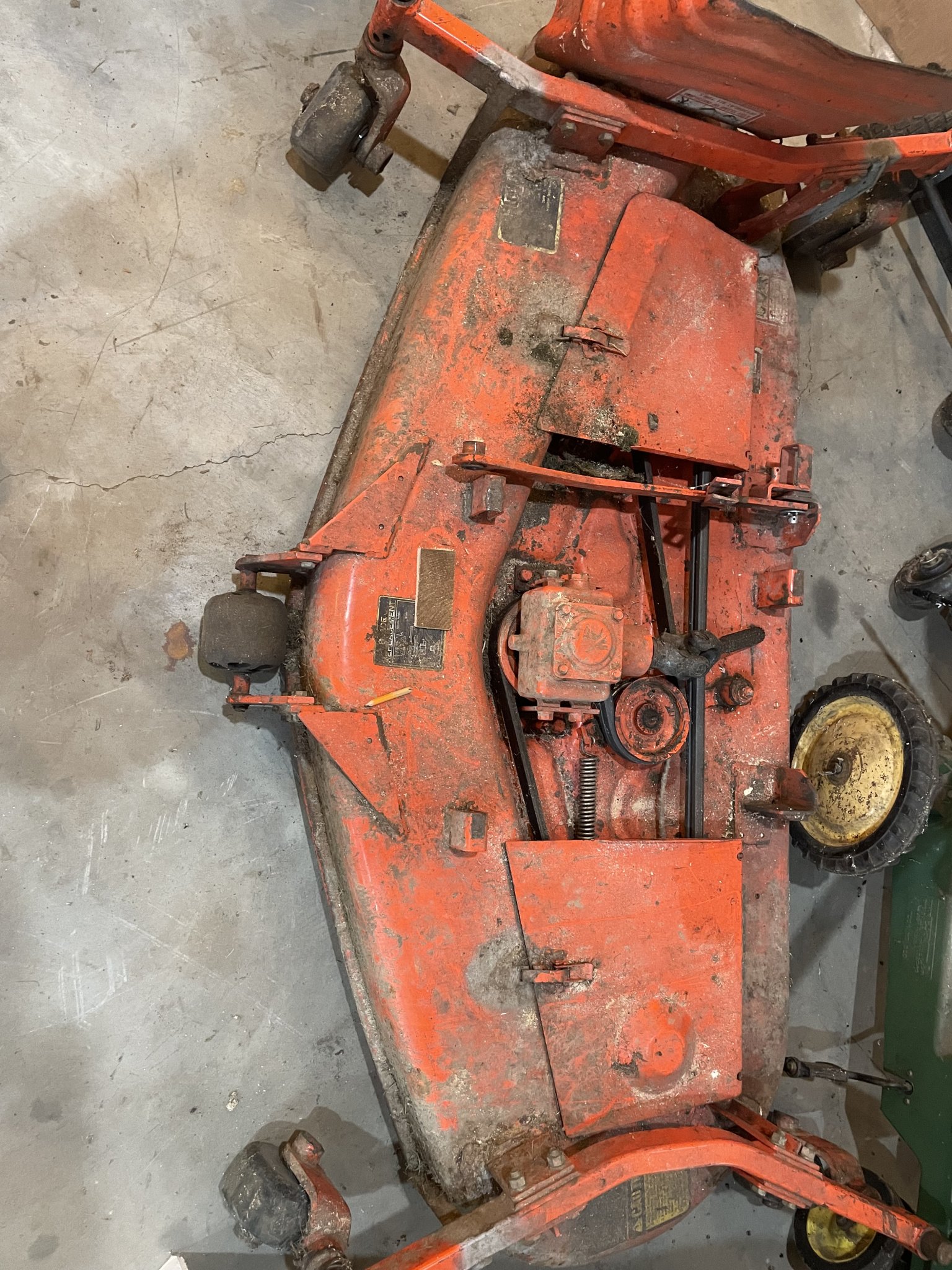

Have a mower deck RC60-B off a B7200 with all mounting brackets for sale! Had a small rust spot welded over on one side off deck! Gear boxes and spindles are all good! Been using it right along! Been stored in my pole barn! Asking $400.00 for the complete setup!

You can tell by the layout of the PTO shaft off the gear case (in his pictures) that its a Mid PTO model (RC60-B) and not a front PTO model (RC60-72).
You can not add a Mid PTO to a B7200D tractor, you would need a B7200HSTD to have the mid PTO availability.

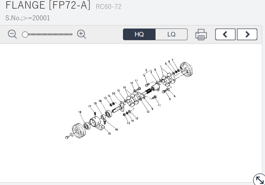

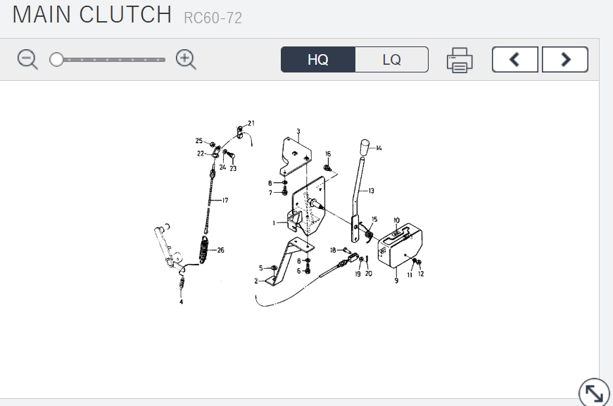

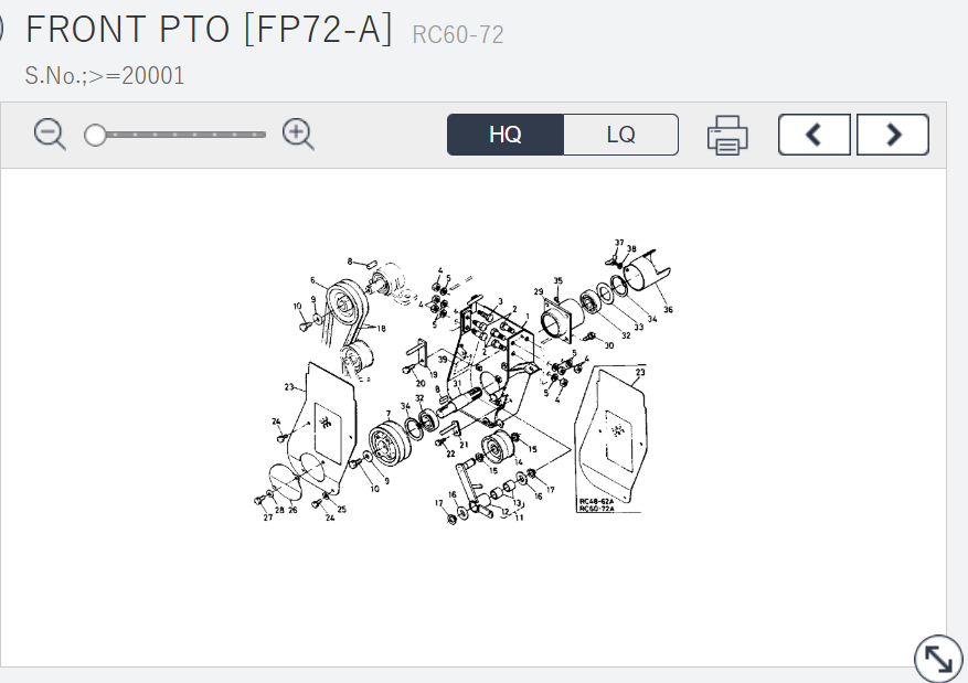

In addition to a front PTO deck you would need the front PTO drive which is rare and hard to find a complete setup:
Below are three sets of parts needed to makeup the front PTO drive.
