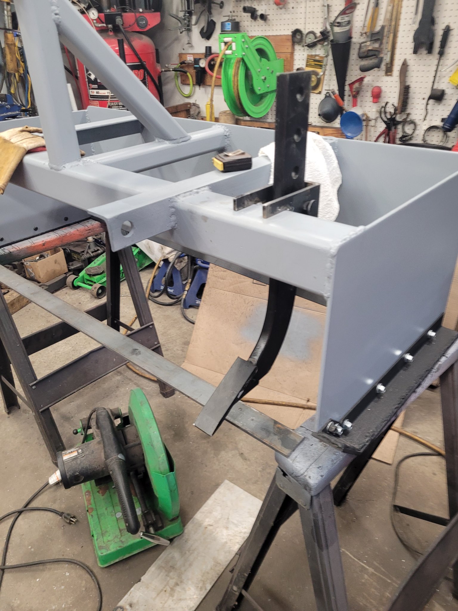

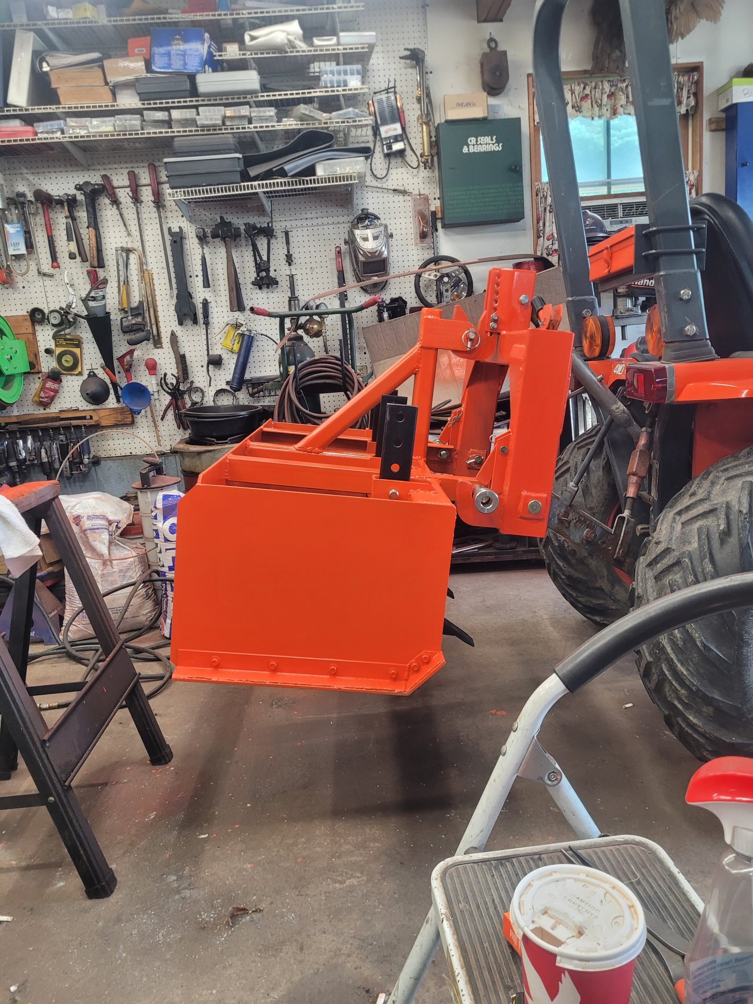

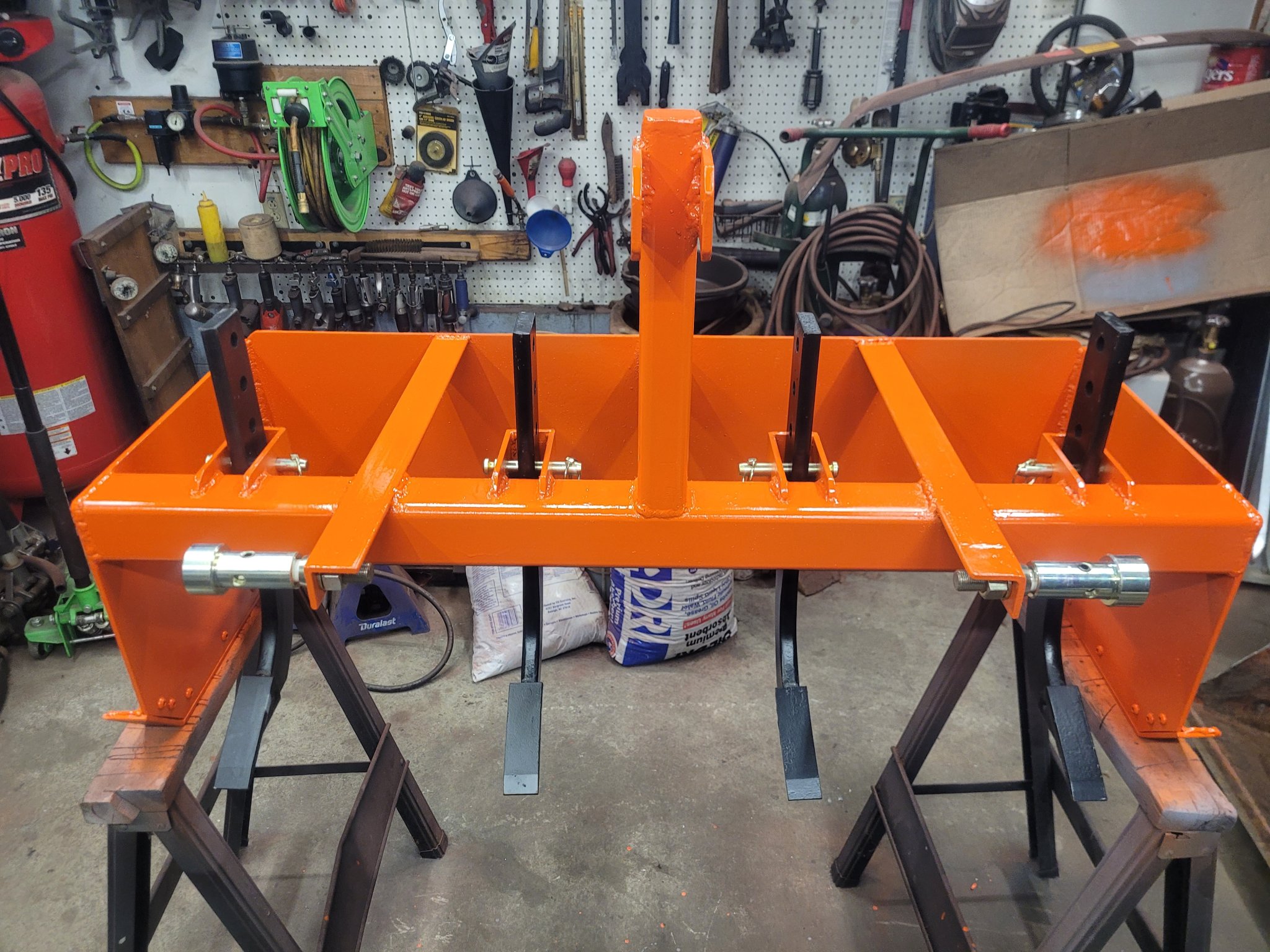

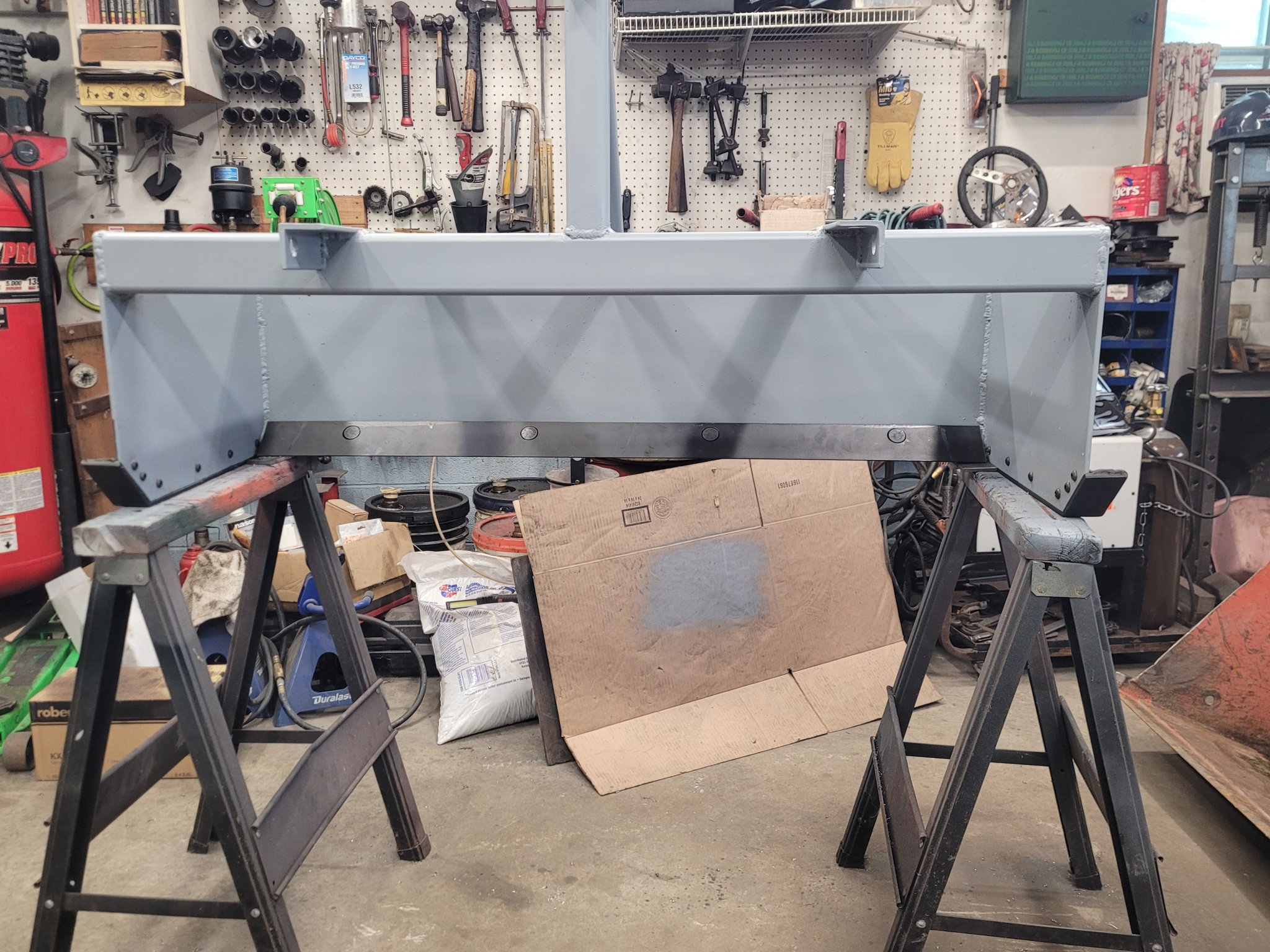

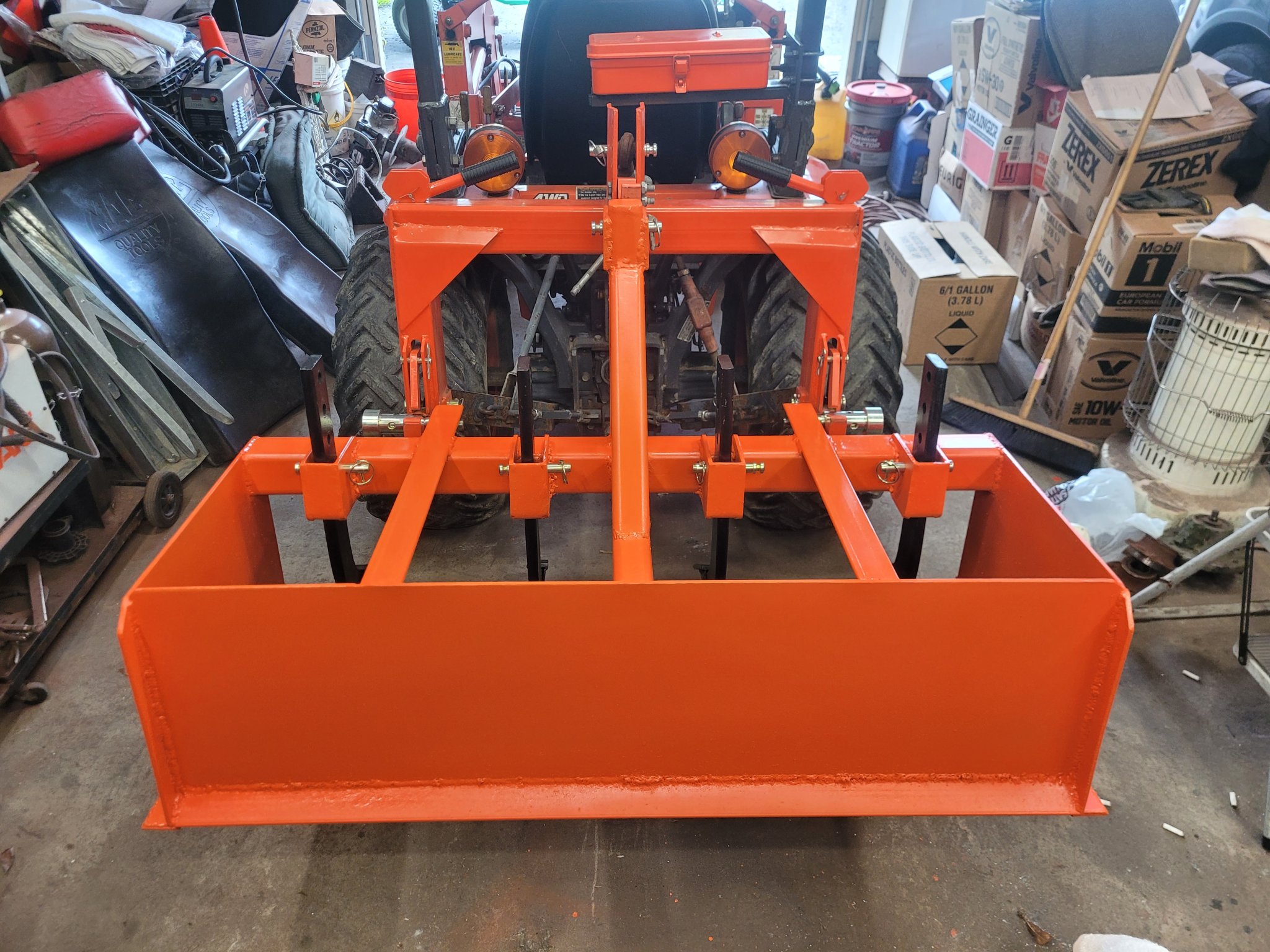

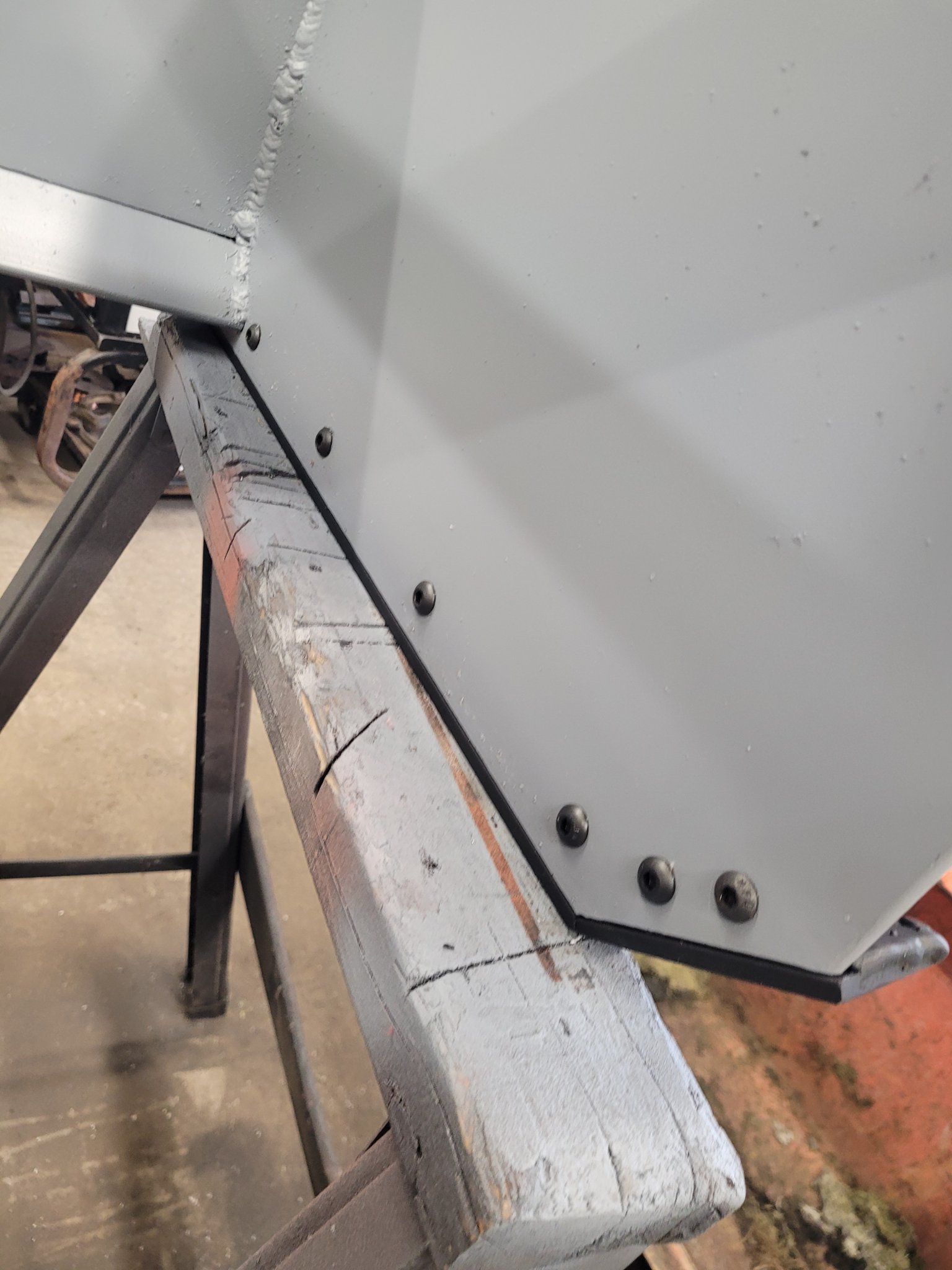

Last couple rainy weekends got me bored. Removable skis in case they wear out, attached with button head bolts so dirt doesn't build up. Cutter blade from king cutter and rippers from tractor supply.
With those parts, steel,epoxy primer and kubota paint; little over 1k in it.

Very nice work.
One thing that came to mind is, I don’t think my box blade has skid shoes on it (removable skis). My guess is that you may find that the shoes interfere with normal box blade operation.
What I think might happen is that when you tilt the blade to make it cut more aggressively, the shoes (skis) will cause the blade to lift up off the ground, so that it tends not to want to dig in much…

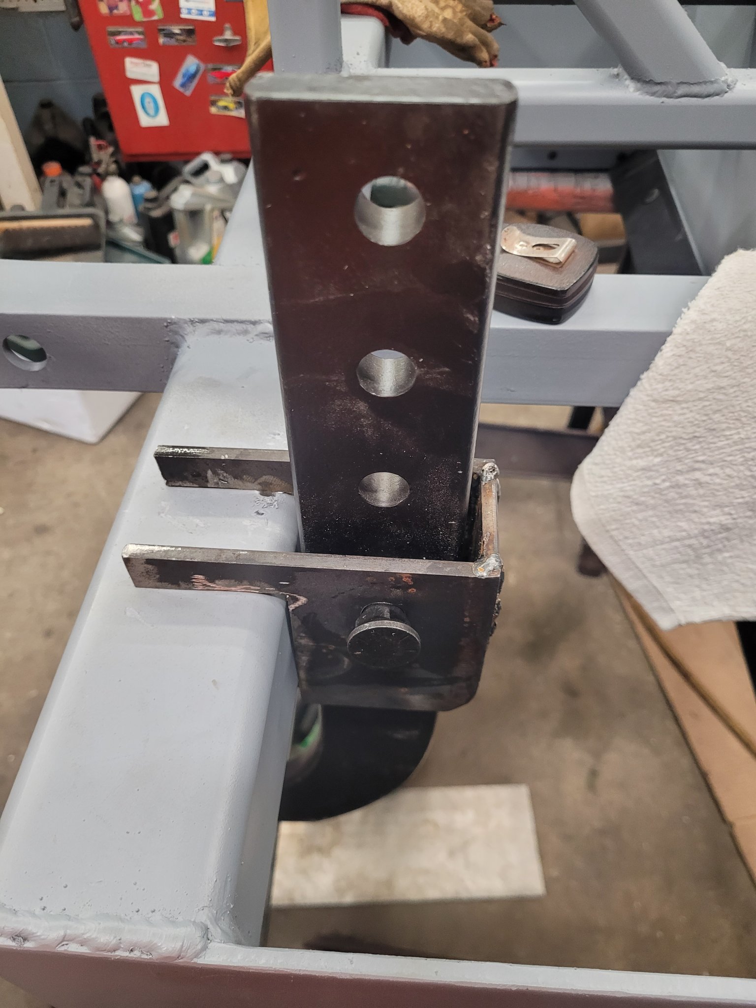

Very nice work sir!
I really like your "scarifier height adjustment", very stout looking and easy to adjust.
The replaceable skids was a great idea as well. 🍸 (y)

Thanks. I was assuming you would chime in eventually. And please no sir. I work for a living. 😁
