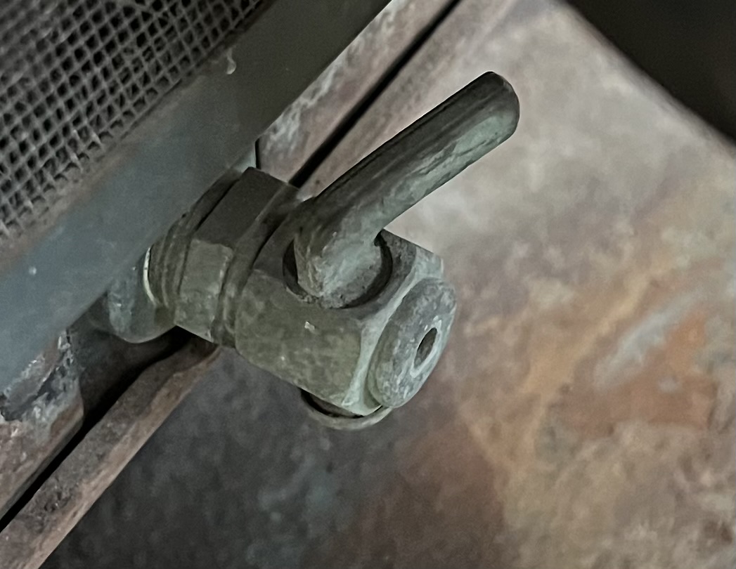

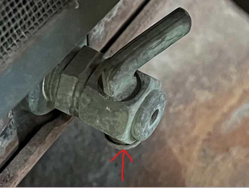

Tap up on the bottom while trying to turn it, if it doesn't turn, Unscrew it from the radiator.
or as @PoTreeBoy said remove the lower radiator hose to drain it.
