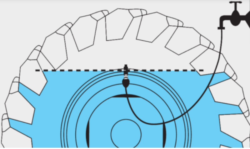

Air the fronts up to max, for loader work. I wouldn’t remove the ballast completely, just so it’s 75% or so. These tractors are light in the rear. I have tire ballast, 3 sets of weights and usually a 700+ lb box blade or a 990 lb tiller and can lift the rear at will.
This shows the 75% ballast fill, the rest is air, for the cushion factor.
The local dealer filled my MX6000 and M6060 rear tires with beet juice and I can check the tire pressure with the valve at 12 o'clock without any liquid coming out so I'm confident that my tires aren't overfilled, but on asphalt I can definitely feel a vibration. It's just part of the ownership experience with these tires.
