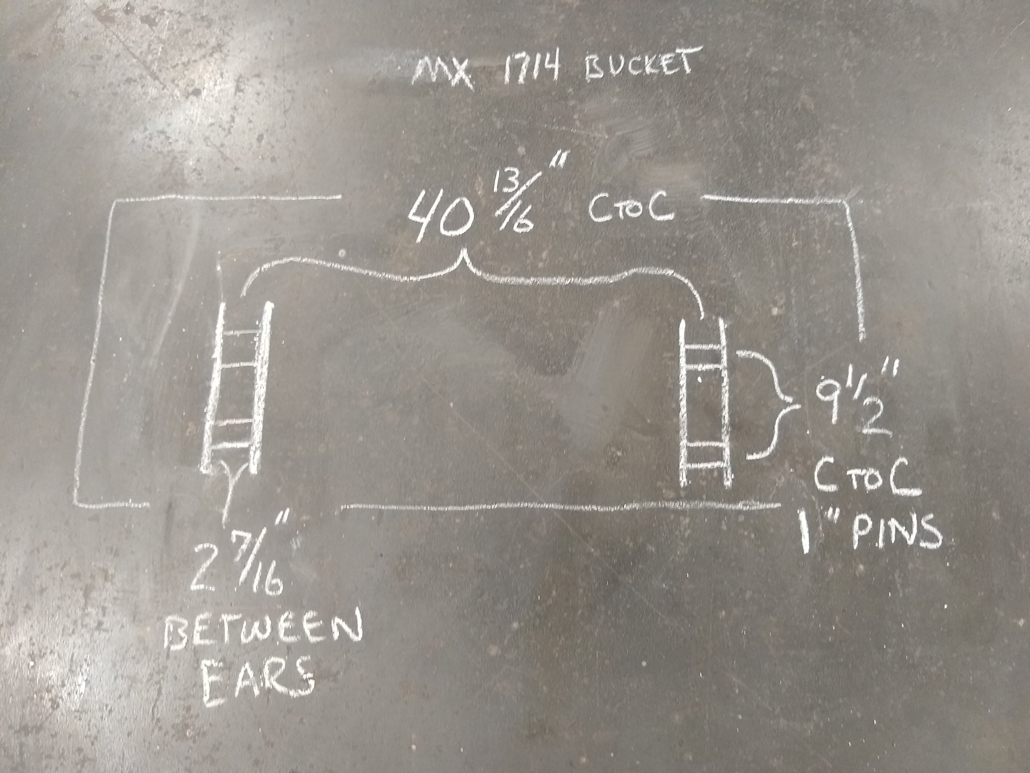

To expand on my initial post, I'd like convert my mx5000 to quick attach and read about the L2203A part available through whole goods.
My drawing shows the dimensions on the back of my pin on bucket.
I'm traveling to a different dealer on Friday and I'd like to confirm if the L2203A will fit.

I can't find that part number. Since you're going to a dealer, you could measure some of the loaders on the lot and compare to your measurements - maybe an L4701/4802 or L3901. Make sure the ones you look at don't have the extra link on the cylinder end. (Your cylinder connects directly to the bucket.)
Or you could order the ATI Tach-All on Amazon and have it delivered in about a week.

Thanks for the reply. I had the wrong part number in my notes. The correct number L2230A.
That ati one looks nice, I'm hoping the Kubota is 1/2 the price
