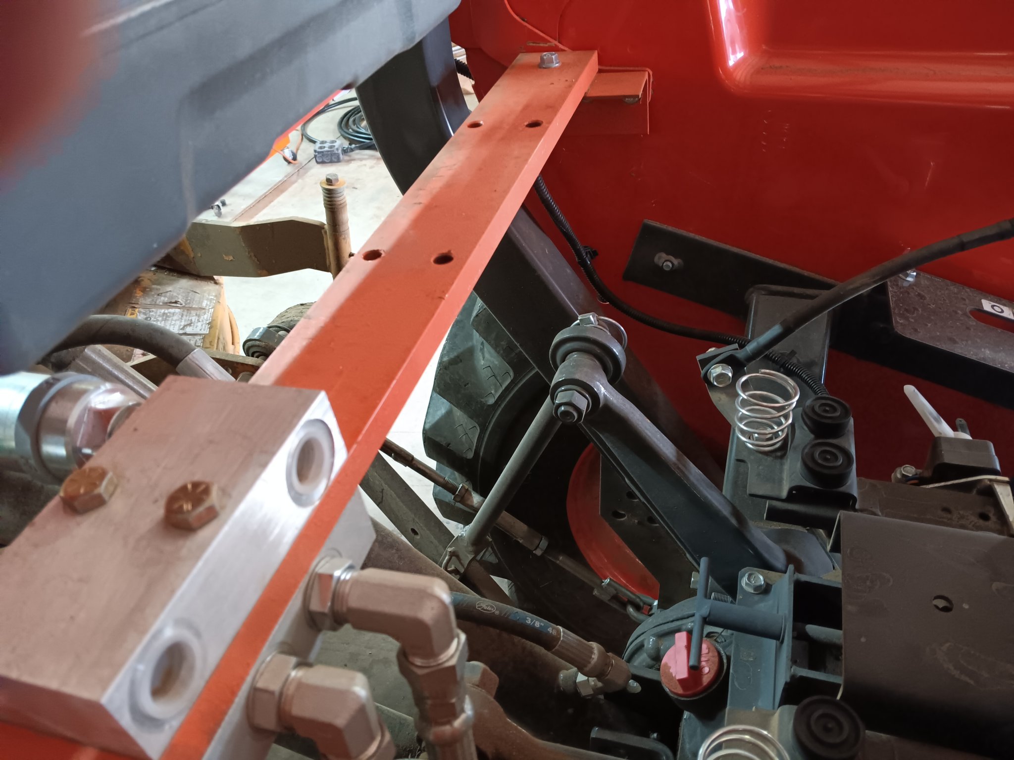

My L3901 with R4 = 27". Lots of variables in that metric. Here is a picture of the lift arm at full lift - fewer variables in that.

On the left arm: 27.5” to the center of the pin when raised, 6” when lowered. This is the fixed arm, not the adjustable.
