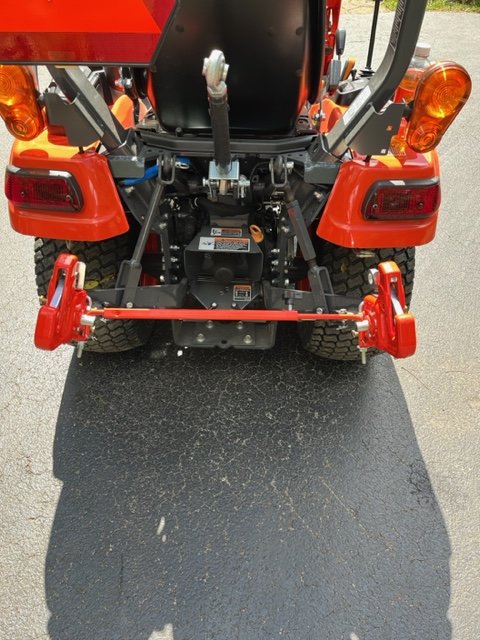

Well, decided to go with the Pat’s system, my time is worth a few extra minutes if that’s what it takes, then I also can feel more comfortable not being stuck buying only one “implement” company!
Thanks for the advice everyone

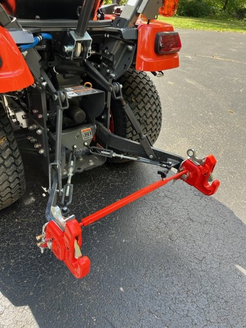

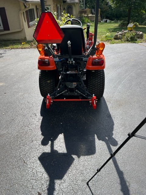

I went with Pat's...Orange of course! I think they'll work just fine....Doggo approved.
