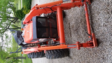

I made one for my L4240 from some punched metal. I made it from two pieces because it was left-overs from a project, $15 each and some angle iron.
This is held on to the existing guard with two each bolts with a hook on them. It works good.
Thanks for the pictures D2Cat. I love seeing the pictures for ideas. That would be the simplest solution and one I could do myself. I just worry if something like that is not rigid enough? If I push into a pile and a limb lets go and sling shots a little id Like the guard be able to withstand that kind of impact. Im trying to plan for the worst case scenario. It is an L2501 we are talking about so I obviously wont be pushing stuff TOO big, but I do want it to be able to withstand any possible forced impacts without failing. I do like your solution however as that is something I could do myself in a day and not have to take the grill off, take it to someone else, etc etc.

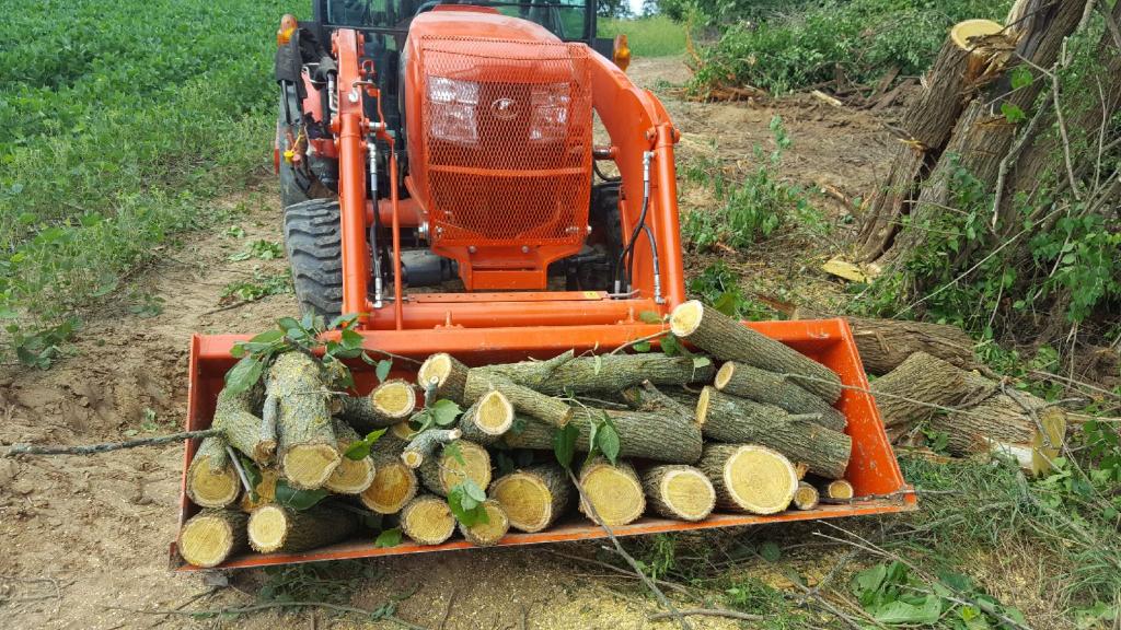

I did the exact same thing on mine at about 35 hrs.I saw where some guy on this forum put expanded metal on his grill and csad it with (what looks like ) 1in.angle iron.Nice job.Think I'm going to do something similar. Btw,this is my 1st.post and have visited quite a bit looking at information. Good forum.

adding expanded metal mesh to the grill guard is one of the first things we do. This is heavy duty 9 gauge mesh
This looks exactly how Id like to do mine. I don't have a welder however so Id prolly have to get someone else to fabricate it. What are you using in terms of paint? I have some of the spray paint that is "Kubota Orange" and it looks perfect and would do the trick, but I wonder how that spraypaint holds up? Are you using something more substantial for the paint ?

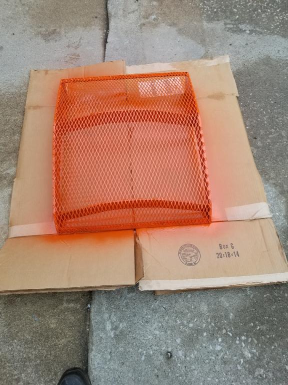

Just put the first coat of paint on my grill guard. It has expanded metal across it to help reduce the chance of a limb making it to the radiator. Came in to get the phone to take a picture, started pouring down rain, so picture will wait.
Nice job,I need to do mine soon.

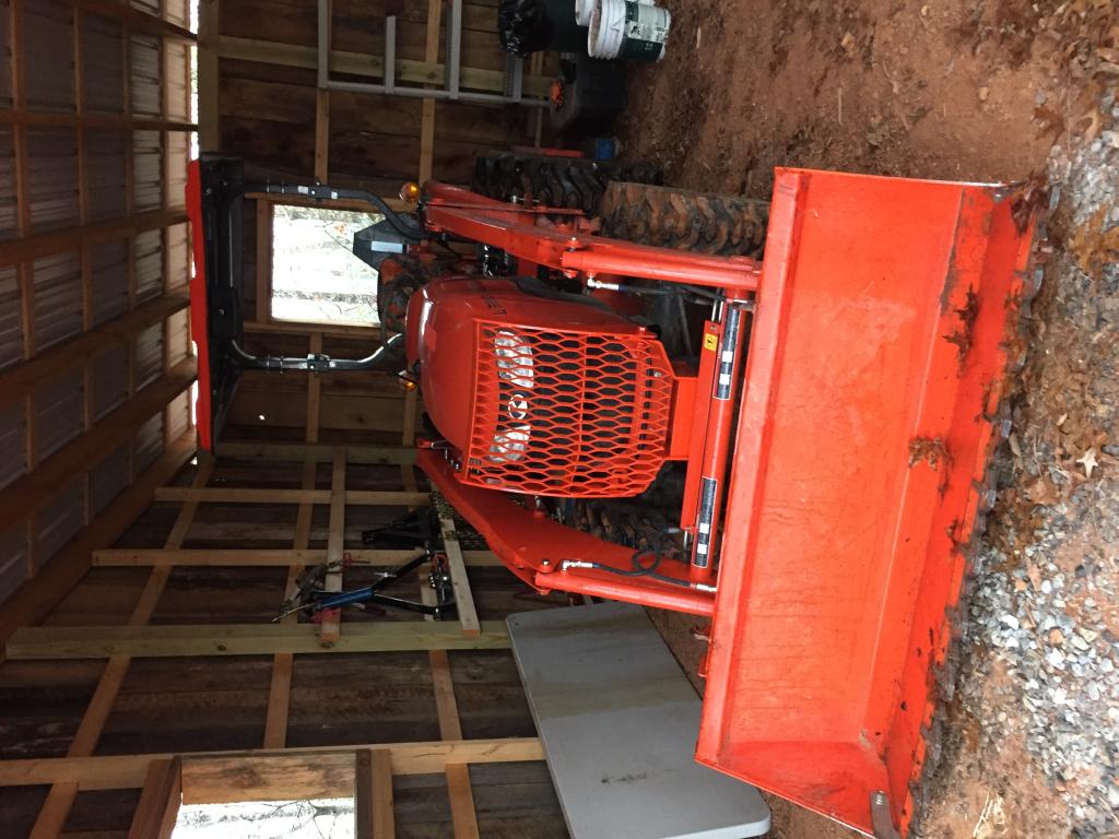

A picture of mine on the tractor protecting the grill
Thanks for that Bmyers! It looks like you added a little bar across the bottom to weld to, am I seeing that correct? Id love to see a more up close picture of how you welded yours. Im trying to decide how I want to approach the weld. Weither I should sit it inside the front a little so it kinda sits on the middle plate, which is inset just a little, or whether I should just weld to the outside rim of the grill. If I weld to the outside rim the whole middle of the expanded metal sheet will have no real support except around the outside edges. That may work fine.....Just trying to figure out how I want to approach it. Would love to see an up close shot of how you did yours if you have one, so I can see how you molded the expanded metal and where you welded it.
I would love to take credit for how it looks, but I don't weld. I work for Mechanical Contractor Company and we have a fab shop, so I gave it to them and an hour later I had it back. Do not weld the bar on the inside at the bottom because you need the room for it to swing open.
They welded a bar on top and on bottom to give them spots to weld to. The reason I know you can't weld it on the inside, because they did and I had to cut the bar on each side to allow it to swing open. I have had it on the tractor since August and it has held up well and taken a few good hits from branches.
