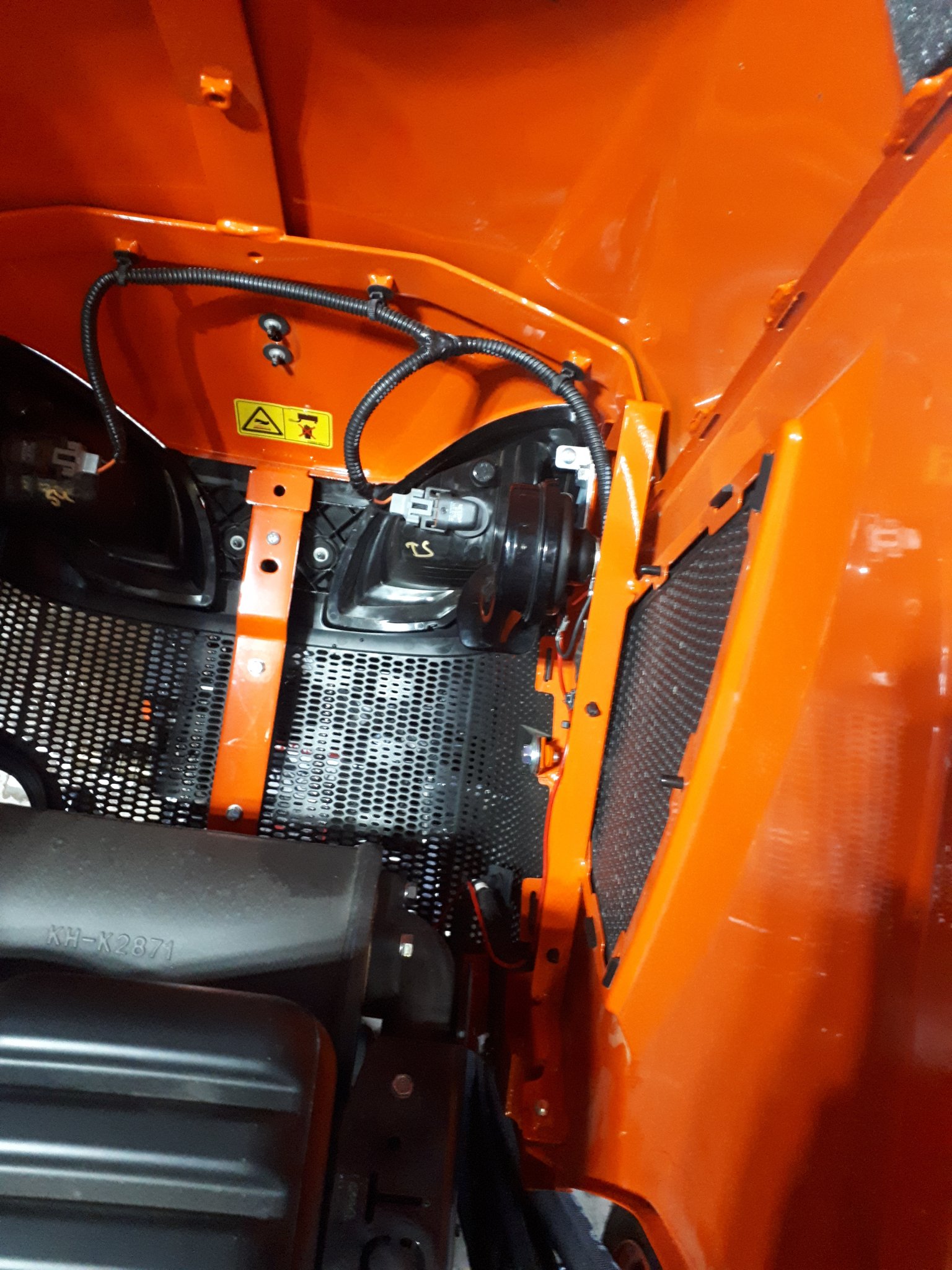

Was bored so yesterday I started this install. Took a leftover horn from my old Harley Davidson Road King (works fine, but I replaced it last year...now collecting dust) and put it up under the hood by the right front headlight. No wiring. Just put it there to see if it'd melt.
Snowblowed this morning for an hour...didn't melt the mostly plastic horn, so after lunch I wired it up direct to the battery w/ a small 10A car fuse.(I might go to a 5A fuse...I couldn't remember what it drew for current, so stayed with a 10A for the moment)
I am still a little worried :rolleyes: about melting in the summer. (It's a breezy and snowy 10*F/-12*C here today so not a good 'heat' test day)
With the hood/bonnet closed it sits kinda ahead of and above the exhaust manifold. Maybe I am OK.
I'll surely know in the summer when I start mowing !
Don't want to show my button installation as it's kinda Mickey-Moused 🐭 for the moment, but I located it to the right of the ignition and pointed outwards, to the right....not towards the operator like would be intuitive. Reason being, if I decide to remove it, or put in a bigger pushbutton, I wanted the room to do so and there was lots of real estate right on the outside corner of the dash. I covered the metal pushbutton with the fingertip cut from a purple nitrile glove and zip-tied it on there. Now you know why I don't want to show a picture of it. ;) I need a better 'horn' label and I am looking for a screw on rubber weatherproof cap...kinda like a primer bulb on a weedeater. They must be out there.
It's plenty loud (103dB :oops: IIRC, when I last measured it on the bike) and it's aimed nearly straight out the front of the tractor below the right front headlight, angled down ever so slightly (so as not to collect rain, dust, bugs, grass or snow that might enter the grille area).
I've only needed a horn maybe 2-3 times in the last 6-7 months, but it sure beats yelling ! 🤬
Here's a poor cell phone pic of the Harley horn on a small bracket.

I used a horn button like this. Got a good quality one from a boating supply.
A horn is really handy when you're out working a tractor. Notifying an animal to get going, or a helper to move something or open a gate, or receive instructions.

For $20 it's hard to go wrong. This is what I replaced the Harley's horn with. They measured within about 3dB of one another with a proper measuring device I use at work. The newer Fiamm had the edge, so that went on the 'bike and the old Harley horn went on the BX. This link is for Canadians, but I am sure Harbour Freight or some similar stores sell a comparible horn.
