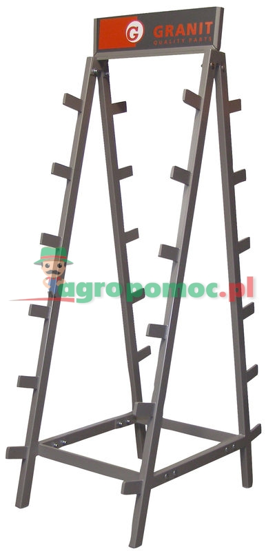

Hi guys, over time I generated 8-10 different PTO shafts and 3 TopLinks, I was thinking of fabricating a wall mount to have a spot for all of them, off the floor and organized.
Did anyone do something like this, would love some photos, for ideas. Possibly with a box for pins and safety pins.
Thank you.
Something in this line, just wall mountable:
