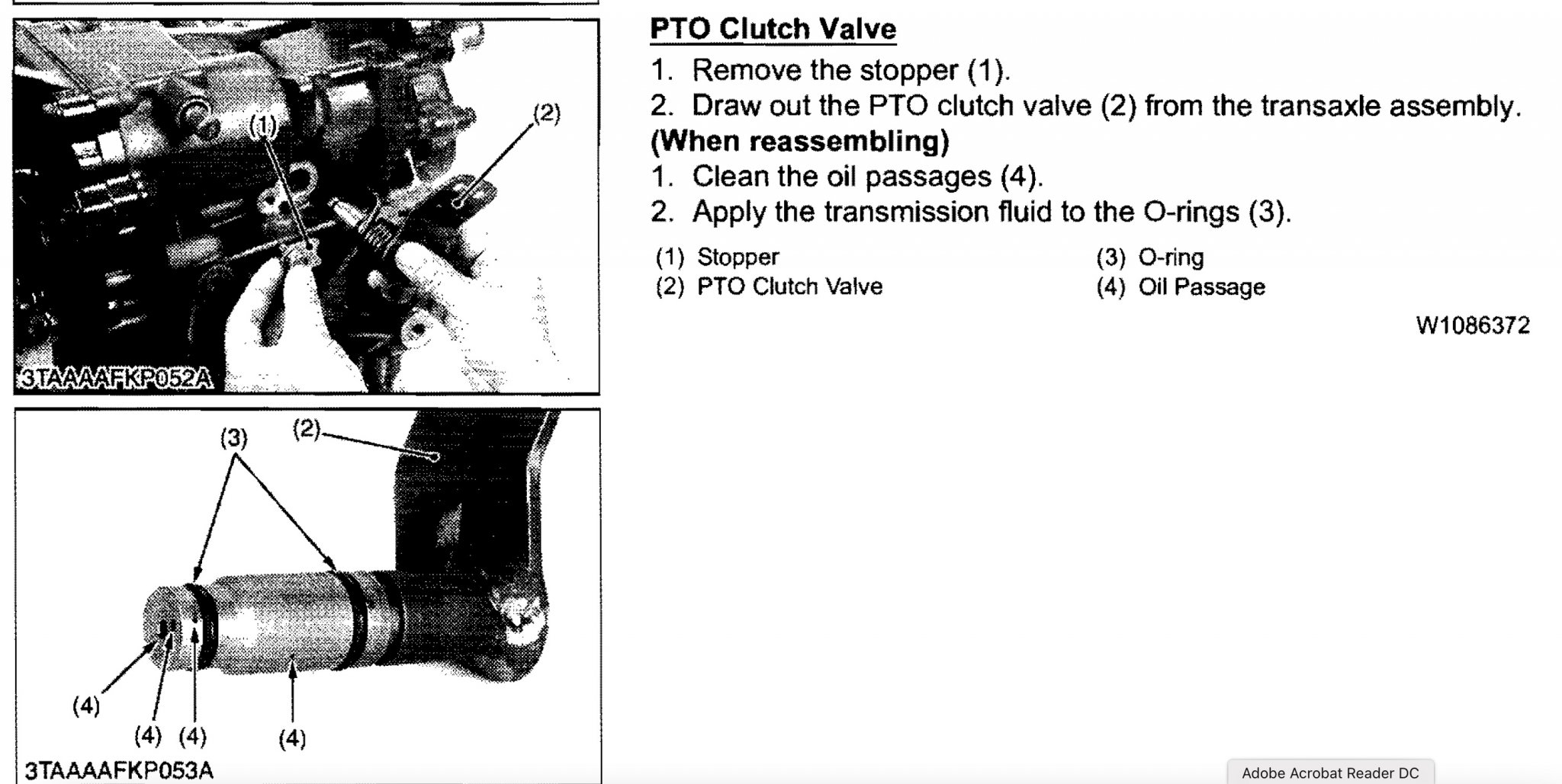

Most likely something is blocking the oil passage to the PTO clutch. Bits of RTV, ect get in there and plug them up

To add to what KUBOTA902 said above, there have been a couple of threads on OTT about this problem on BX's. Most of the times cleaning the oil passages on the PTO clutch valve fixed it. See attachment below for it. If you don't already have the workshop manual (WSM) for your tractor download it at the following link: BX25 WSM . The attachment I posted is from pdf page 177 of that WSM.

I have downloaded a few manuals, but don't think I had the workshop manual. I do now, thank you.
I will check this out.

I was going to pm and go over the tractor through the winter, but didn't get to it until recenty. Anyway, the valve pictured above appears to be at the lower end of the engagement lever. It's behind the frame rail. I'll have to pull the transmission to get to it.
