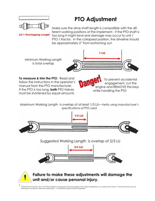

It could reach your tractor PTO but not have enough overlap in the sliding joint.
You will find some variations among PTO shaft manufacturers, but here is one recommendation.

Check the length of the shaft, with the digger all the way up, it should have 6" of overlap, at that point...:D:D

Both of these guys explained it perfectly......^^^^^^^^^^^^^^^^^^^
One last thing - make sure the PTO shaft is NOT too long too. This can be a problem but being too short is more likely a problem.
To find out if too long - hook every thing up and adjust the 3 point so it is level (pto to pto is horz.) then see if shaft will go into both easily. Again - this is somewhat rare - but I have seen it happen.
