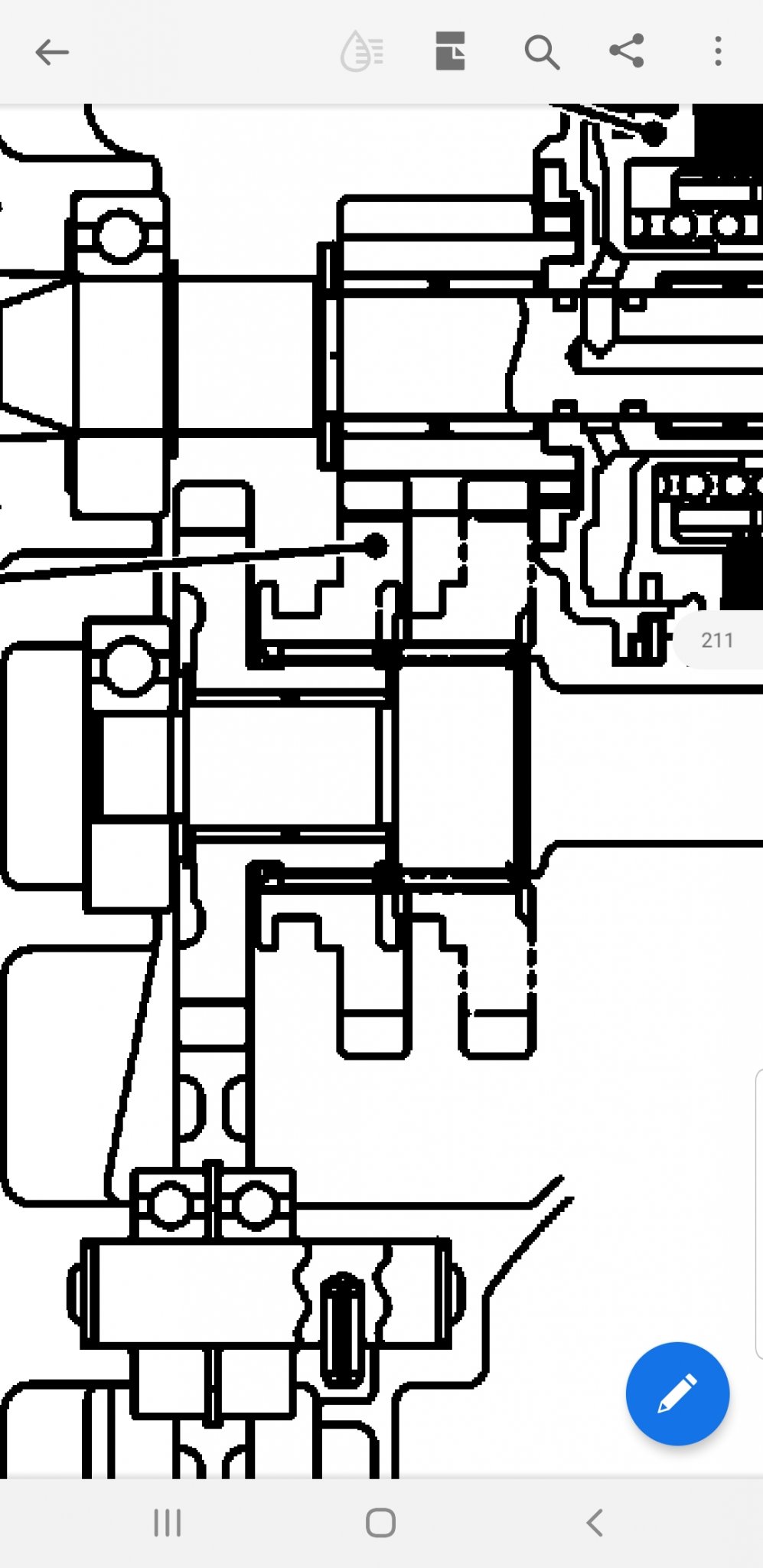

I see it.
See how the rear most gear is in dashed lines? That is actually the alternate position of the "middle" gear. It slides between three positions: forward, rearward, and middle. The middle position bridges the two intermediate shafts which would be both PTOs powered simultaneously. They should be free when the other is selected.
xrocketengineer
Nov 14, 2020
689
569
Merritt Island, Florida
I see it.
I see the slider gear now and the groove for the fork. Thanks!
