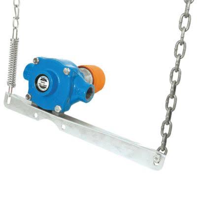

You can also use an ordinary PTO driven sprayer pump. Cheap and readily available but you will need to add the pressure regulator for another $25. Just filter well and the pressure washer will think its city water
I actually already have that for my sprayer.
So your saying to just hook a hose (in/out) on each end and I'm done?
What pressure regulator do you suggest and what PSI setting?
5,805
2,768
If ypu have a 3ot PTO sprayer jist hook the spray gun/ boom supply to the pressure washer just like you would a garden hose. Your sprayer already has a pressure regulator - set it to 40 - 50 PSI. Fill tje tanl with tap water and you are good to go.
