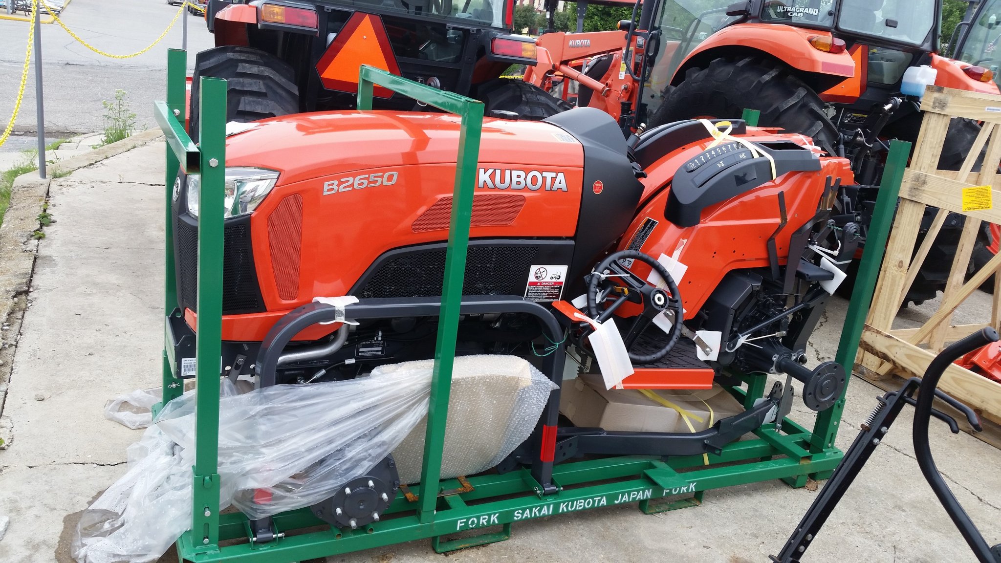

WHY are they shipping our ORANGE tractors in GREEN crates?? !!
(Maybe they believe anything GREEN is only good for melting-down/Making-into shipping-CRATES! LOL

You mean in green frames.... I wonder if that ha something to do with International crating rules?
Dealers ship the frames back to Kubota. Was at my dealer's yard to other day and they were loading empty ship frames on a drop deck.

Neither of mine came in crates. Too big. The came in ovseseas shipping containers, I think 2 to a container. Could be wrong on that again and I'll stand corrected if necessary.

Every unit that does not have tracks, BX thru M's are shipped on a green, black, or gray crate.
