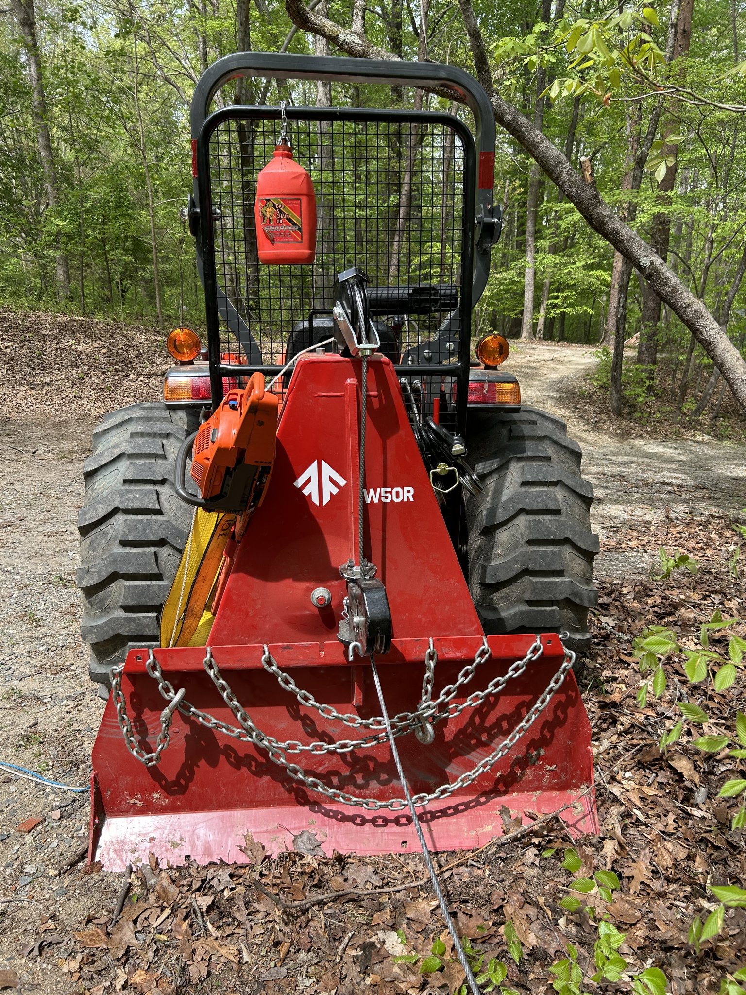

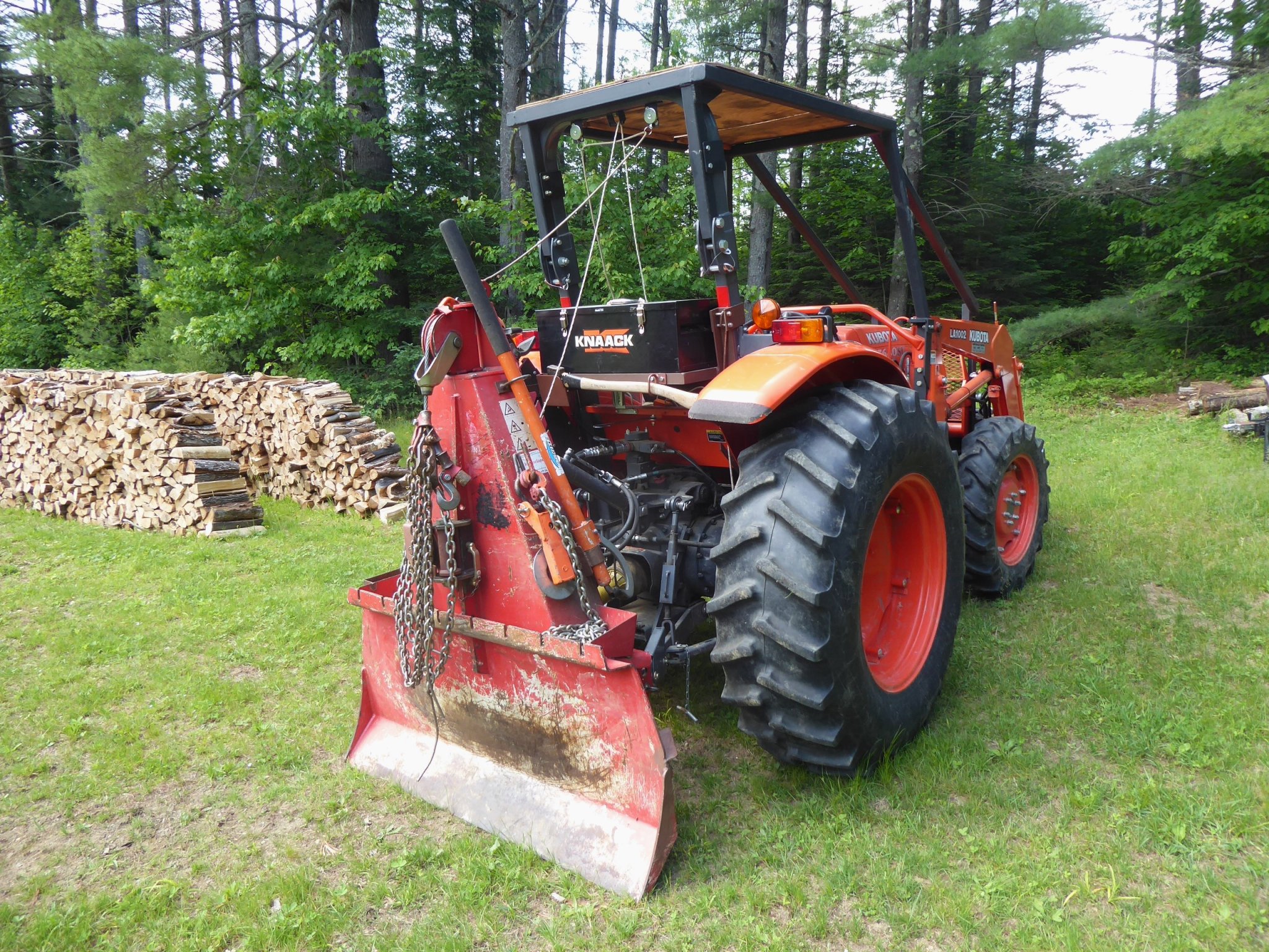

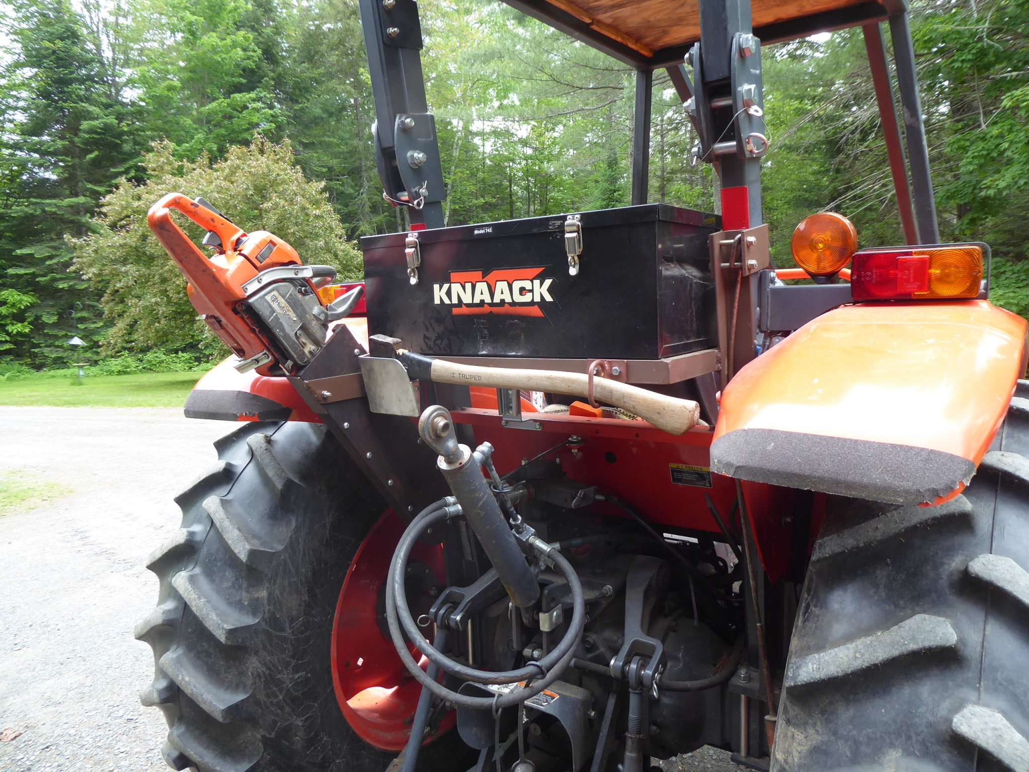

My winch and what has become my standard kit is mostly pictured above: two 15k tree saver straps hung on the left peg, two cheap (Tractor Supply) 20k snatch blocks and two 22k shackles on the right peg, the two chokers that came with the winch and a couple plastic wedges in the pockets on each side of the winch behind the notched bar, a 25’ x 3/8” grade 70 chain for things the chokers are too short to wrap, chainsaw in the hammer strap on left side, saw oil clipped onto screen. Cant hook; saw gas; and a cooler with drinks, gloves, and any other smalls is carried in the grapple. For hard double line pulls, I add one or two 1/2” x 6’ grade 70 chains to use past the snatch block, but I don’t carry them routinely.
Helmet hangs on the peg with snatch blocks and chaps hang over the top sheave on hot days when I prefer to not wear them on the way to and from the work site.

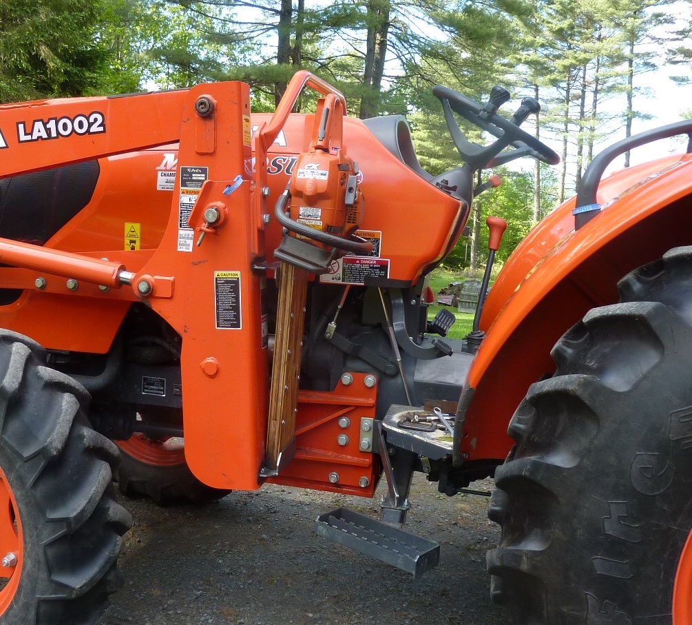

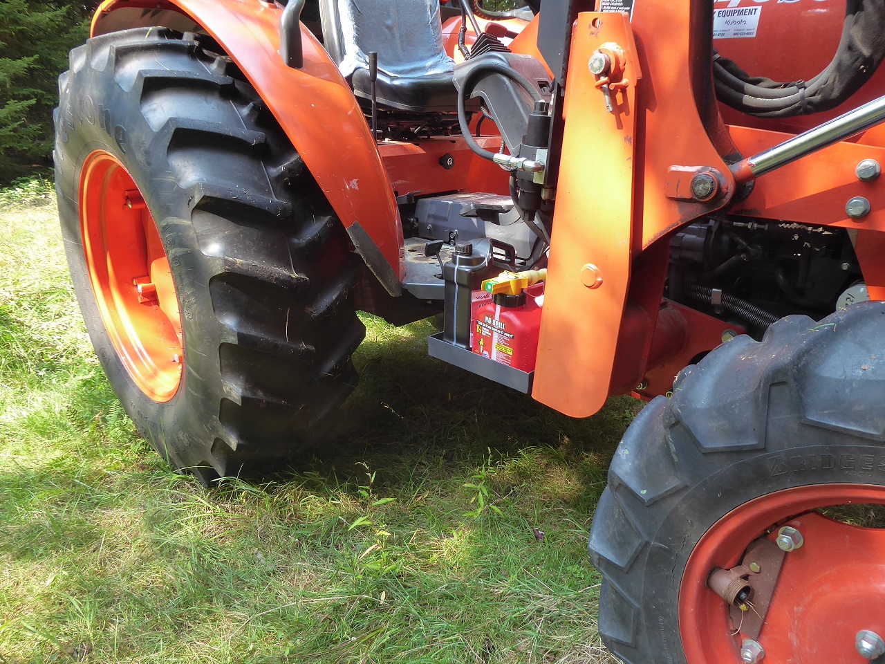

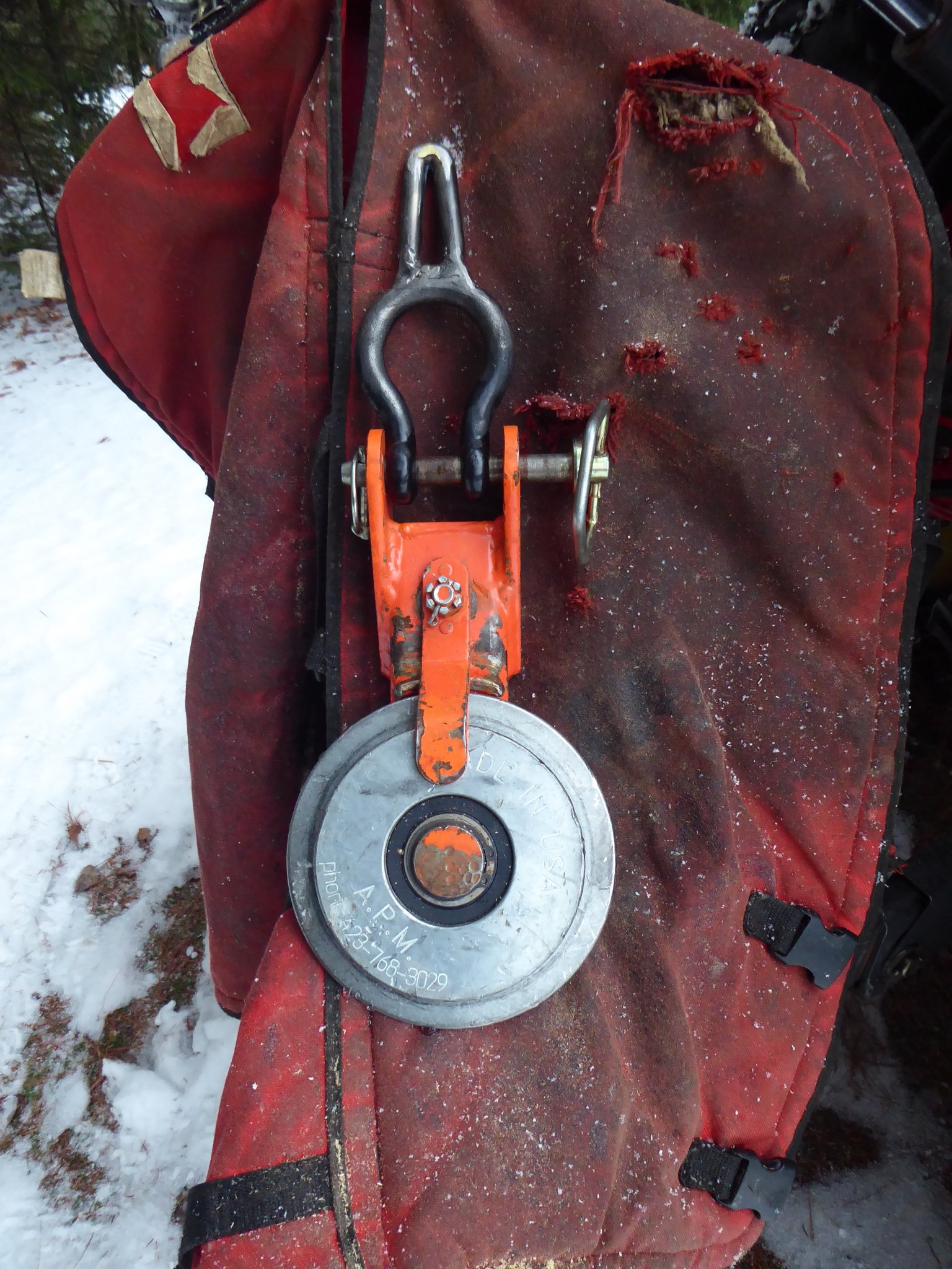

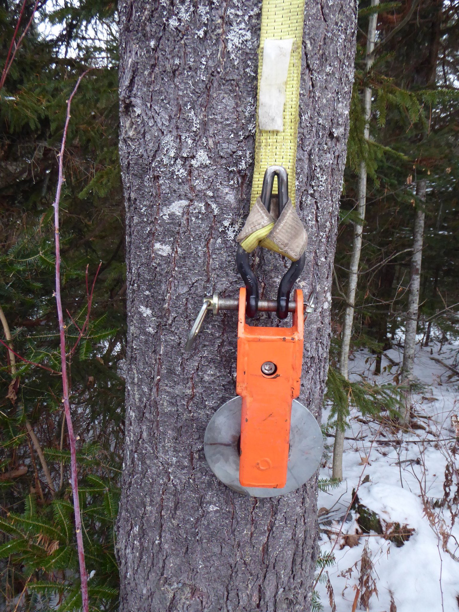

You guys have the essentials pretty much covered. The picture in post #5 pretty much shows how I carry some stuff. I have gas and oil here-
Two saws - 16" light weight 50 cc go to saw.
and 24" saw.
Essentials in tool box are files, wrenches, and wedges.
Other handy items I carry - a block for double line pull. Better cable retention when cable goes slack.

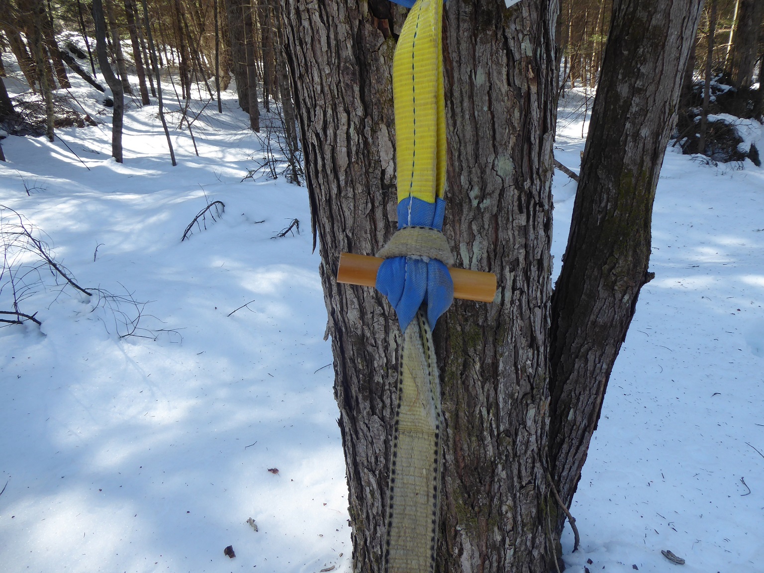

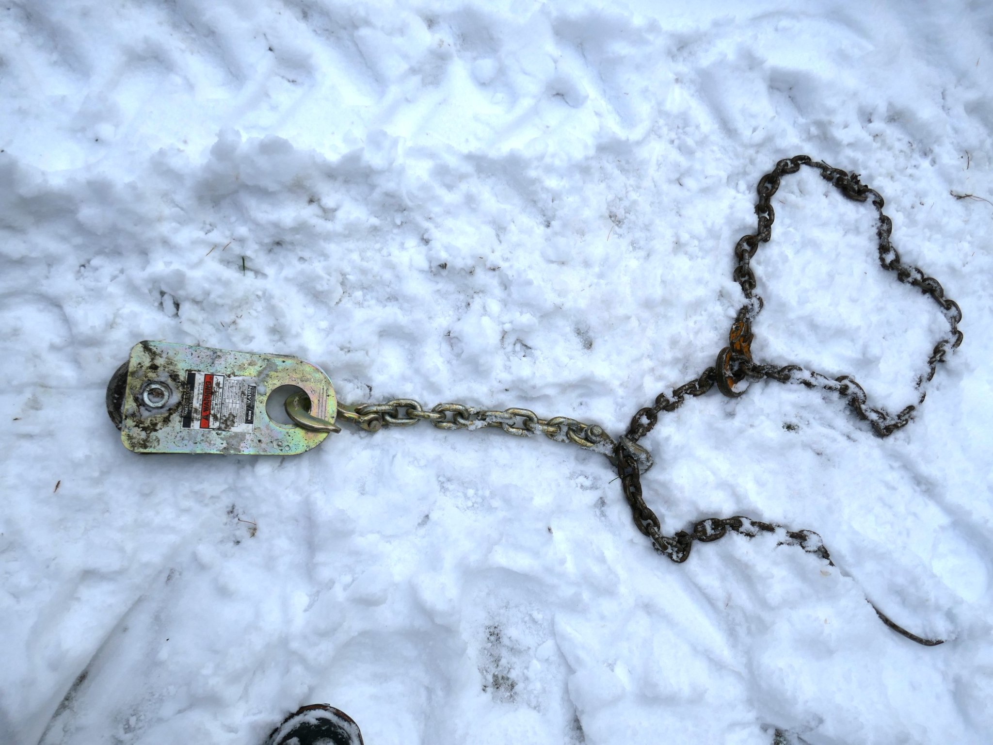

If a don't trust a wedge for directional felling, because of rot say, I use a snatch block. Often the block placement wants to be in an opening. So it requires a long strap. If I need to splice two straps.
I put a section of 1" dowel in the joint so they come apart easy

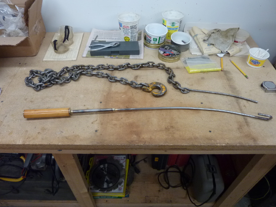

A choker grabber is handy with big stuff. Shove it under the log and pull the choker under.
I welded a point on the snatch block to make it easy to set up. Put the strap on the tree w/o the heavy block to hinder then hang the block,
