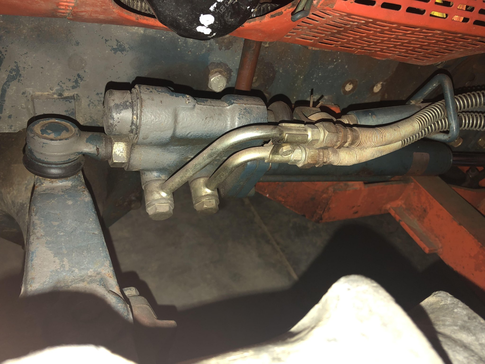

The OEM Power Steering pump is B9182 And you can find it in the parts system if you look up the B8200DP tractor and look at the extra available equipment here: https://apps.kubotausa.com/illustrated-parts/
I think this was dealer installed... did they forget to install a diverter valve?
And I've attached two pictures, one showing the forward hydraulic block and the other showing the B9182 power steering pump. There is no diverter valve and there is no flow control valve. This was done at the factory, so I'm not sure they had a diverter valve... BUT without it, the problem with the FEL weakness exists as the power-steering pump is getting on the flow... Does anybody have a picture with a diverter valve (someone mentioned harbor freight)?
And here's the B9182 power steering assembly:

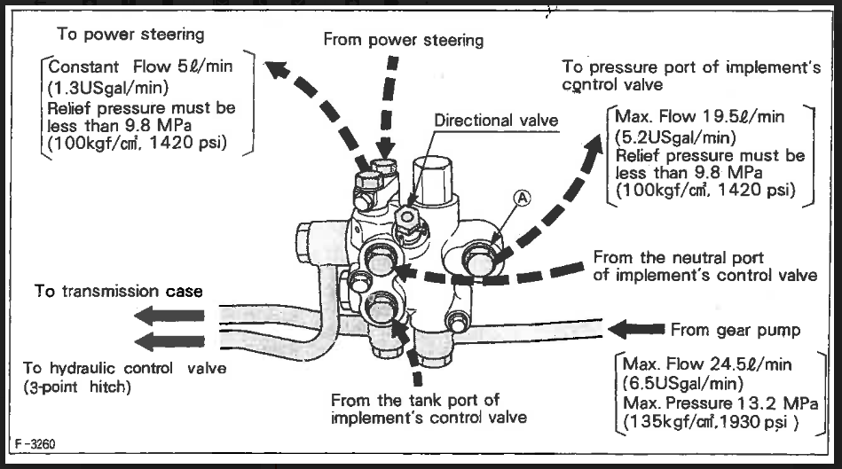

I just saw this, a new member posted this in another forum and it explains the flow for this valve. I saw someone above was asking about it:

really? Mine is factory and it works great. B8200DT. Are you saying there are no rebuild kits for it?
You are one of the rare ones as that unit is near to impossible to find.
Hope it keeps working for you as the seal kits are obsolete for these.

That model power steering unit (it's not a pump) does not take a separate diverter/ priority valve.
If I'm understanding your base question, is why is my loader weak, could be from a multiple of reasons.
#1 Damaged/ Worn hydraulic pump
#2 Damaged / Worn loader spool valve
#3 Damaged / Worn Seals in the FEL Cylinders ( most common issue )
#4 Improper position of the directional control valve on the Hydraulic block
Hydraulic pressure testing would be you're first line of attack.
