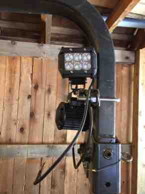

Thanks RCW! I used your advice and found the hot and ground leads...
sorry for the un focused pic...

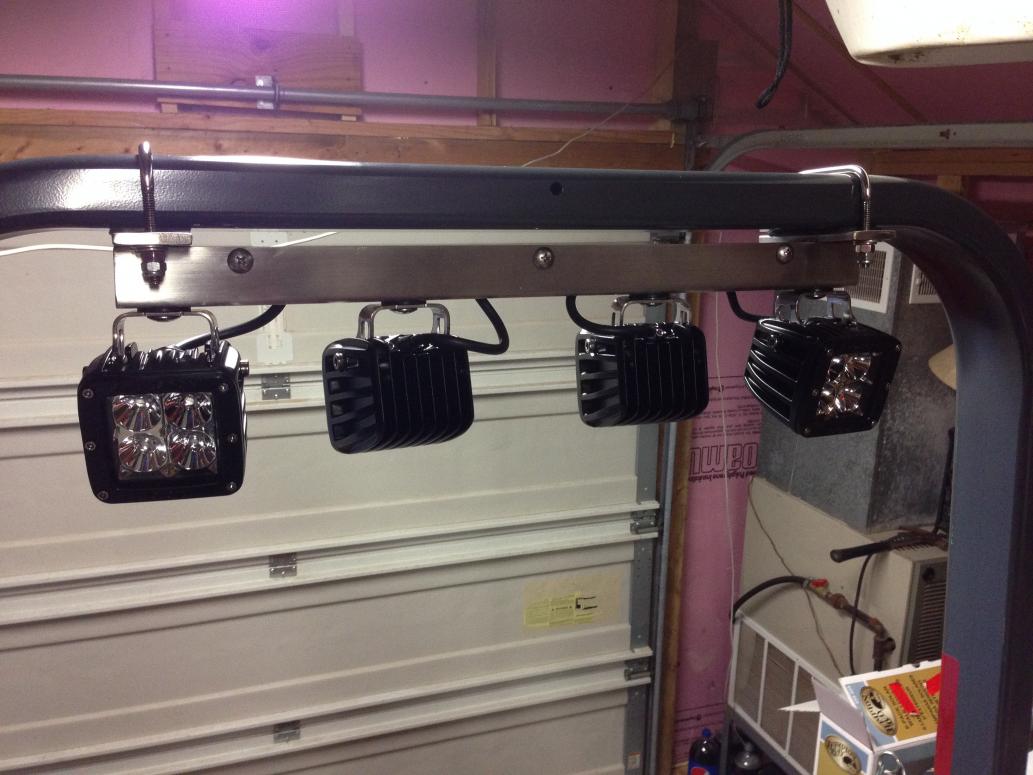

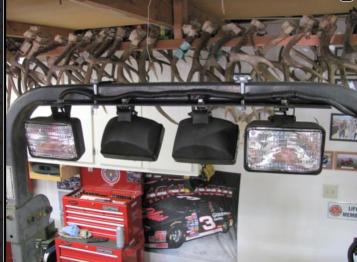

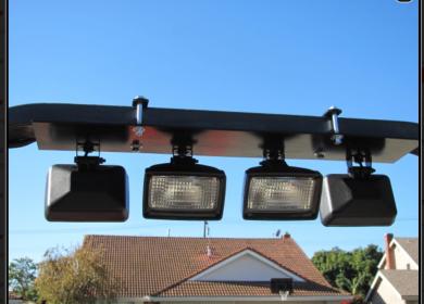

So, I have a B2620 and have been contemplating different ways of mounting and running the wiring for my new 12V - 18W LED lights, 2 forward and 2 rear facing, on the ROPS bar. Searching through numerous threads yielded some pics...but I was hoping folks that have mounted auxiliary lights on the ROPS would be willing to post some pics of HOW they mounted the lights? Drilled into ROPS? Clamped? Magnetic mounts? Top? Side? Fabricated brackets?
I would certainly appreciate seeing how everyone else has mounted them and this could be a central repository for future reference for others!!
Thanks very much and I will post my pictures and description once my setup is completed...

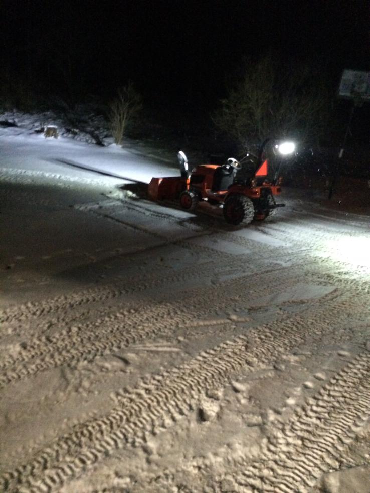

I added this canopy to keep my head cool. On the front of that i mounted two 12 inch LED bars. On the back hanging under the rops is a strobe, and on the right is a fan pointed at my neck, its a beautiful thing on those 90 degree days
