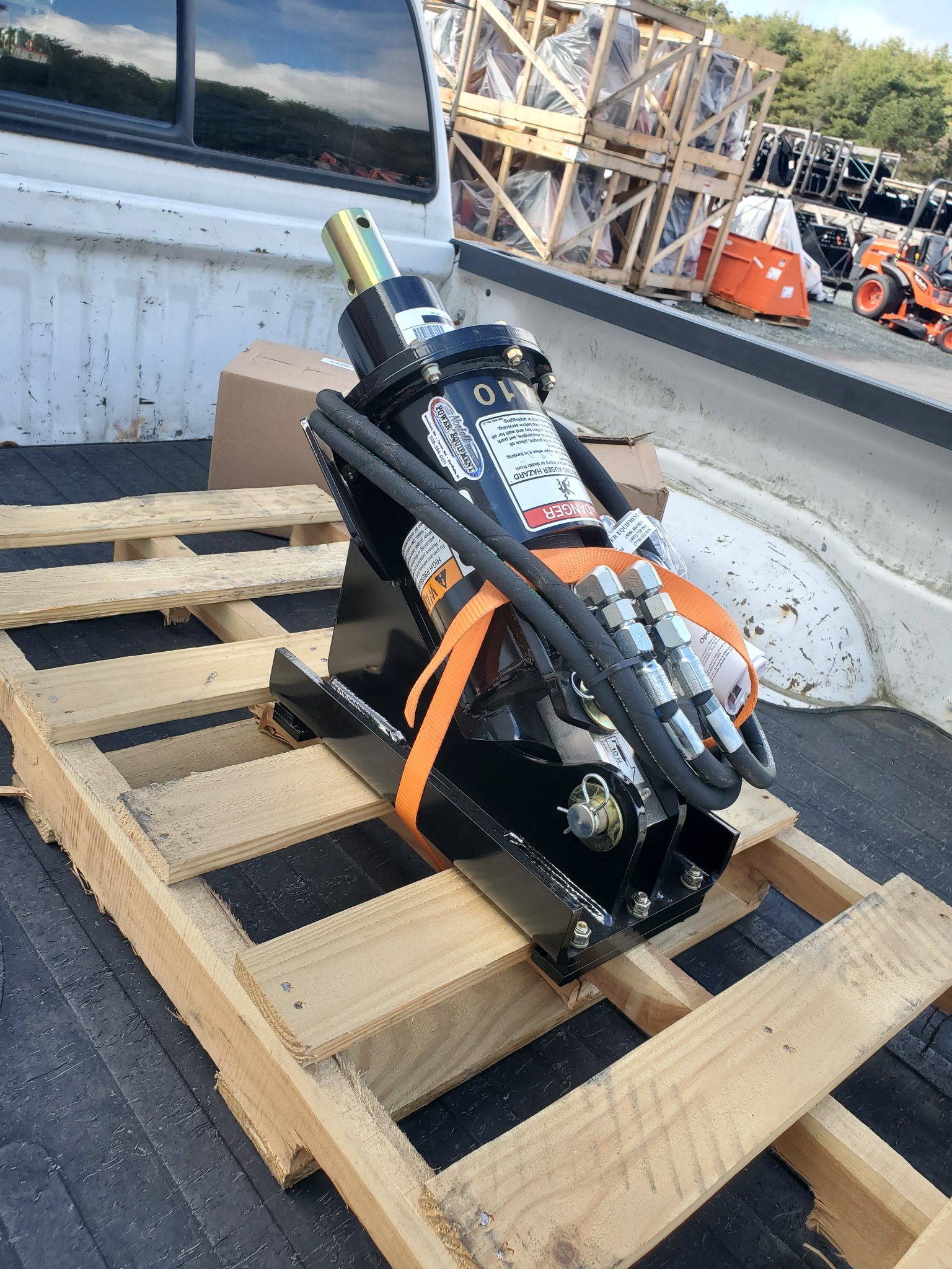

Picked up the second part of my post hole auger. Doing it in pieces so it's a little easier on the wallet.
First piece was my pallet forks. This mounts to it. Saved $300 this way (SA10 with the SSQA mount is $800 more but I could have had it with a $500 discount when I bought the tractor.)
Heavy, but I can pick it up and I'm not that big of a guy. So I should be able to just set it on the mount when I need to.

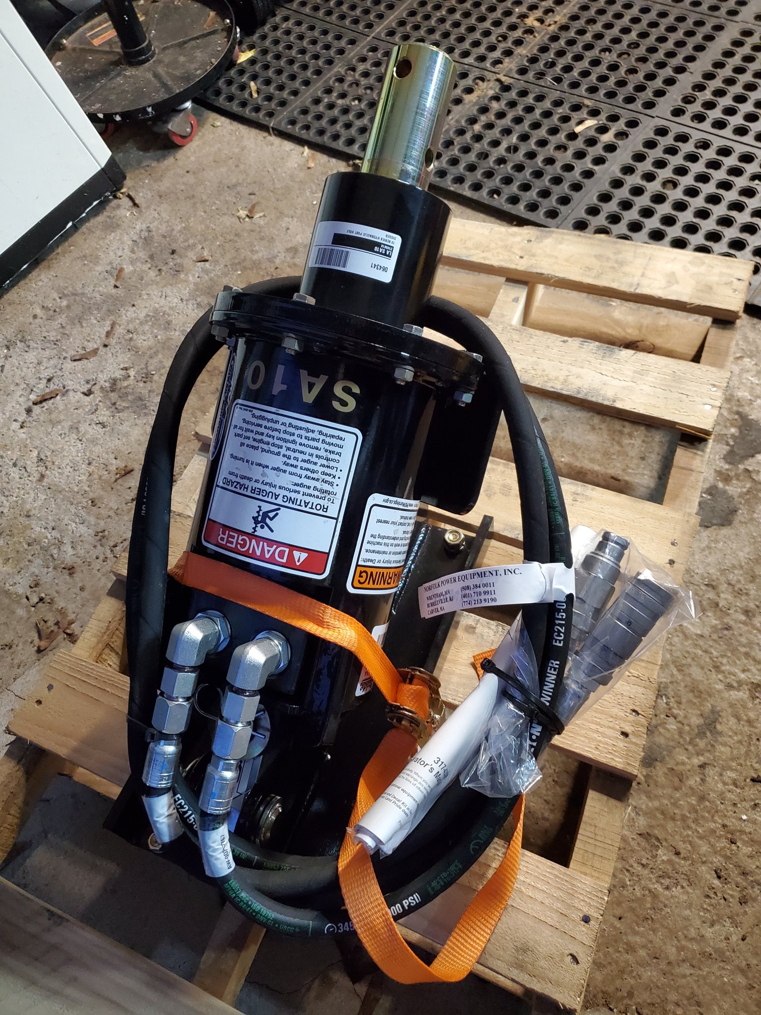

Some of the small stuff in the kit. I'm missing both of item # 20.
I also learned a 9/16 JIC fitting in Kubota speak is actually a 3/8 fitting, or #6.
9/16 (x 18?) is actually the thread size. Same goes for other fitting "sizes" they list.
