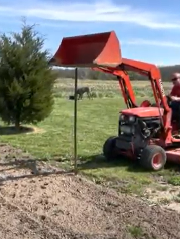

A few people on YouTube have done it. Here is one.
I'm not sure how effective your BX would be. I think you'd have to add yours to the center of the bucket and reinforce it prevent bending the bucket. another option if you have pallet forks is to attach a tube to the frame.

I used my bucket to drive/hammer in a number of T-Posts around my garden. I would just stab it in the ground by hand and then push/hammer it down with the bucket. Softer areas it would just push. Harder areas I had to hammer. Worked great and saved a bunch of time/effort.
Any post thicker than the T-Posts and it probably wouldn't work. Soil here is a lot of clay.
