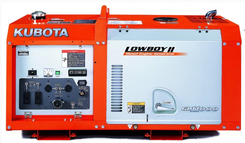

I added this Kubota 11,000 Diesel generator, and a Reliance transfer switch.
Also have a gas 6,500 Generac that works but, hard starting due to old gas and the recoil acting up when I wasn't home, caused me to upgrade.
