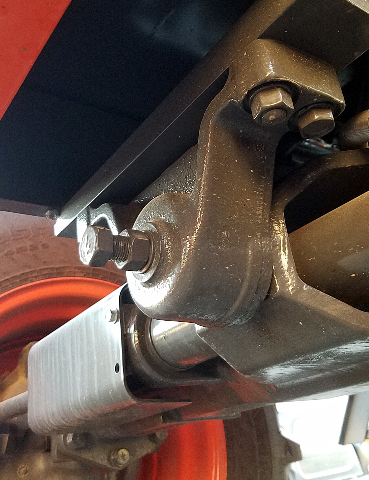

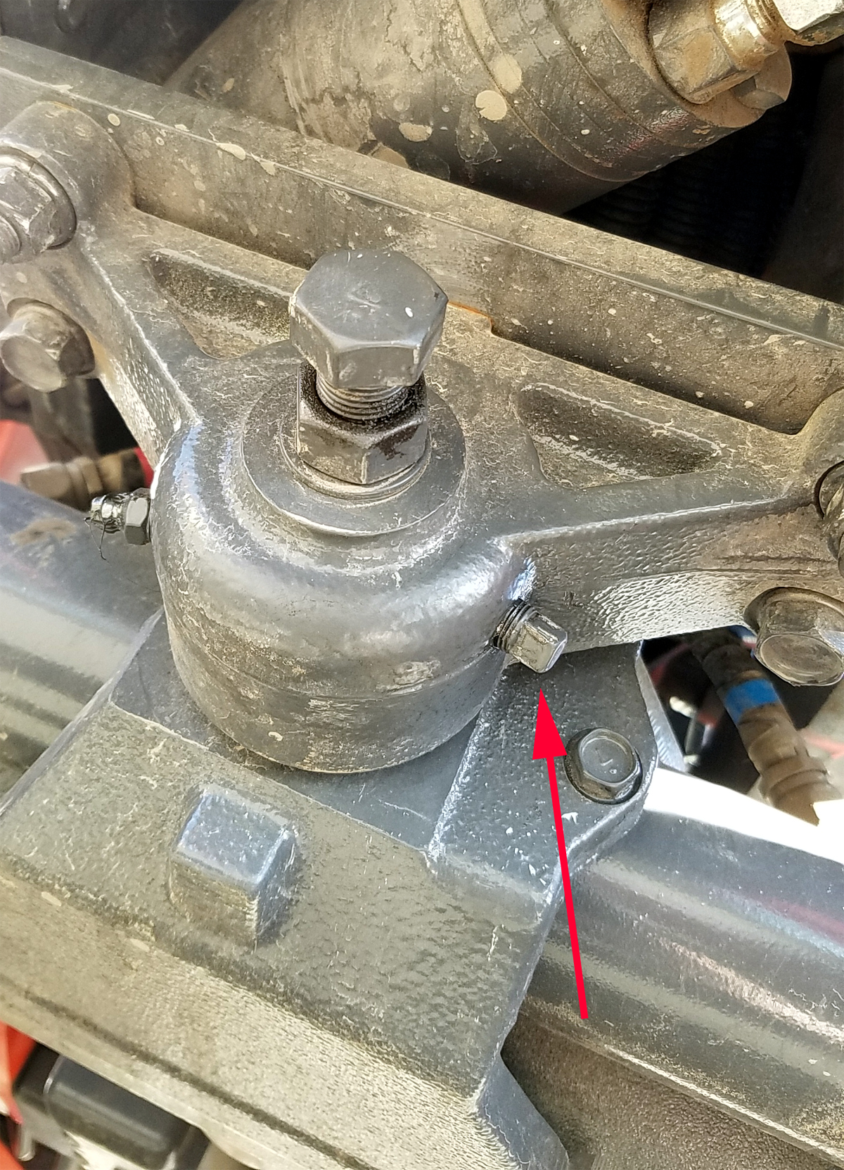

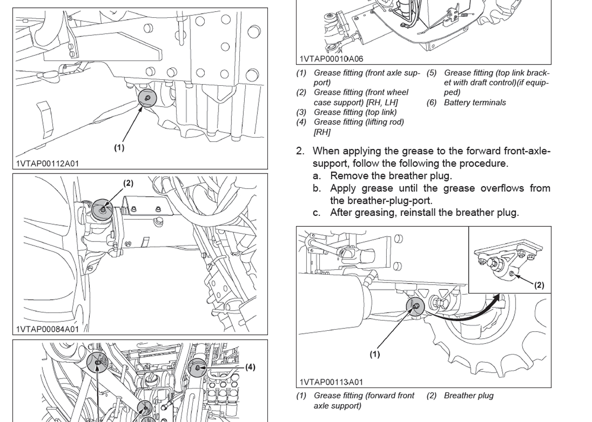

I was reading the MX manual the other day and noticed this comment re removing a plug when greasing the zerk fitting on the front axle support (FAS). I don't remember if the BX25 had a plug or not, but the M sure doesn't. I have no idea why the MX FAS has a plug and the M doesn't but someone thought is was necessary.
I can tell you from personal experience that it's hard to get grease into the bushing without removing the plug! The plug is a 7mm square nut but I had to get a much bigger wrench (adjustable crescent) on it in order to break it loose! The photo shows some paint bunched up on the plug head.
MX front axle support.
M6060 front axle support.

Honestly I glanced at the manual saw the zerk on opposite side and greased it….so is that square nut a viewing location to make sure packed with grease? I most certainly did not realize or read closely enough, and even now I still haven’t actually gone back to my manual since reading your post…I just thought interesting so that am inquiring. 🥃

L2501 has the same 7mm plug. I must be lucky as it just took a simple open end wrench when I removed it at my 50 hour maintenance.

Same on GL series (at least 6060).
Grease cavity is sealed. Removing plug allows one to add grease without blowing out seal(s).
