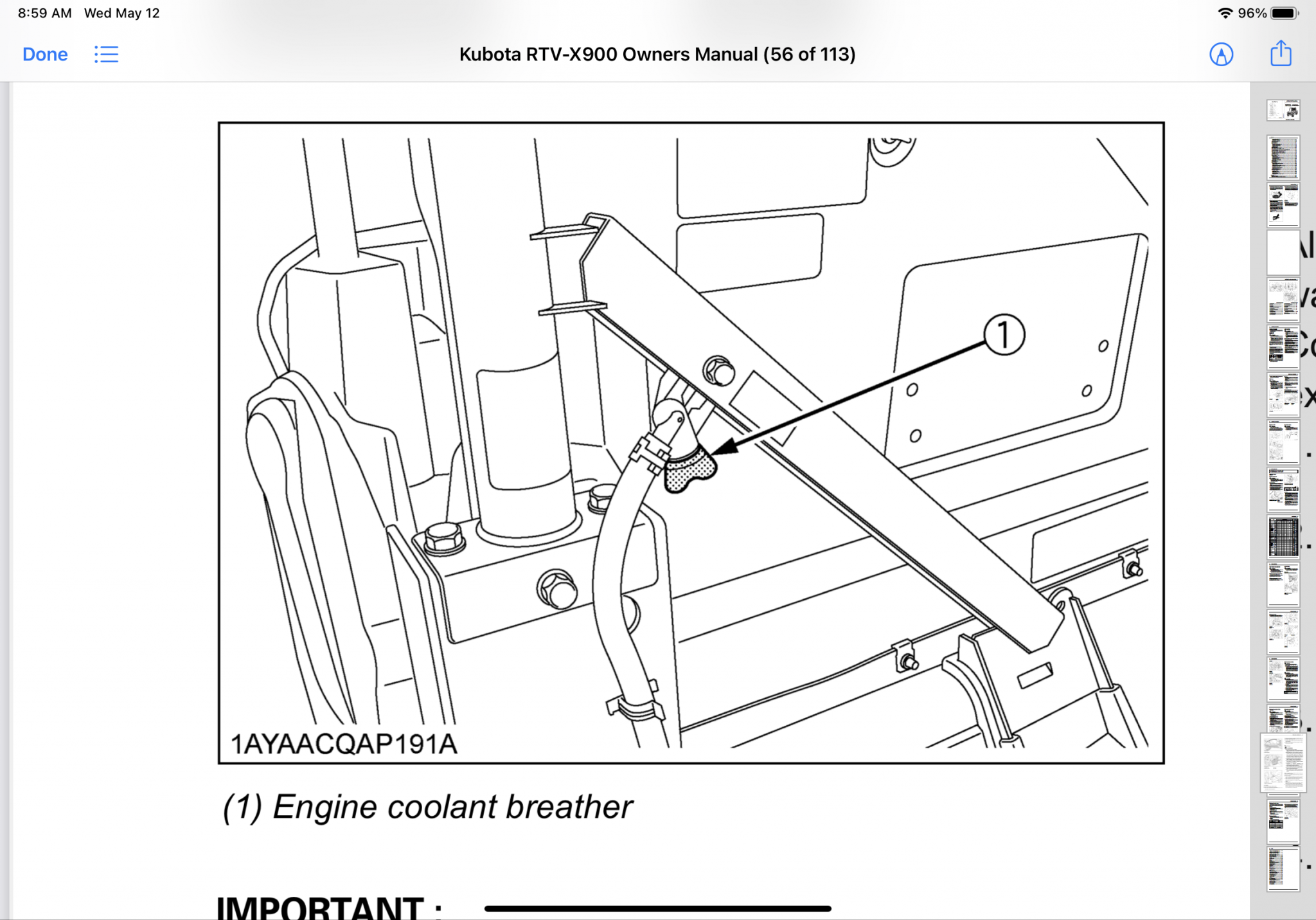

The RTV (X900..same engine) has a cooling-system “breather” .... a vent-vlave behind the drivers seat on top of a 3/8” rubber hose. If the coolant is added after any kind of engine work,... as soon as it is started...that breather/vent must be manually opened to let air out of the system, and then top-off the system.. or it will overheat within minutes....possibly blowing the head gasket (or if done repeatedly or severely may crack the head.)
Even tho’ the overflow reservoir is full...the system will not suck colant back into the radiator to make up the low coolant level until that breather/vent is opened and the air expelled.
Even tho’ the overflow reservoir is full...the system will not suck colant back into the radiator to make up the low coolant level until that breather/vent is opened and the air expelled. View attachment 59743

The way I discovered this issue was when I found a loose clamp on the system (on a hose-to-pipe which passed underneath the cabin) that had dripped onto the floor. I had to drain the system to clean corrosion off the pipe during that repair, and I re-filled the system completely.... or so I THOUGHT!
My overflow reservoir was almost full, and I completely filled the radiator and I started ‘er up and when the thermostat opened up and the radiator tank level dropped.... I topped it off again. It was FULL...and the overflow reservoir was almost full.
I was ready to go riding and so I let the wife drive. We didn’t get 1/4 mile down the road when the high-temp alarm went off and the temp gauge was AT THE TOP of its’ range in the overheat range. It was only A few minutes for it to overheat.
I was really surprised to see that the radiator tank was low...and the overflow reservoir was still almost full! That made no sense to me. Pulling out the WSM, I discovered the little “breather” comments and illustration.
Opening that breather valve allowed me to “for real” top-off the radiator. Now-truly-full.... no more overheating issues.
