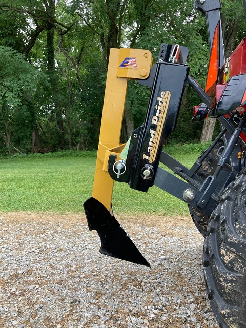

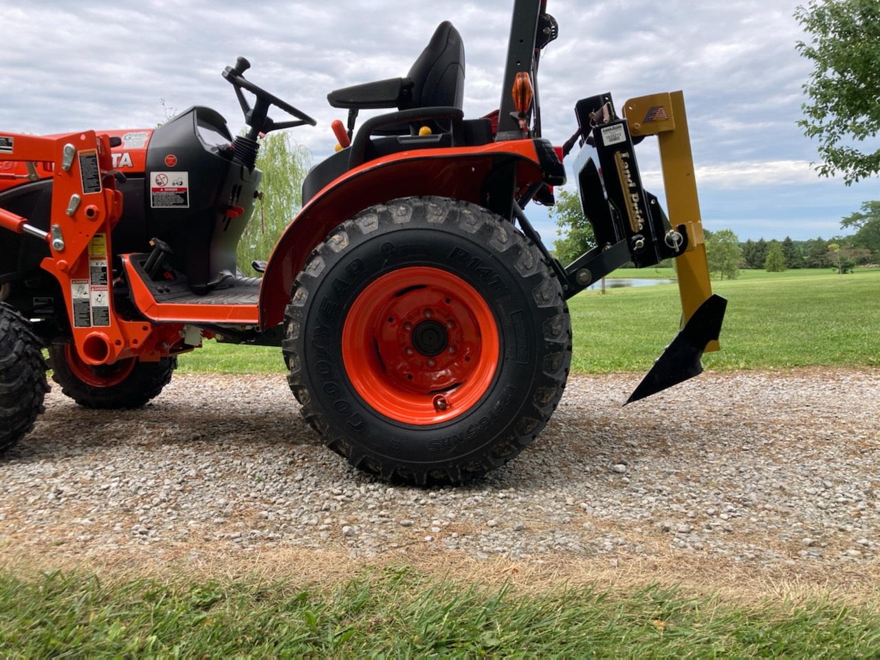

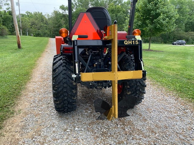

Purchased this EA Extreme Potato Plow/Middle Buster...ordered on 7/25/22 and was told should be about 6 weeks, ended up getting shipped and delivered on 8/6/22...I was really happy about that! I will primarily be using this for digging potatoes/other root crops that we grow.
I've looked at other brands over this last year available at TSC/Rural King/Etc. and wasn't fond of the quality (thin material/poor-messy welds/etc). I'm sure they would work, but none that I came across were quick hitch compatible. Overall, this EA plow is a beast in comparison to the others. Very thick/heavy materials, larger 18" plow section, nice wide wings built into the upper area of the plow which should allow the material to flow well when digging our harvest. This should easily last my lifetime of gardening and be able to pass it on to my kids for there use later. Wasn't cheap (nothing is right now) but I am overall impressed and glad I made the purchase. I will update once we put it to use in a few weeks.
Here is a couple pics with it mounted on my B2601...last one is just showing off the tractor, as I haven't posted here in awhile and have added a couple other things. Just wanted to show how it sits when the 3pt is raised all the way up, incase others were wondering. Only thing I need to do is add some Cat1 bushings to the lower pins, that way the fitment will be better inside the QH15.

View attachment 85354 View attachment 85356 View attachment 85357 View attachment 85358

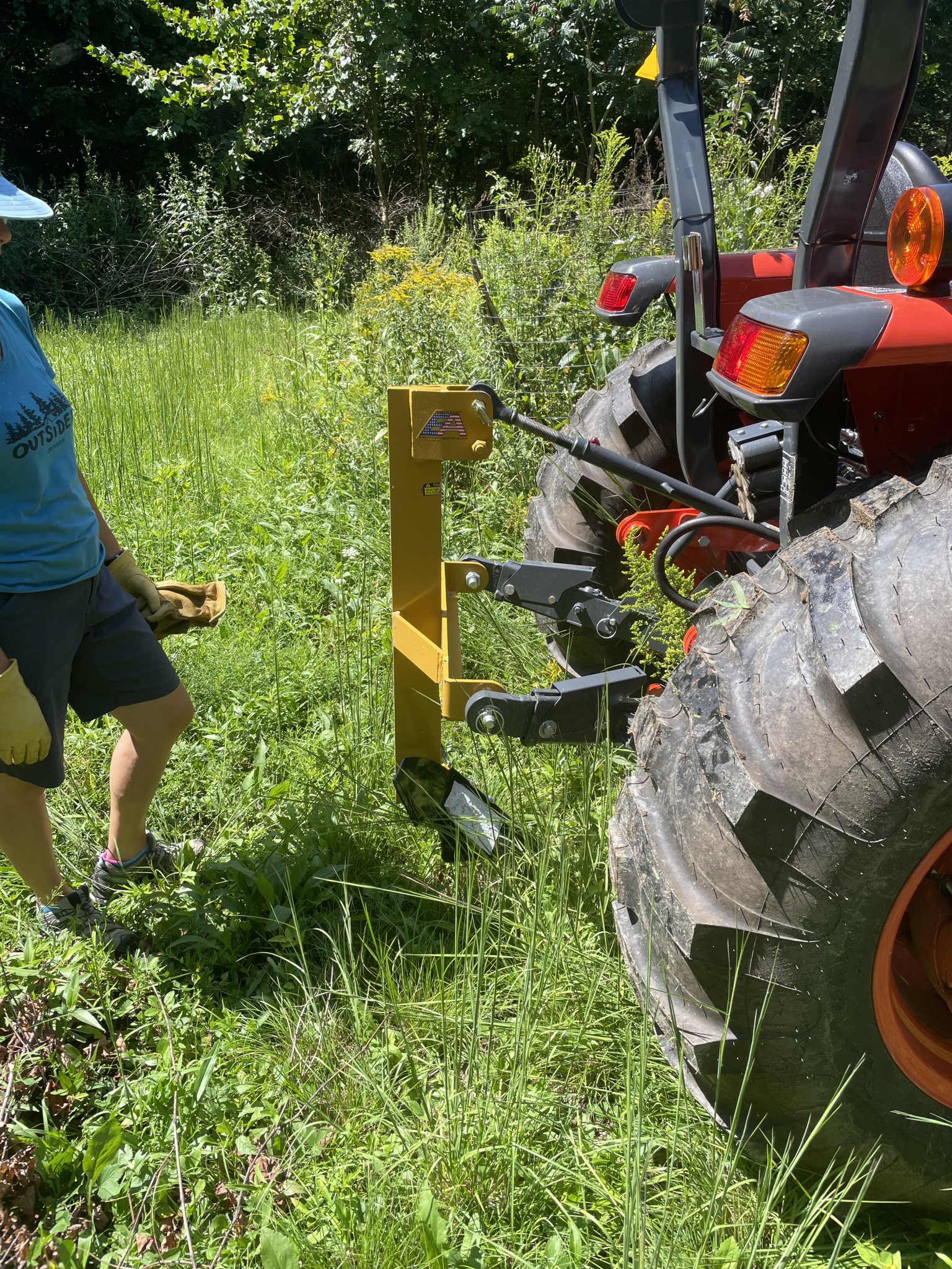

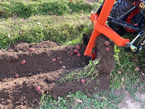

Sorry for not responding earlier, but here are a few pics when I used the plow last week to start digging my crop. Hopefully the side shots will give you an idea of what depth & angle I had everything set at. Oh, and I didn't like the mustard yellow paint color that it had, so I painted it orange :)
The Tilt Angle can be deceiving, as I set the tilt so that the plow bracket was basically vertical when the 3pt is lowered and the blade is resting on level ground. I wanted this to be a good start point. Once I set this, I raised the 3pt all the way and proceeded out to my garden. So what you see in the pictures might look like I changed the tilt, but really all you are seeing is the natural angle that the 3pt is at in the raised position.
I will tell you that I did not have to lower the 3pt much at all, as I found it was digging way to deep (but I also had my potato's hilled, so there is not much digging but more busting up the row).
From the highest lifted setting (8 on my B2601), I only lowered the 3point down to about a 6 setting. Your machine may be setup different (overall tractor size, different brand middle buster, etc.) so you will have to check this and make adjustments as needed. You will quickly be able to tell if you digging to deep, as you will end up burying your harvest just as quickly as you dig them up.

A PTO driven potato digger would be awesome, but I don't plant anywhere near enough potato's to justify spending $3500+shipping for one. And even those units still require you to pick them up, unless you have a conveyor setup behind it to catch them, which is another additional investment.
I was ok spending roughly 1/10th the price of PTO style on a middle buster plow and picking them up by hand. The only real work left to do is pick them up off the ground, which I have my wife and kids go behind me after I make a pass and grab them. It takes me roughly 30seconds to make a pass with the tractor/plow to dig them up, and it takes my wife & kids roughly 5 min. per row to gather them. They grab what you see on top and do a simple kick in the loose dirt to see if any got missed. The fact that we are no longer on hands/knees or digging with the forks saves a ton of time and everyone is much happier. We had all our harvesting done in just under an hour.

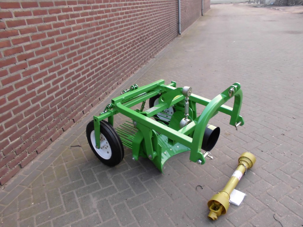

Considering your needs (400' total row length), a machine like this should do nicely, for around $1,000, including tax (this one is actually EUR 874 + VAT):
Trust me, I would love to have something like this. For some reason here in the US, they are not easy to find and all the ones I have been able to find are nowhere near that cheap. The good name brand models are usually Italian made and typically in the $3,000-$3500 range depending on where you can get them...sometimes you can get free shipping "to a commercial address", but if you want it delivered to you house, you will pay extra for the shipping. I have seen Chinese made units advertised online for considerably less, but these are fairly new to the market so quality is questionable. I also have not found a credible retailer in the US that sells the Chinese made units. I have seen used units for sale before, but they usually are not much cheaper than new as most people know what they have and ask top dollar.
