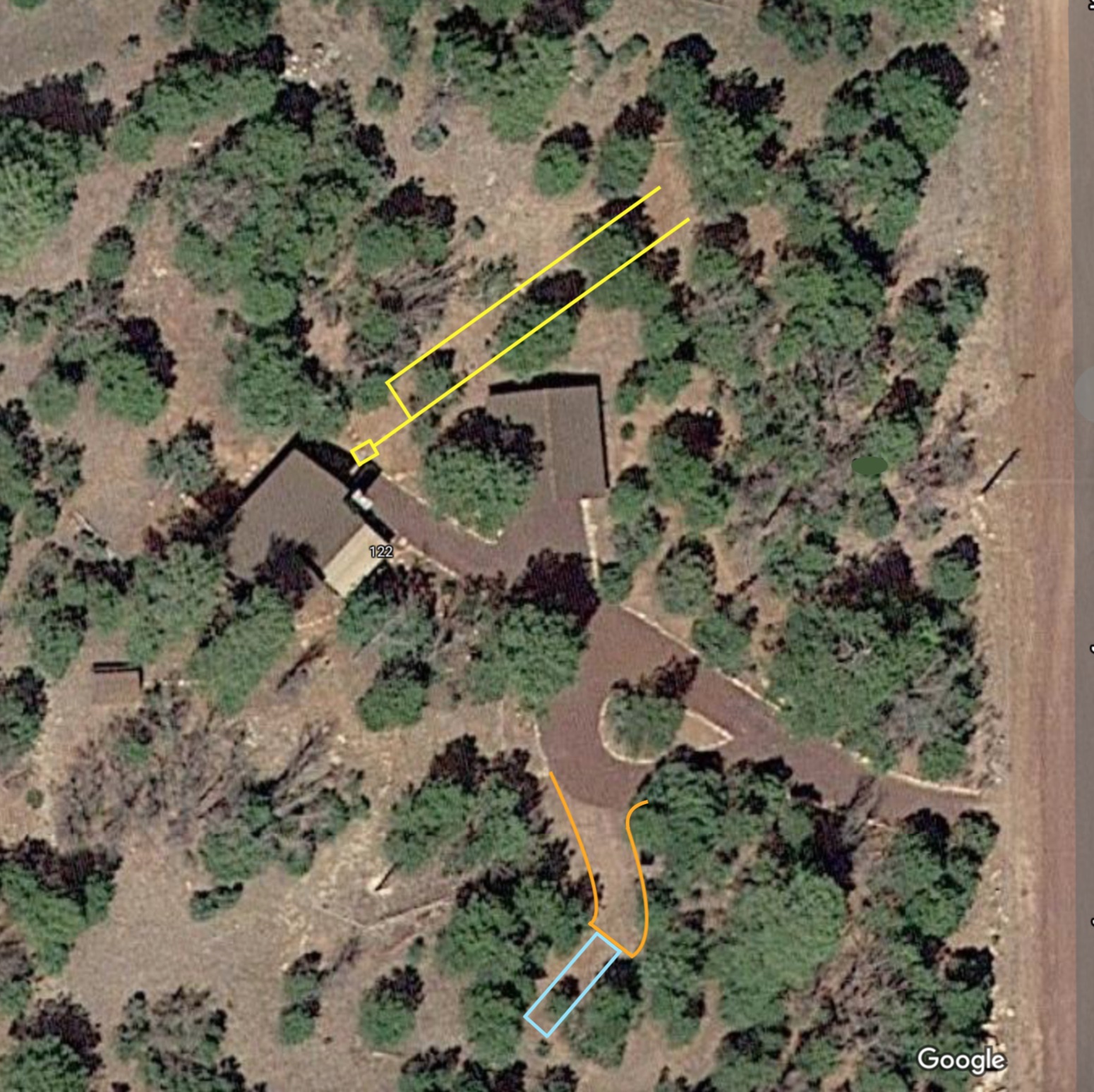

Pic below shows septic tank & leach lines/field. (in yellow) I have driven my F350 4wd crew (approx7700lbs) & dump trailer between the building & tank hundreds of times with no effect. I actually drive over the corner of the tank, but being concrete, I expect no problems. I have driven my B7100, (approx 2600lbs) my Rhino, (approx 1100lbs)& my golf cart (approx 1600lbs) over the leach fields hundreds of times, again with no effect.
Leach pipe is 4" PVC, drainage rock is 2-3" cinders, which lock together like concrete.
(Blue rectangle is new container location, orange is new driveway extension)
Google needs to update their satellite photos.
