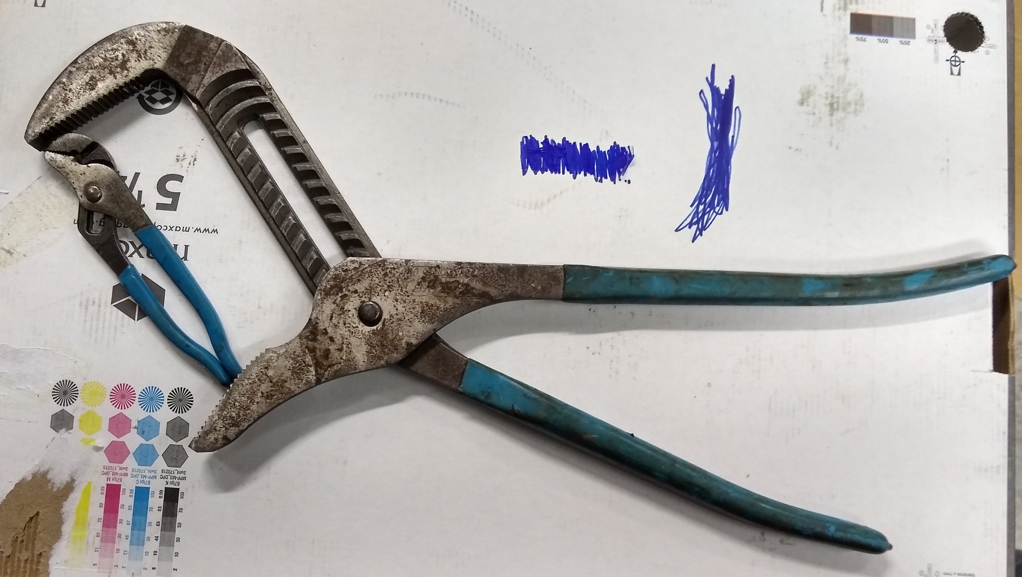

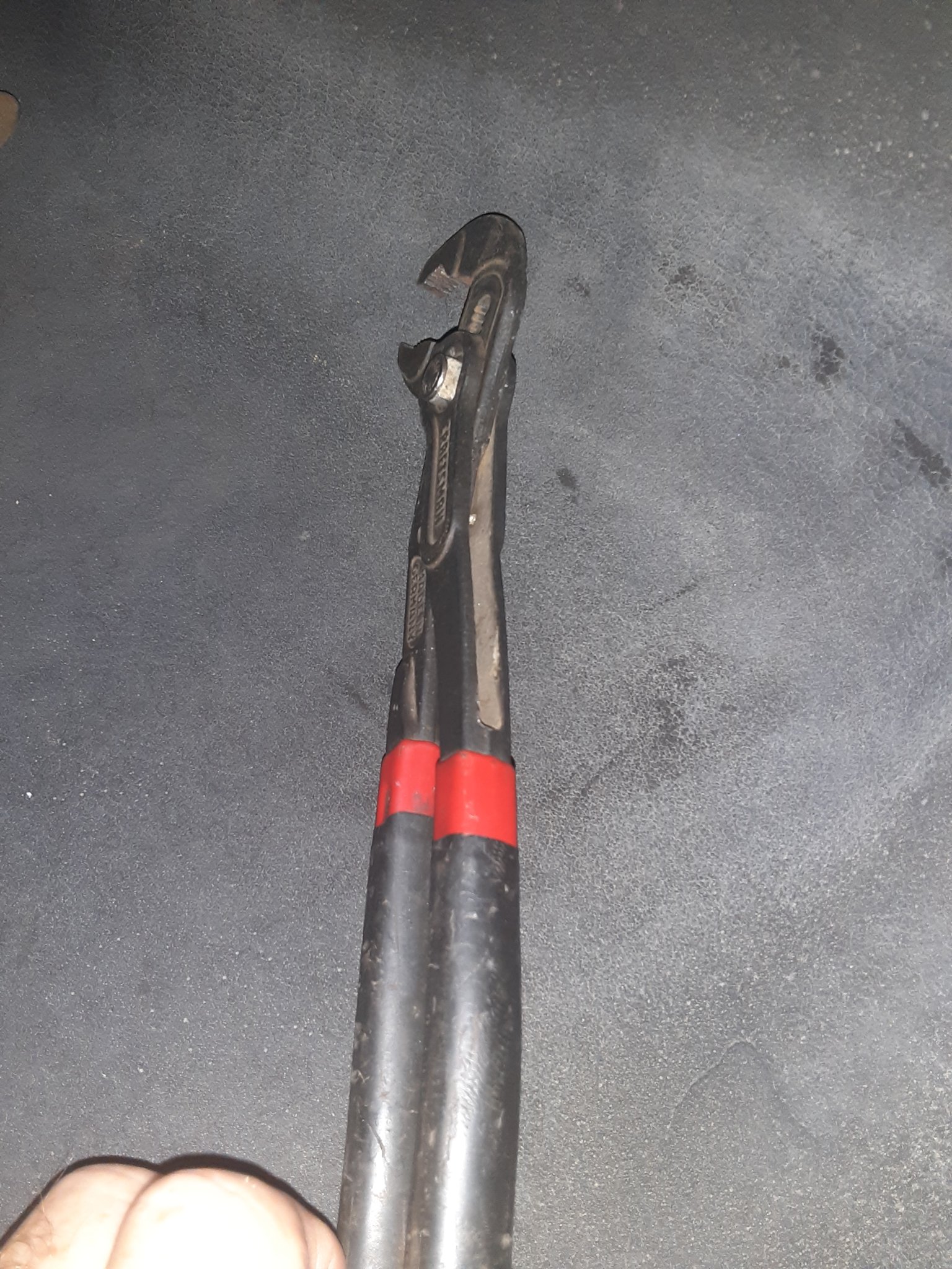

My go-to tools when there's a fight to be won. Either the Channellock 215 Filter Pliers that was on sale somewhere years ago or the Channellock BigAzz. George wanted to pose with them for size reference.
I have a pair of them bigazz ones, hanging by the vise of the shop so they are handy, plus a pair of their little brother about 10".
There is a pair that was germany made I bought many years ago that the one handle/jaw goes thru a gap in the other jaw with a push button adjustment that was real handy doing electrical work with emt and all kinds of box connectors.
They were 10 inch and craftsman had them too.

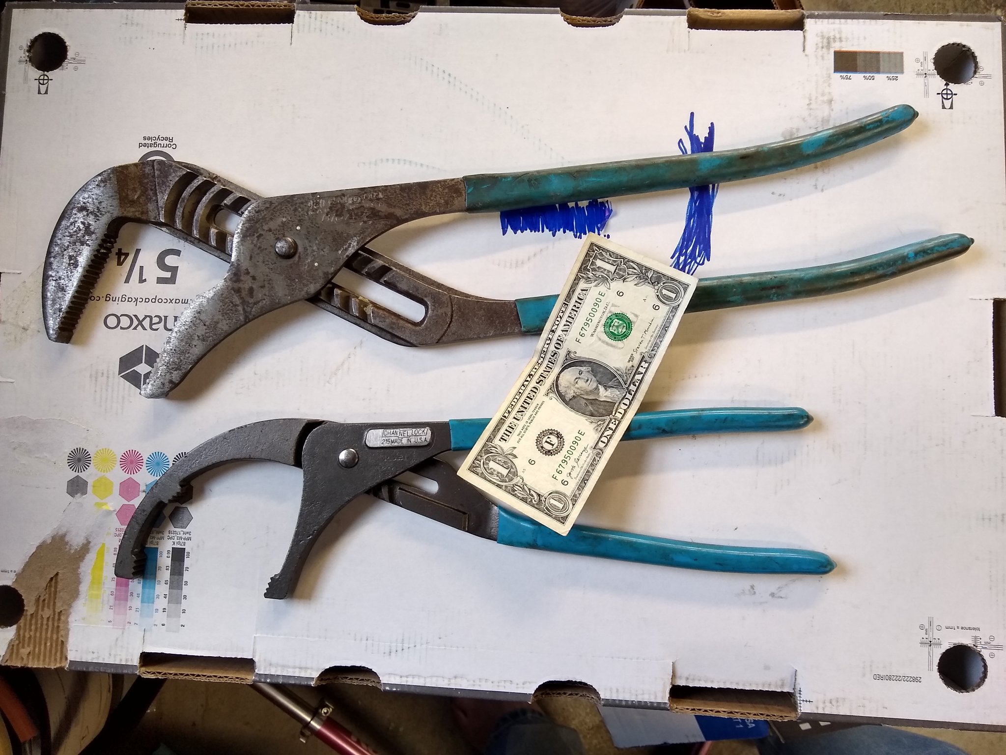

Here are both ends of the spectrum for me. They have a number of siblings in between. Out of all of them the little guy is so handy that I keep one in the garage and one in the truck.
