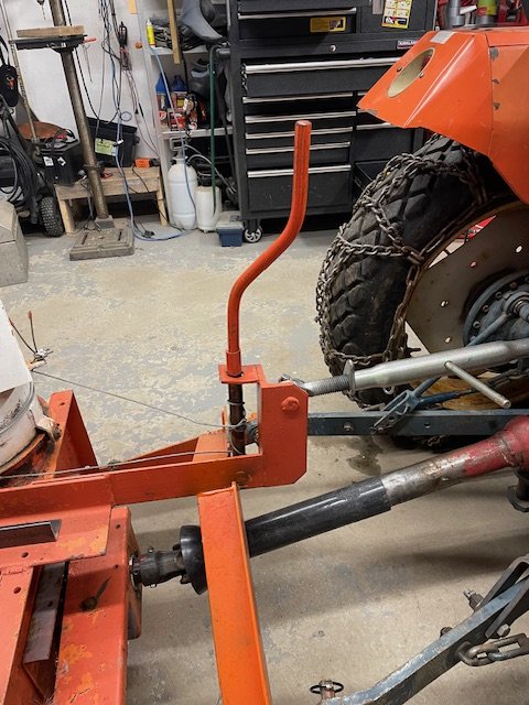

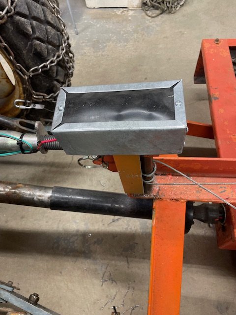

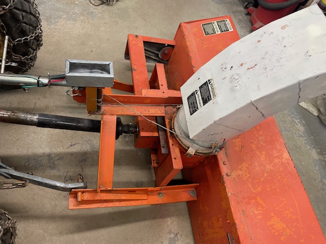

It's a old snowblower on a old Grey market tractor,when using it I would have to stop,raise the 3 point crank the chute than lower the unit and continue.I installed a 30RPM 12V reversing motor very similar to a power window motor,should be a better experience this winter.All in $65 CDN
