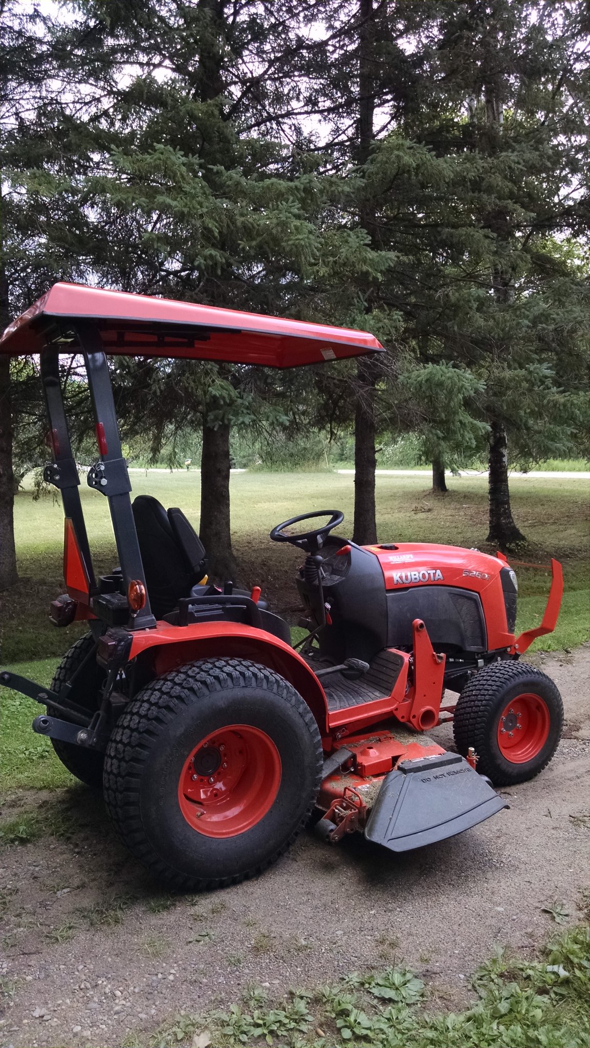

I have wheel spacers on my B2650, mainly so it would be more stable for snow blowing. BUT then I got a MMM from eipo who had spacers on his B2650. The tech who installed it had a terrible time and it is usable but it hangs up on the wheel, turf tires, if you lift the deck up too high. Can’t be locked in the up position. Eipo was able to use his but he had different rims. Bottom line it might be possible, but will require a lot of screwing around if you mow with it. If you can mow with the BX and chains are not needed should be possible. I think eipo even got chains on his.

I did have chains, and the reason I was able to add spacers and still use the MMM was because I had R4 rims. That wasn't intentional, I simply opted to swap the R4 tires with turfs.

I have factory spacers and turf tires and have been happily mowing with that deck for some time, but I don't have to lock it in the up position. It will hit the tires. Yours may or may not hit depending on your tires.
