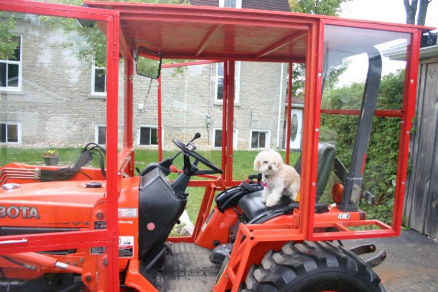

Please, Don't laugh on my cab~!!!
I never welding ever before, never worked with metal... I bought small Mig welder from auction ($70) but didn't work. so I had to fix it myself... and it works okay for now.;)
I'm going to finish a little more on this cab. and I'm going to take the snow
blade to welding guy to modify very soon~~~!
It is very cold here today. It might snow soon~:eek:
I know it is a bit strange looking cab but Please~ Don't laugh though~!
Do you think I need wiper too? Where could I get those?
Thank you.

Joe your cab looks great, if mine turns out anywhere near as nice as yours I will be more than proud. Now I am the one who is jealous. No one should laugh at that cab. You did an amazing job.:cool::cool: Verrry cool.

Not laughing at you at all.. Looks great IMO! Wish I had one for my tractor.. Looks like you may be smiling while others get snow in there face... Lucky you, Nice Job!!! :)
Thank you.
A wiper is a useful addition and I would go to the automotive junkyard and find a old cars wiper motor and adapt it to fit the tractor, one hint is a old 1970's GM vehicle with the separate switch and grab the switch with the motor and then simply wire it in.

For a wiper assembly, you can probably find a complete compact unit for little money at www.speedwaymotors.com. It's a common application for streetrodders.

Try Sims in Rutland, Mass. They make cabs and have accessories such as wipers and heaters. They have a web site as I recall.

I had a heck of time to building this cab...
All I have was wood working tools... not even enough... but I try to doing metal work was a big mistake.:cool:
Set the Mig welder weakest setting but still melting through the metal pipe and found square metal pipe was bent and bending more after welding.:eek:
try to welding on pipe with Plexi-glass on wasn't fun at all. I had to spray water to cool down to protecting Plexi-glass... and welding goes more harder... cause of the WATER~:mad:
I thank you all for kind reply~! I though everyone would laugh at me. 'cause I made too many mistakes on this cabin.:(

And one of picture shows left front tire, have a good look at there.
There is a pipe for the muffler extention...:p I found my air filter is so black. and I couldn't figure out in first place but now I know it was muffler problem.
'cause, very short muffler shoots out black smoke sometimes and radiator fan sucks in and air filter too. so I put a little extention and it solved problem for me.;)

nice job .... Keep the measurements and sell a few...
Just an idea for you.
next time maybe use plywood instead of plexiglass when welding it up...?
You can then maybe add tabs so you good change a window if you need too.
Its cool .....

You May want to Put a Fan in There Blowing on the Front Window, or In stall a Heater.
The Windows May Fog Up Really Bad in Winter without them.

That was brilliant idea for plywood and tab and so on~~~!
Dang~! Why didn't I think of that~~?!
Right now, it is almost impossible to change the glass and had a heck of time to install them......:cool:
This was my first time welding and so on in my life time (51 years young).
I have made cabin a few years ago on my old tractor. but it was 70 Hp tractor so I used 2x4 and 2x2 woods and Plexi-glass which was pretty easy job. but welding~?! OMG, I don't know how you guys do but it wasn't easy job at all. As you could see I've made so many mistakes...
and my old tractor that I build cab, never needed wiper and never fogging up on the windshield. Well~ I never had heater or fan though.
and I've drove 13 Kms yesterday for 1 hour and a half and raining hard.
but still didn't needed wiper yet. It runs down all by itself...:D
and didn't have any trouble for fogging up~:p
So new cabin I built... I'm going to wait and see.
and I don't know if I ever build cabin again or not, but I will keep in mind for your precious advice... Thank you.
