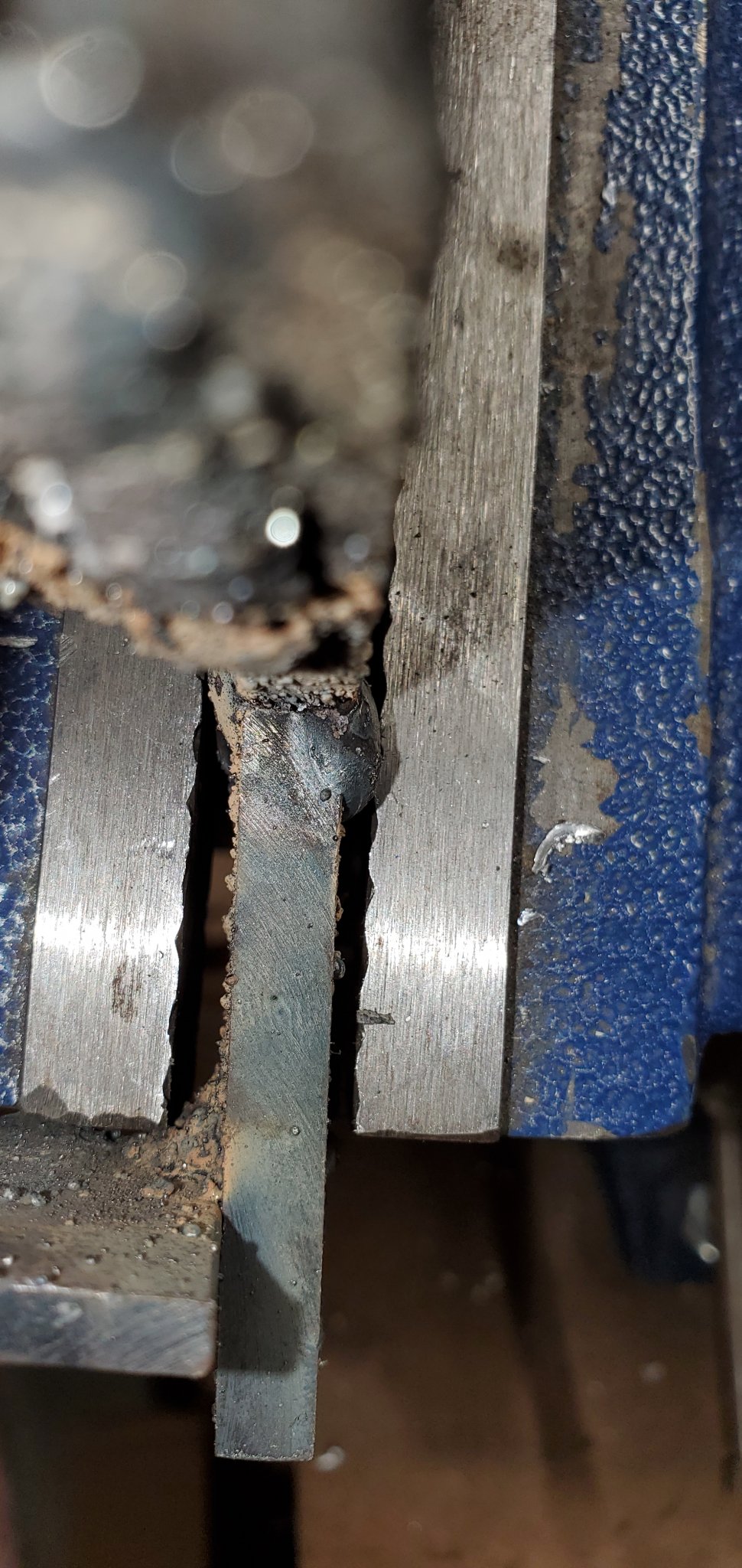

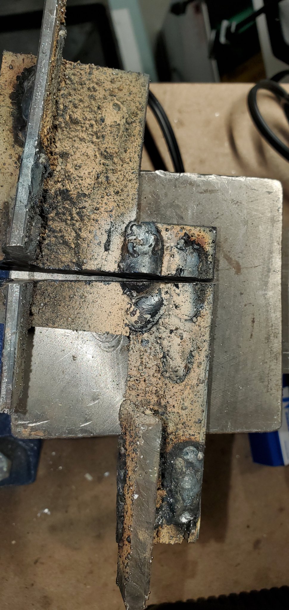

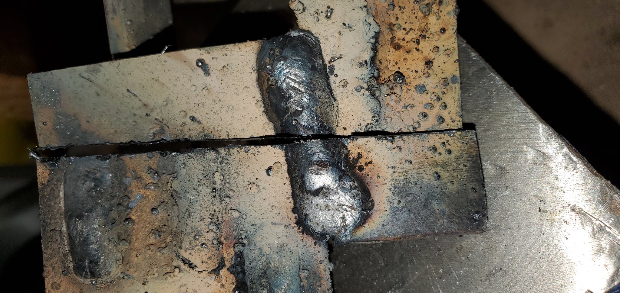

As requested - this is my initial review of the yeswelder mig-205ds (green) using 110v power using flux core wire (yeswelder E71TGS.030-inch flux core wire).
Background - very new self teaching welder, the only other welder I've used is a harbor freight 90a flux core (probably dozen years old). Take this review for what it is, the thoughts of a newbe who knows little to nothing about welding - your mileage my vary.
I had 2 left over scraps of 1/4" steel plate that I used for a project and previously used for test welder settings (HF welder has min/max setting and dial for wire feed so I used these to get settings dialed in for my welding style and were all spattered up). The test was the weld these two pieces together (butt weld) on both top and bottom then use my chop saw to cut through the middle of the weld to see how it looked. I used 110V and max thickness / voltage setting. Due to limitation of the welder, the wire setting was 0.035 (only option available for flux core). Keep in mind, 1/4" thickness is larger than the max thickness setting for 110V. Also note even though the top/bottom of the pieces look rough (spatter) the butt joint where I welded was nice clean, shiny metal.
These first 2 pictures are the 2 pieces I welded together and cut though, showing both sides of the butt weld - note one side has a better looking weld than the other and notice the spatter from the HF welder all over. the first picture has the worse weld of the two sides while the 2nd picture has the better looking weld.
these next 2 pictures show the inside of both sides of the welds that I cut though using the chop saw. Note there is a little "crack" in the middle where the 2 pieces didn't fuse together completely. Otherwise, it looks like decent penetration and fusion of the two pieces.
The next 2 pictures are of ends of the butt weld (start and stop of the weld) .
The first picture shows where I had better bead and the weld penetrated/fused better.
This picture shows the other end of the bead (finish) where I didn't get the bead close enough to the end of the pieces to complete the butt weld. You can see some penetration, though not as much as the above picture. Had I gotten the welder closer to end of the pieces, I think It would have had better penetration and look more like the above picture. This is just due to my lack of experience I think.
Final thoughts :

I would get it hooked up to the higher voltage and get the .035 flux wire. Your welds are ‘cold’ due to the lack of amperage. Spend the money and get it hooked up to gas with hard wire and start practicing with that. Much more forgiving and much more versatile. And always remember that a 4-1/2” grinder is a welder’s best friend. Grind the metal clean and try welding that. I guarantee you will see the difference. Good luck and keep us posted.

What makes you think the weld is cold? Trying to educate myself to become better.
I know i'm using smaller wire and larger metal than I should - it was all the scrap I had. It wasn't cleaned fully but the area where I welded was. picture 1 is a bad weld - all on me. picture 2 is a better looking weld - need more experience going end-to-end from start and finish the weld as illustrated with picture 5 and 6 (especially 6 - didn't fully weld the lenth of the pieces).
Pictures 3 and 4 show the middle of the weld and looks really good. I understand the center crack isn't good but I'm exceeding the capabilities of 110V with 0.030 wire on 1/4" plate and i expected some lack of penetration / fusion but was curious on the max capabilites of the welder using what I had on hand - 0.030 wire on 110v with the thickest scrap I had, 1/4".
I think with this setup, I'll able to do 3/16". I don't plan on welding anything over that until I go 240V.

Thanks for the report. Looks like the Yeswelder has higher output than my old Craftsman 110v flux welder.
One possible reason for the 'crack' in the middle - when welding from both sides a double v-groove is usually used. One side is welded, then the groove in the other side is ground out to remove slag to prevent it leaving inclusions in the second weld.
When welding at the limit of your machine, preheat. You probably noticed some difference as you approached the end of the weld. This is due to heat building up as you welded. Preheat, even with a propane torch, can help when you're at your machine's limit.

The crack across the weld bead in picture #2 pretty much confirms the cold weld. What you want to see is ‘feathering’ along the edge of the weld where the bead meets the base metal. Your weld speed looks very good. I think if you dropped down to .035 flux you will see the difference. Keep practicing!
Not sure I follow completely.
Pictures 1 and 2 are both taken after I cut across the bead to take a look at the inside (penetration/fusion). I should have taken pictures of the beads before cutting, but didn't think about it until after the fact - so I laid the already cut pieces close together to get a picture of the bead.
Pictures 3 and 4 show the inside of the bead on both pieces after cutting across the bead. The crack in both pictures is the joint between the 2 pieces and I suspected that would happen that since I was using 110v with 0.030 wire and exceeding the recommended thickness and didn't groove/bevel before welding.
Pictures 5 and 6 shows the start/end of the welds to show the penetration/fusion from that view point.
