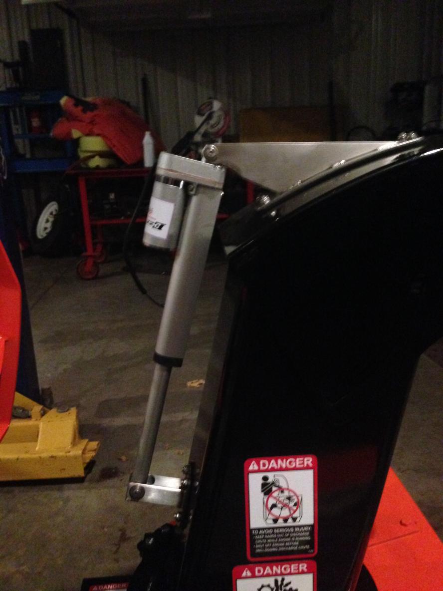

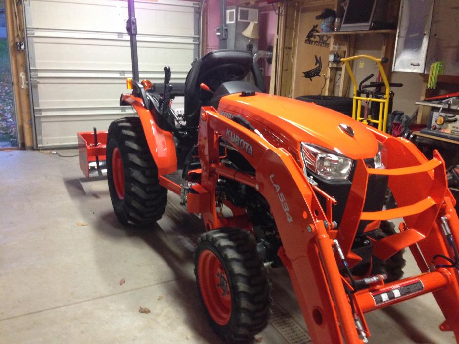

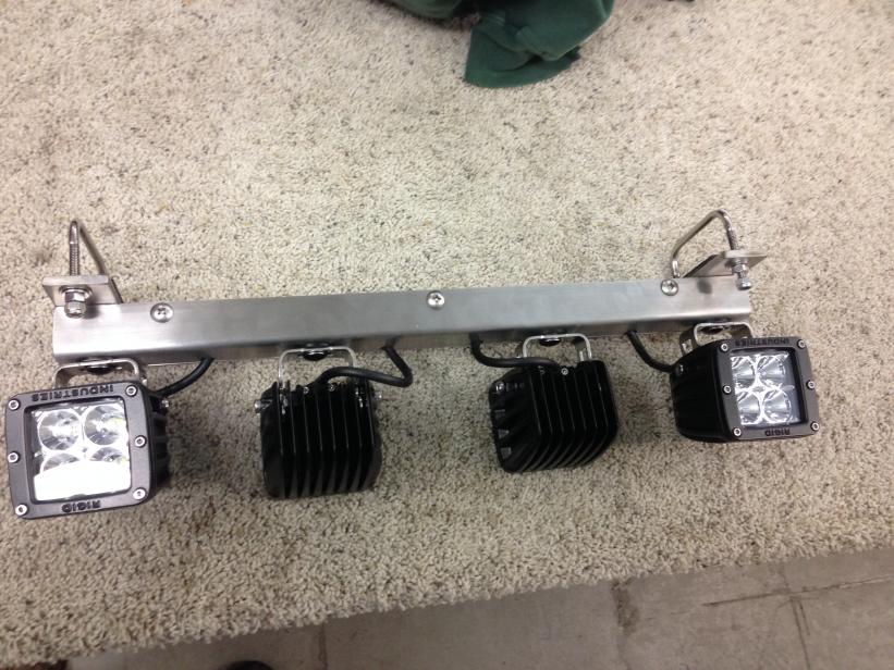

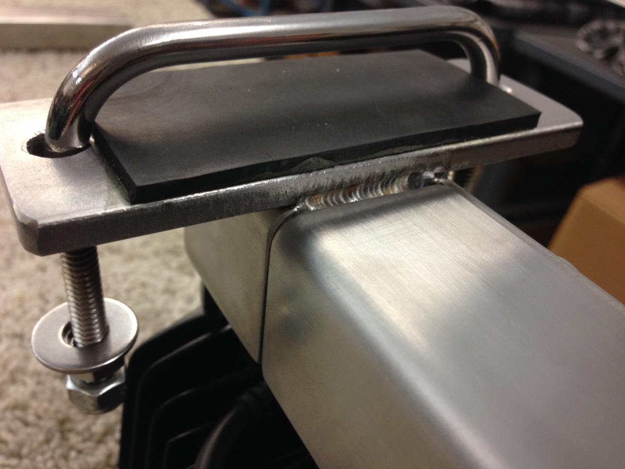

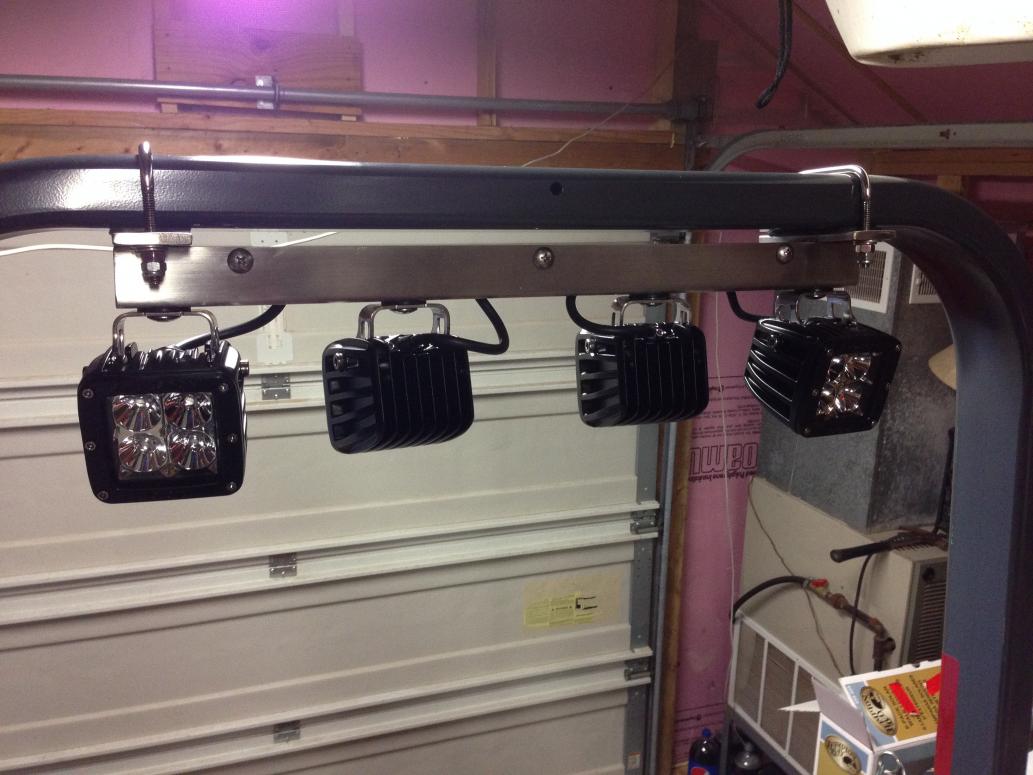

So I sold my BX2200, was a very faithful little guy, and bought a new B2650 and couldn't be happier! I've got a list of modifications I want to do in time. So far I added lights to the roll bar (Rigid D2), and a 12v actuator to the top chute of the blower. As you can tell I love using Stainless it welds so nice.

VERY nice looking machine. The B series (IMO) is the perfect size (and I own a BX)because it has the big boy tires and the modern bodywork, beautiful machine. Nice mods too, love the actuator. Any problems with it freezing up?

Very nice welds. How did you wire the lights? 2 switchs 1 front 1 back?. I want to build the same light bar for my BX but it wont be stainless.

Thanks for the compliments, I always take pride in my work. Only time will tell as far as freezing up goes. I doubt it as it goes back in a heated garage.

I used the factory 12 volt 120watt circuit under the rear fender, the led lights draw so little power, and yes one switch for the rear and one for the front mounted under 12v acc outlet was easier than running to dash and back.

What lights did you use and do you like them?
I need to do something similar but I need work lights and an amber flasher unit switched seperately

As stated in my post they are Rigid D2, like them I love them also made in the USA

Wow, nice lights but almost $300 per pair?
I'm looking for something not quite so nice.

Nope about 135.00 a pair on Amazon. The rigid D2 duallys are 300++ a pair. It's four LEDs vs six and different lense configurations. Rigid has a lifetime warranty and great reviews, played the game with cheap LEDs decided to give them a go.
