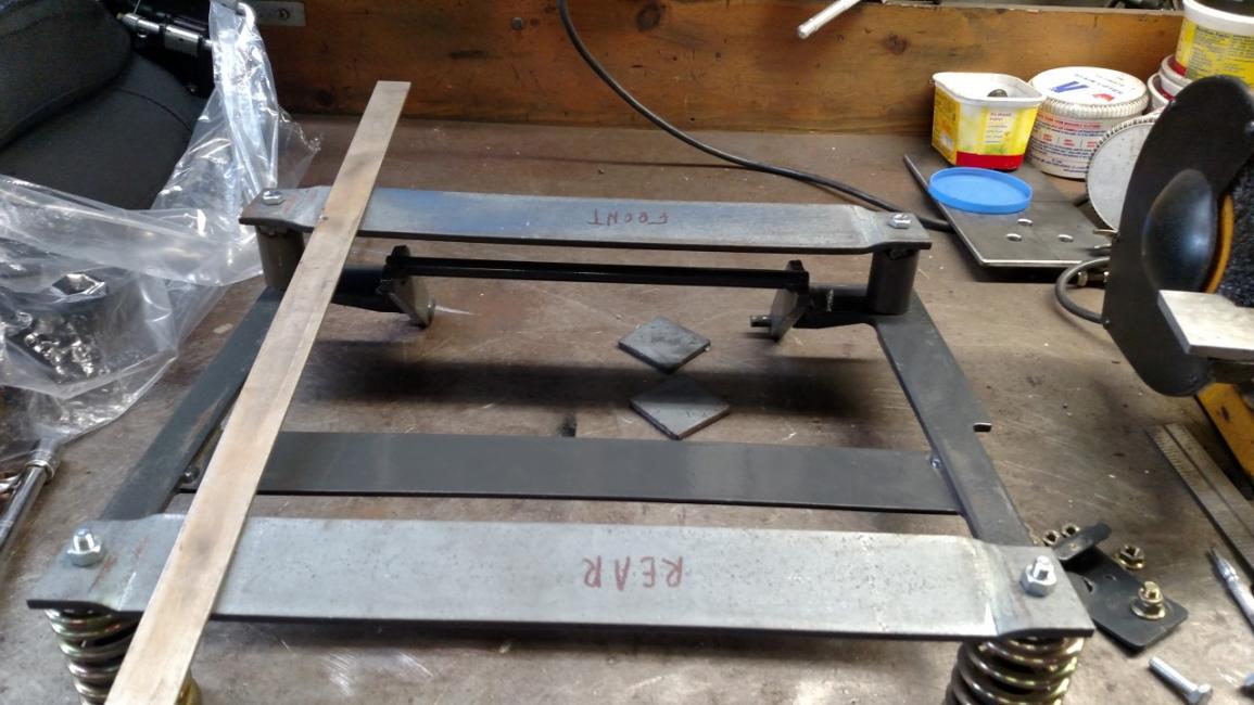

I cogitated on jut how to make an adapter and decided on using a couple of pieces of 17" long 2" wide 1/4" thick bar stock. By putting a twist on each end of the bars and putting a 2" tall spacer under the front mount to get a level mounting surface to mount the new seat tracks on, it would work out just fine.
By putting the bars in the vise 1" from the end, clamping pieces of 1/4" strap up 1/2" from there, I could heat the 1/2" gap red hot and twist it the proper amount, or at least fairly close.

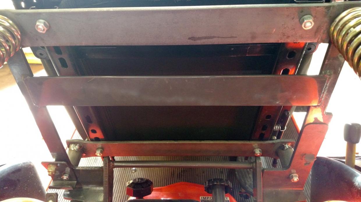

That done and the bars cooled down, I drilled holes to match the spacing on the original mount, cut a couple pieces of spacer stock for the front mount and welded them fast. I had to do a little fine tuning with a 4 lb hammer to get the twists just right, but they came out really close to parallel. I measured the mounting pattern on the new seat, transferred it to the new mounts and drilled the holes.

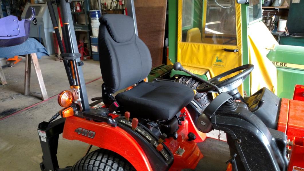

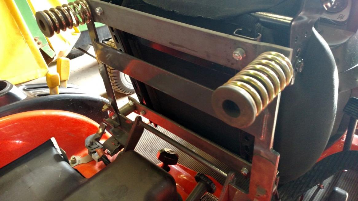

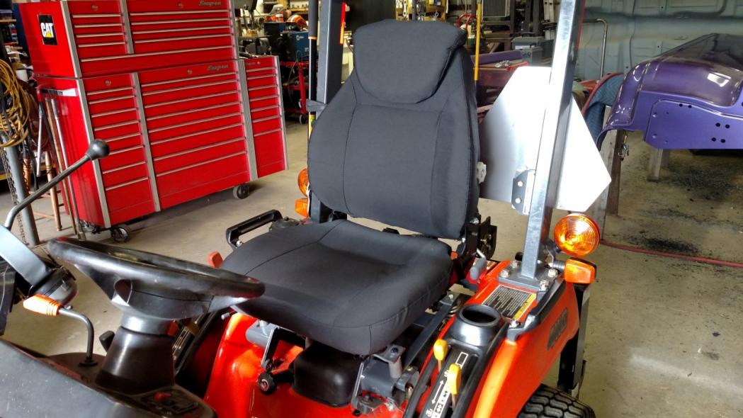

I had to take the tracks loose from the seats to get it all aligned and then tightened everything up. The adjuster worked back and forth just fine, so I was happy with that. I lugged the seat assembly over to the tractor and slipped the pivot pins into the mounting tabs and put the retainer pin in so it stayed in place.I flipped it back into normal pisition and it fit just fine and looked really good. Hopped up for a test sit, and it felt really good and way more comfortable.
I put the arm rests and covers on and it looks like mission accomplished.

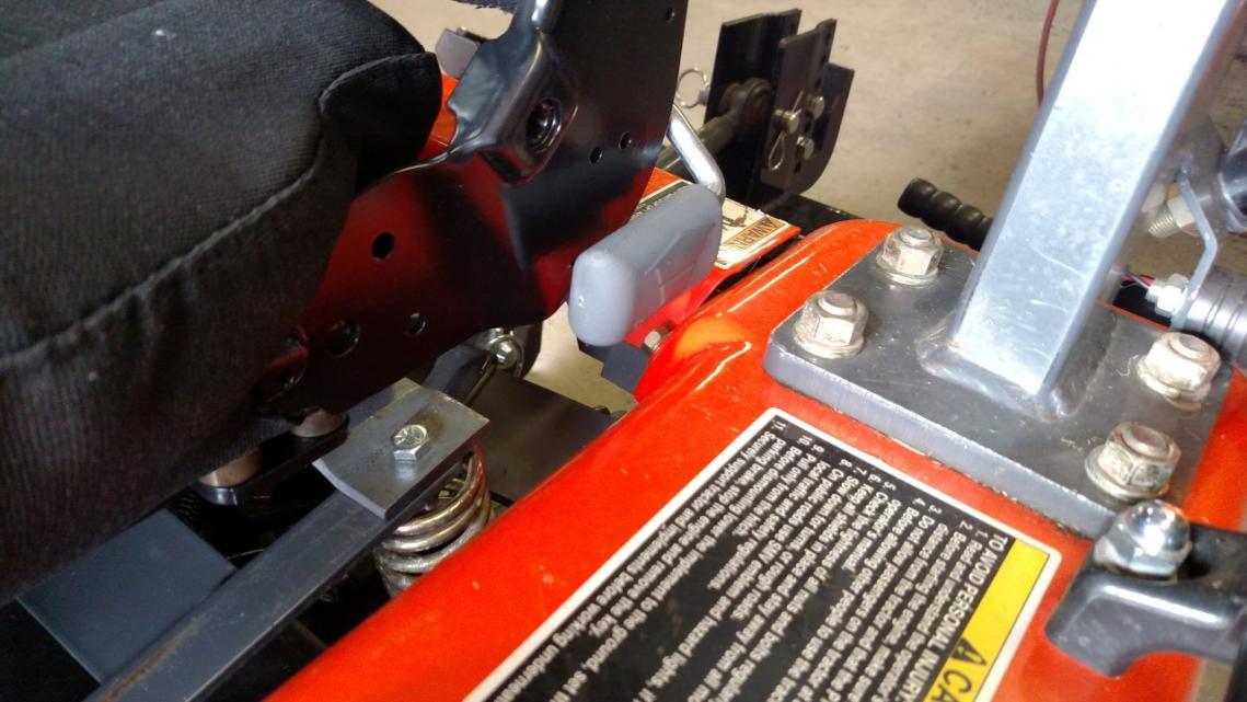

The only interference problem I have, is the handle for adjusting the seat back angle hits the inside of the left fender when you bounce in the seat. I think my solution is going to be to take the cutoff tool and cut off the portion that interferes leaving a short lever that can still be used if the back needs adjusting.
