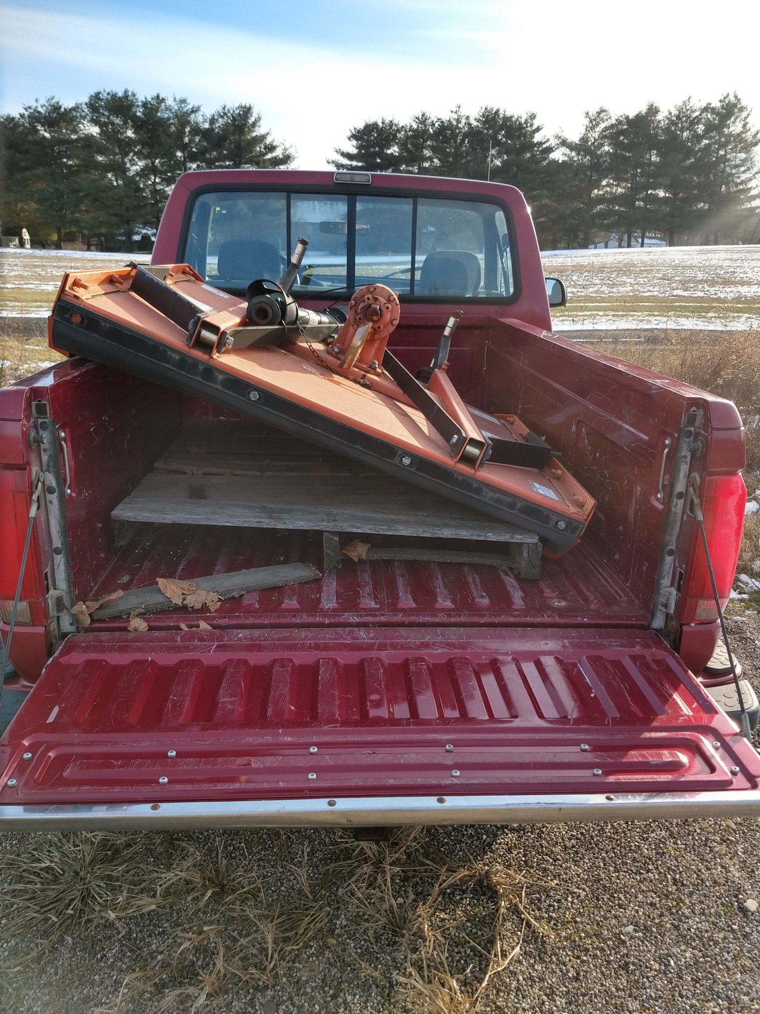

Hey guys,

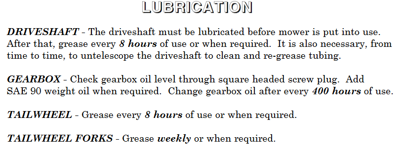

Got a King Kutter XB rotary cutter at our local stock and field that is going out of business. By the looks of it, it has been there for quite while so I got a pretty good deal on it. I have a Kubota BX2200 that I plan on using it with. So in light of the fact it has sat so long I want to flush the gearbox and grease everything back up this spring. Is there anything else I should do outside of what is mentioned in the manual?
I also posted some pictures of it as well so you can see it's wear from sitting for a few years.
IMG_20210123_155735023_HDR.jpg IMG_20210123_155754687_HDR.jpg IMG_20210123_155805180_HDR.jpg IMG_20210123_155812679_HDR.jpg
SidecarFlip
Banned
7,197
546
Unless the gearbox shows any signs of leakage it should be just fine, just check the fluid lever and top off with 90 weight gear oil and and grease all the grease fittings everywhere else paying close attention to the PTO shaft universals and the sliding halves. Nothing much to service on a chopper.
