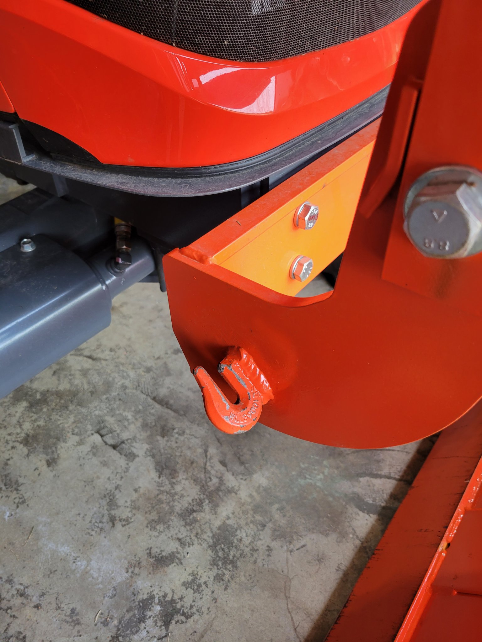

If you end up transporting the tractor often look into welding the hooks on the front as pictured as this will make securing the tractor much easier.
