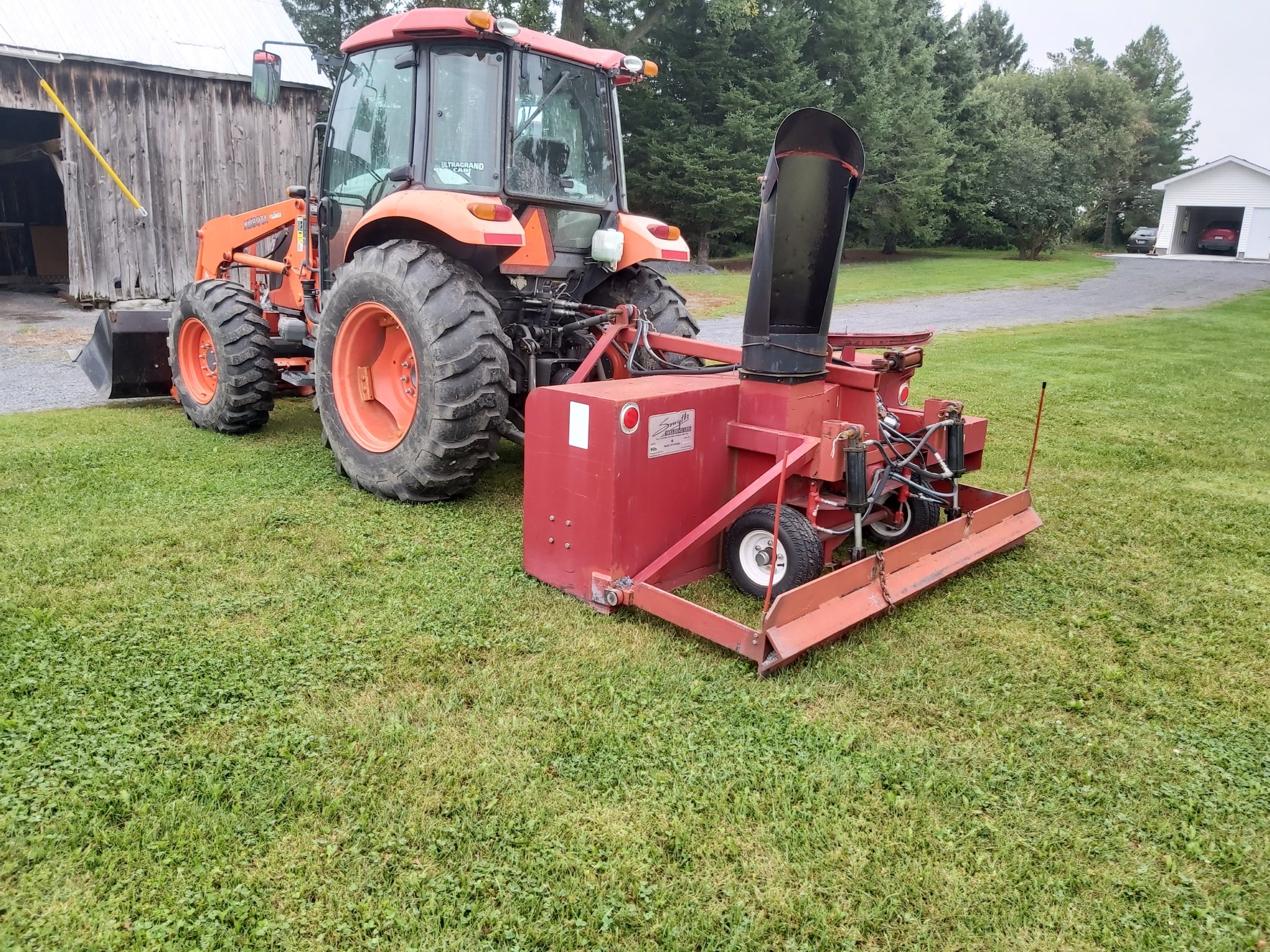

Get a M7040 with a cab. It changes things completely not being in the sun and having heat when blowing snow. I have a pull type snow blower and find it is much easier on my old body.
Hydraulic shuttle and additional rear remotes above the oem two.
The factory loader is well integrated into the machine. I think the number is LA 1153.
Tires are a personal preference. Ag tires will tear up a lawn when mowing.
The gauge wheels on rear blade are my own idea. With the rear blade you back up to a garage door and drop the blower, the blade pulls all the snow forward into a pile. You then raise the blade and back up and blow the accumulated pile away so there is no shovelling.
The gauge wheels help when blowing non frozen surfaces covered with snow. The blade and the wheels share a hydraulic circuit.
