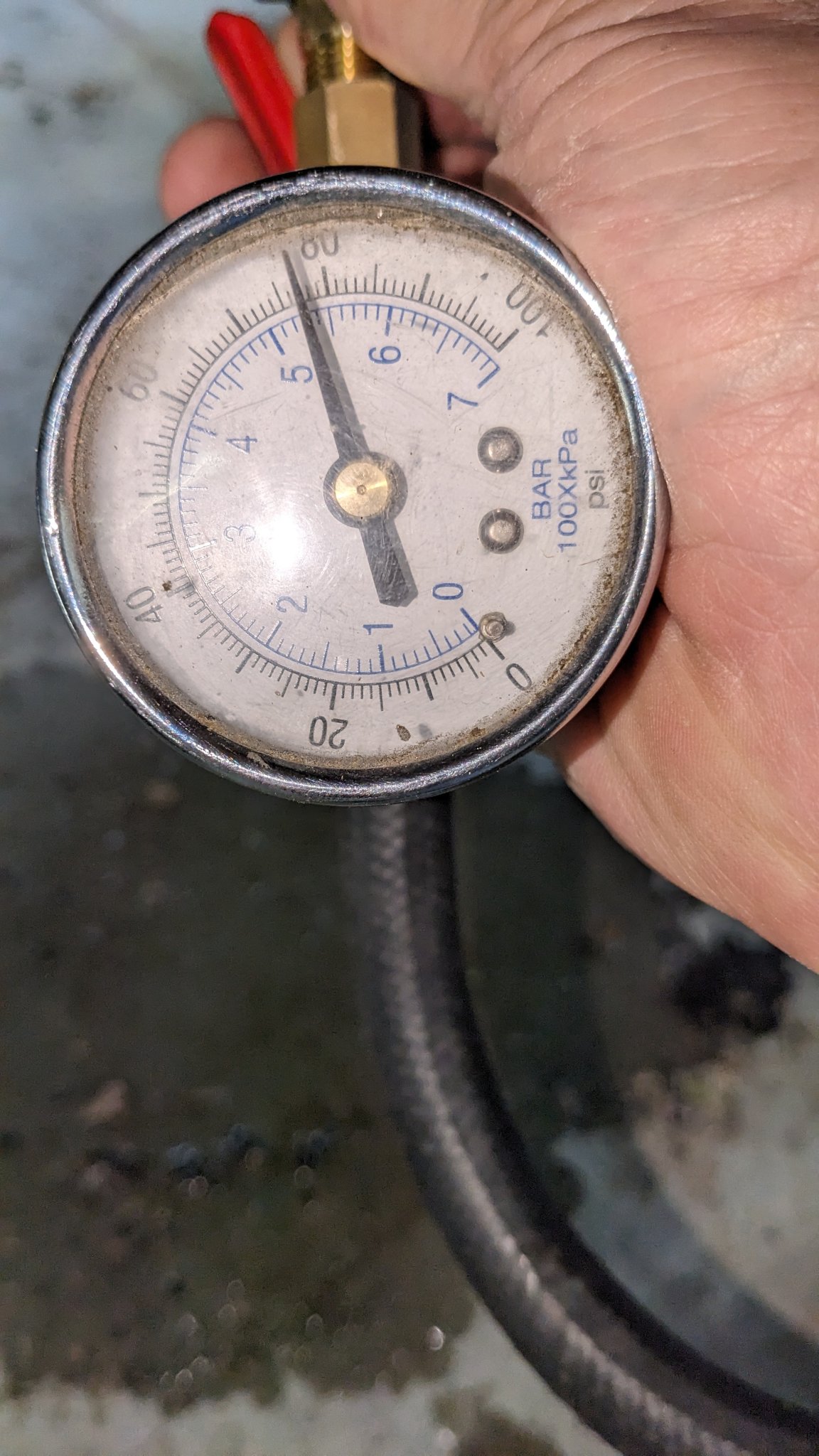

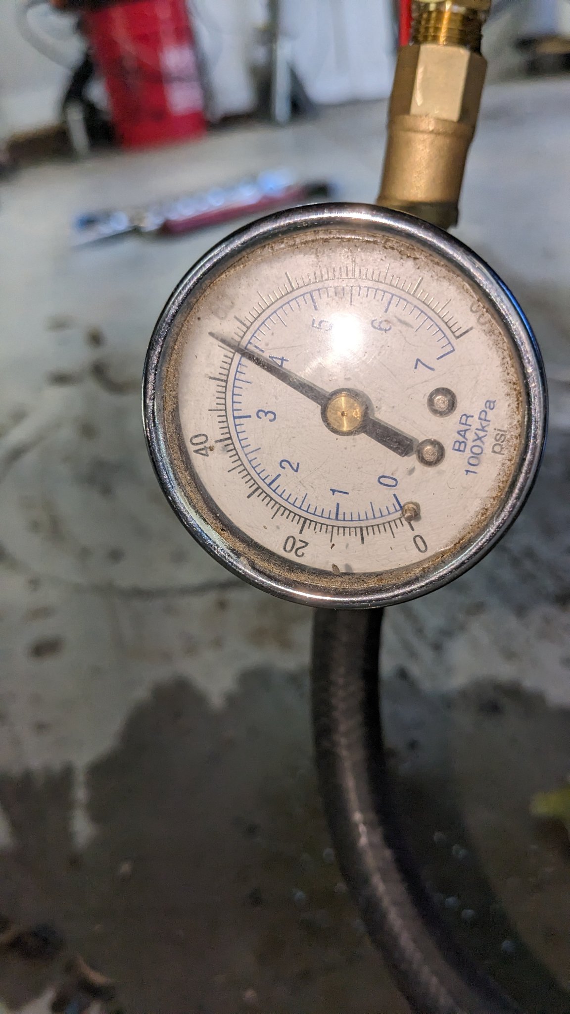

Ok - I scrounged through my fittings and came up with a setup that I could insert into the line with a 1/4" ball valve that could introduce a restriction.
When I started the tractor, the pressure went up to about 56 psi right off.
I started to close the valve slightly and it smoothly increased to about 77 psi. I did not leave the restriction in long. You can see the lever of the ball valve just slightly closed. This is between the hydraulic cooler and the filter. I'll move it to the other side of the filter next chance I have to work on it. Out of time for today.

Well you have flow. I was hoping it was going to be an easy fix with that relief but you checked that already. . Fingers crossed the filter is the culprit.
