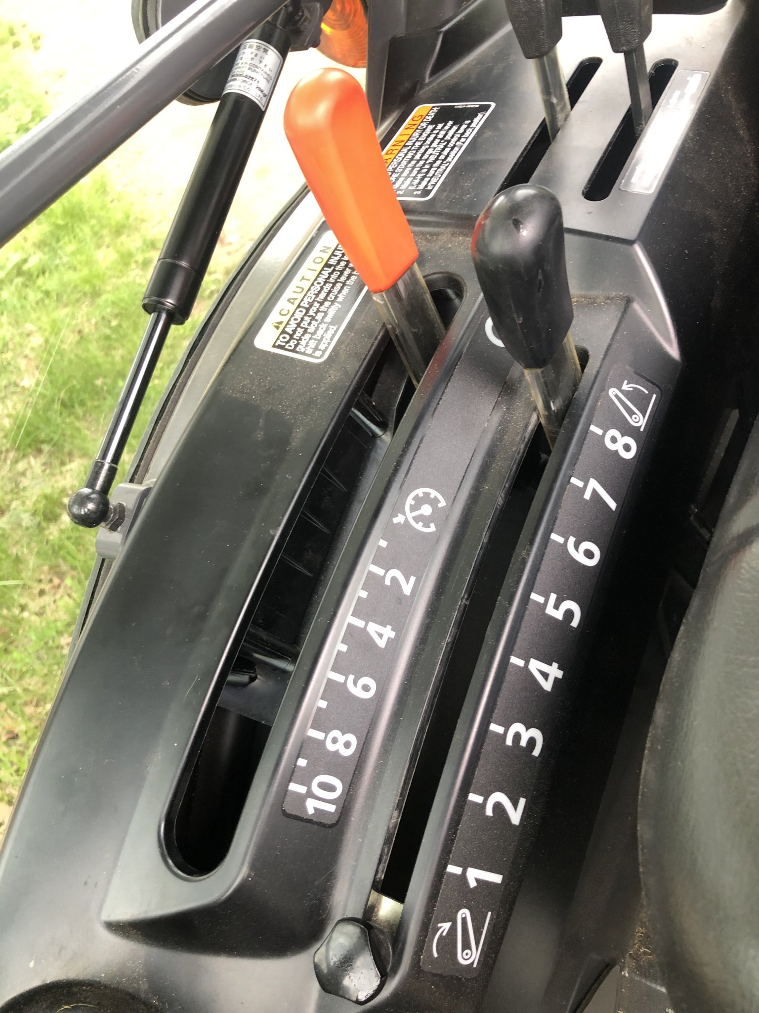

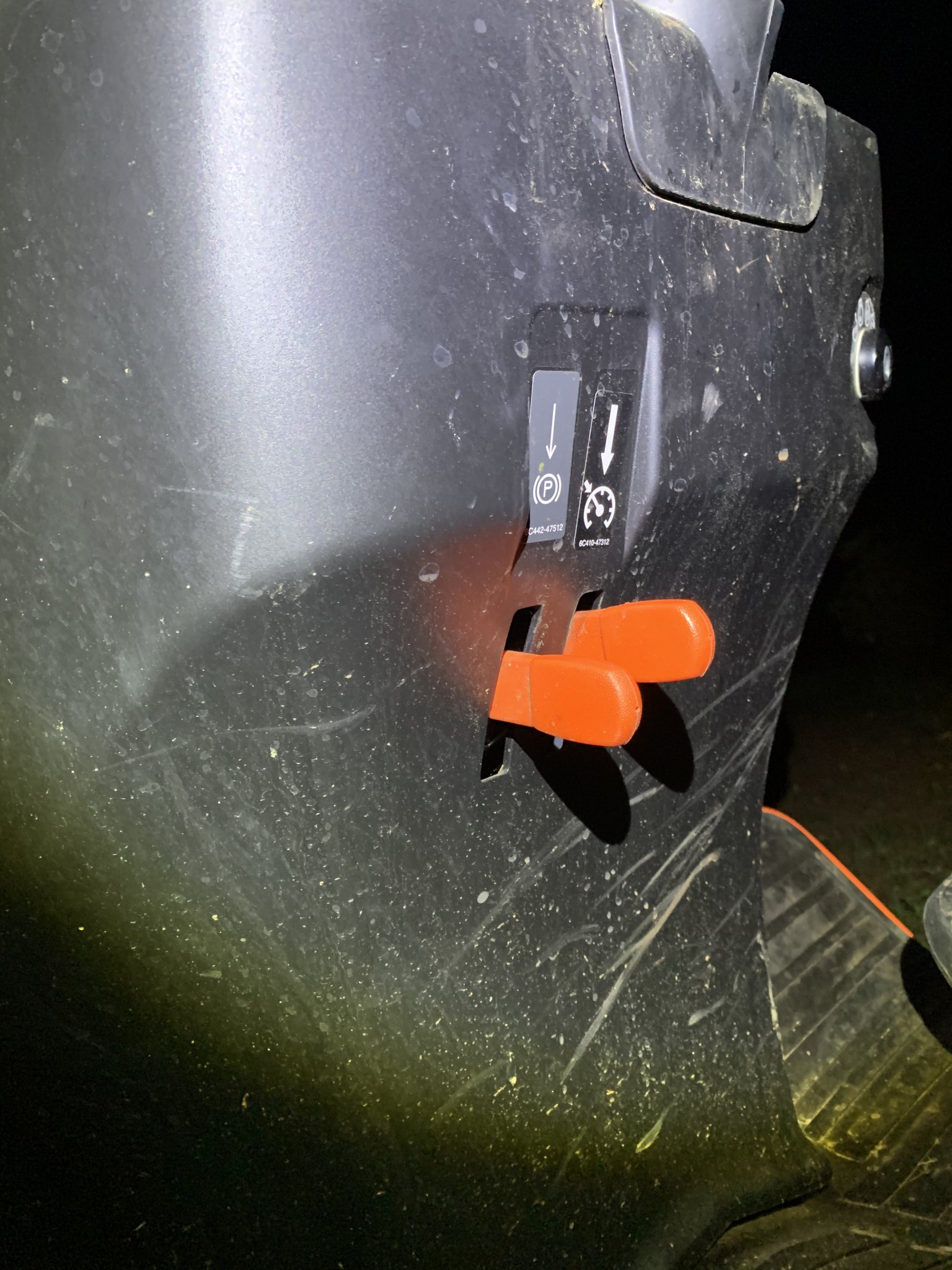

I'm new to the forum and to Kubota. I purchased a LX2610SU from my local dealer. I saw it had an option to add cruise control and opted for it to save my leg on long days of bush hogging my field vs standing on HST pedal. When my tractor was finally delivered they told me they had to remove the Parking brake lever to install the cruise control lever. I thought that was very odd since there is obviously an empty place right next to it for the cruise control that is standard on the non "SU" model. Does this sound correct? So I have no parking break on a brand new tractor and I see this as a major safety concern as I have already had issue with it rolling. For the time being I just bury the bucket when I park it.

Take a pic!! I have a cab and the parking brake lever is above the pedals. So the SU’s have the lever on the right side of the seat?

It is to the left below the steering Wheel. You can see the slot next to it for the non SU model cruise control.

That makes no sense. Both of mine are located right there on the left side like in your pic above. B2650 here.

That is exactly what I expected, but not what I got. The lever for cruise control works, but it illuminates the parking break light on the screen. I feel like someone missed something when installing it.

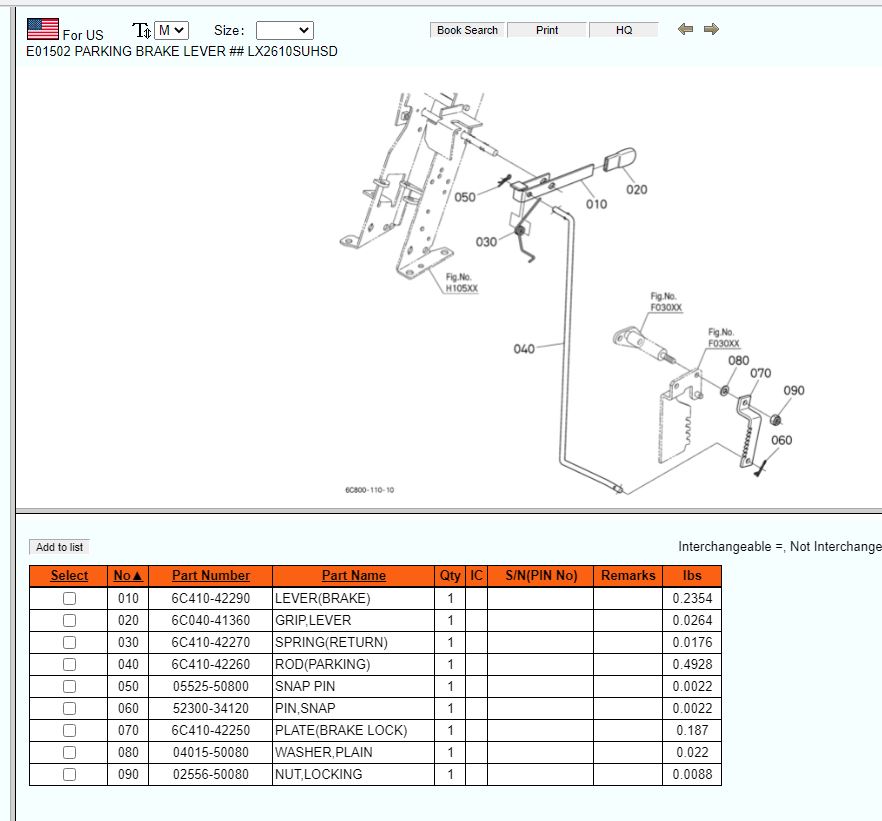

Hello Dusty,
The question is, "Does that sound correct?" The answer is "No!". I had to re-read your post to see if I had misread it. I would go back to the dealer and ask them what they were thinking of when they did it. Removing an important safety feature for any reason does not make sense. As an example, how are you supposed to safely use a PTO driven wood chipper without a parking brake? The instructions in your operator's manual probably refer to the parking brake that you don't have. For what it is worth, I have attached the parts breakout for the parking brake you should have.
Let us know how you make out with this issue. I am curious to hear what kind of "yeah, yeah, that's my story and I am sticking to it" answer you get.
Good luck with this issue.

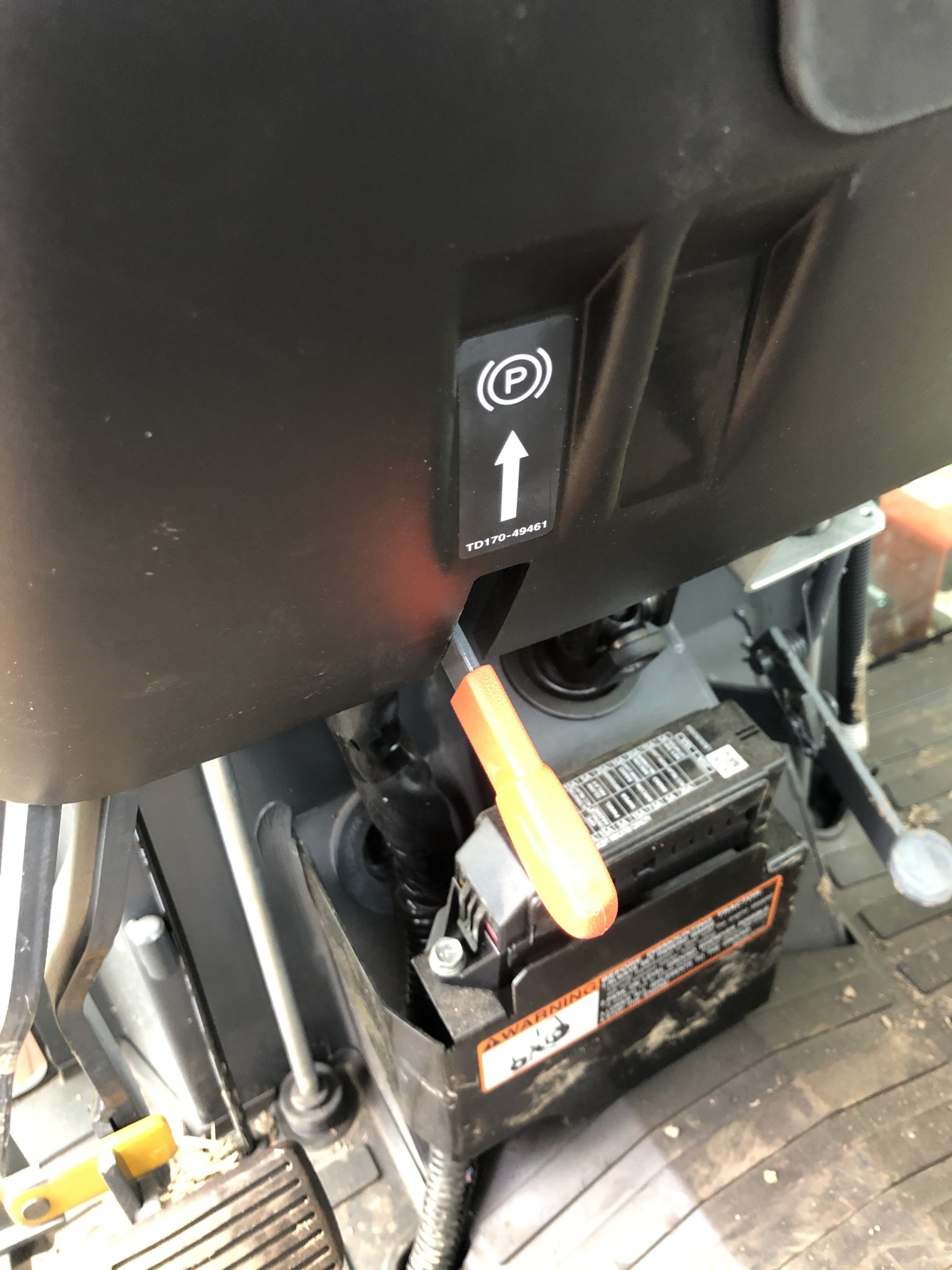

I have a cab model. The parking break looks like it might have a cutout for something else. But my cruise control is on the control panel to the right of the seat

My 4wd is below the seat.
I never would have guessed the controls were so different between the SU and standard models.

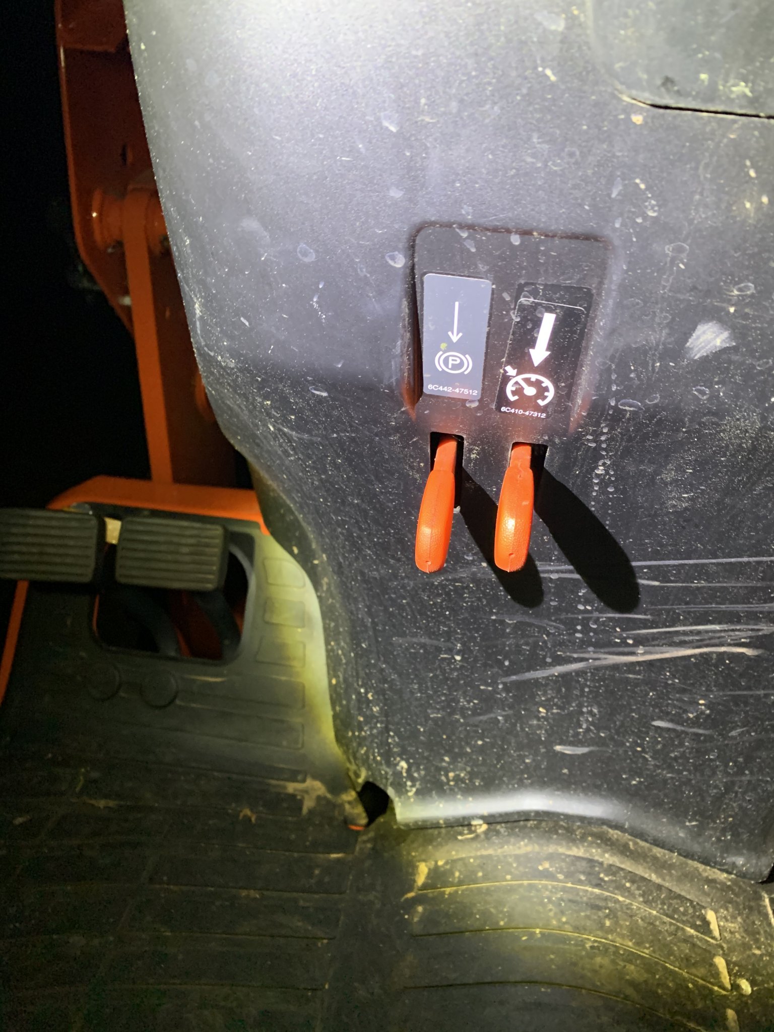

Here is a pic of my B2650 ROPS (just about the exact same tractor)

I have an LX2610SU with cruise and it’s set up just like 19thSF’s pic shows. Parking brake on left and cruise on right.
They seriously just left your parking brake off?!
edit to add pics:

Yes sir they did. I just have the lever on the left and it operates the cruise control.
