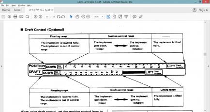

Does your tractor have a draft control?
While this manual is a couple of series older, it may assist you with playing with the controls. http://www.kubotabooks.com/AutoIndex/index.php?dir=Tractor%20Owners%20Manuals/&file=L235-L275%20Ops.pdf
Picture quality degraded on save, have a squizz in the manual
Not sure if anything else in the manual will correlate?
I suppose I do have draft control. It has the 2 levers like that. The labels are so weathered I wasn't sure what the second one did, now I know.
As far as the knob under the seat goes, the only way the hydros lift is if the knob is turned all the way to 'fast'. Turning it towards the slow way (clockwise) the 3 pt will drop but not lift. it would be nice if it dropped slower because of what we will be using it for, lifting and dropping will be happening frequently (dodging stumps in the woods), but if we cant lift it quickly that may become an issue.

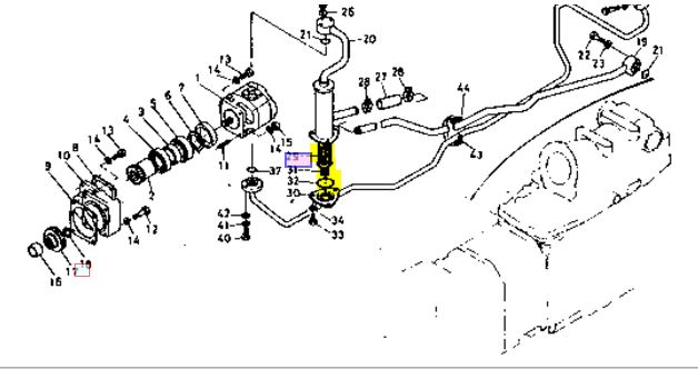

As far as the filter location, am I in the right ballpark with the cover at the lower rear in front of the diff? Is this the only hydro filter on this model?
6,360
2,012
My L185 has the filter screen in the location you state and it is the only one. You should be able to look at Kubota.com illustrated parts list online to find part numbers. The one for my tractor is still available so I imagine yours is also. They are just hollow screens with a partial ends

Your tractor does not have a filter on the left side . It should have a filter close to the hydraulic pump on the right side. It's a cleanable screen. It has a cap on it you remove and a spring and the filter should drop out. Be sure your filter has a rubber gasket on the top were it sets in the housing. It sounds like you are using the draft control and not the position control to raise and lower. That is why you don't have good control. Also check the rod that comes from the top link bracket to be sure it is not bent or broken.

Your filter issue is easy, but not cheap, that is if the filter is still available.
Filter $75.01
37300-37710
Spring $1.64
37300-37740
O-ring $1.51
04811-50600

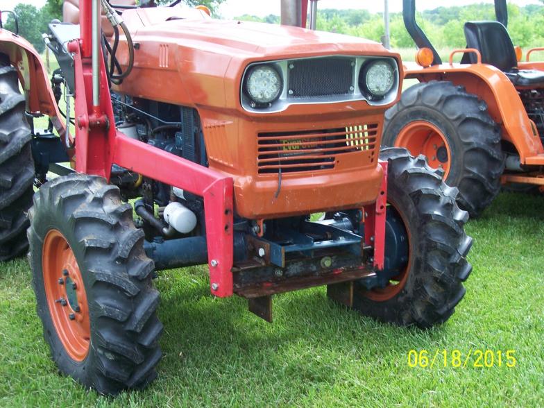

BigP623, if you need the filter, and don't want to spend the $75 North Idaho Wolfman indicated, I think I have one setting around here somewhere that I removed from an L305. I cut the entire housing out and replaced with a screw on hyd. filter.
If interested, send me a PM and I look for you.
Here's how I did mine. The whole thing, including filter was like $30.

I was looking for something with a slow sweep, not a sharp bend. I will have to look, but I think that is stainless steel. I went to my local scrapper who has a huge pile of SS, and just went snooping. Found a piece with 1" IPS (I think) with the bend, cut it to suit, chamfered the edge and slid it into the hose.
If that's what you're needing I will look in my "bone pile" and see what I can come up with!! I think everything else came from Surplus Center, Omaha.
