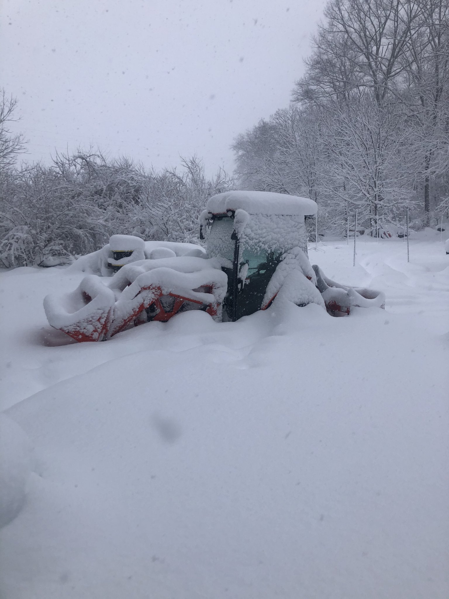

I have an LX2610 with R14 tires. I have done about 40 tons of gravel, used it on multiple properties for 30” of snowfall, and also box blading some very muddy and messy ground. And I’ve driven over grass and haven’t torn up the turf
They have performed great in every scenario I’ve had them in. I would gladly buy them again.
I would definitely get them loaded though.

They wouldn’t change my opinion of the tires. They seem to have great traction in muddy and messy ground. I don’t think they would have a problem pulling a plow. I’ve pulled my 60” box blade with all of the ripper shanks lowered and the tires didn’t lose traction at all.
Even though you won’t be using it in snow, it kept traction in the snow while I was using the loader to pick up and dump tons of snow for me, they haven’t made me question my decision at all. They haven’t lost traction with all the things I’ve thrown at them so far
