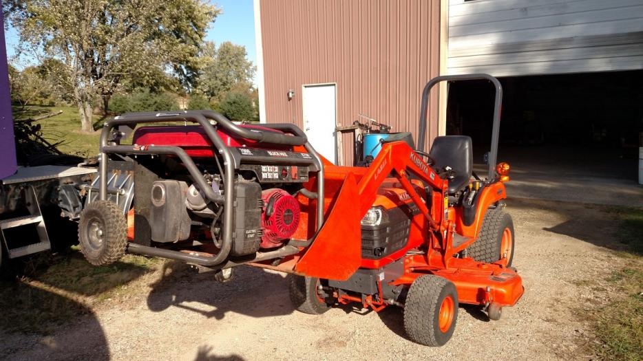

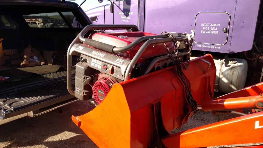

Coincidentally I just lifted a generator with my BX23 a couple months ago, probably around that weight, maybe slightly lighter. If I remember right I had a rope tied to the cross support behind the bucket and it draped down in front of the bucket. Had to put some protection in between the bucket cutting edge and the rope. Worked fine.
That said, I'd just tie/strap/chain to the forks if I had them.

I use ratchet straps around the bucket to lift a variety of things. I've lifted engines, logs, railroad ties, fuel tanks, and other stuff. I put one strap on each side between boom and curl cylinder. More straps if balance is an issue.
